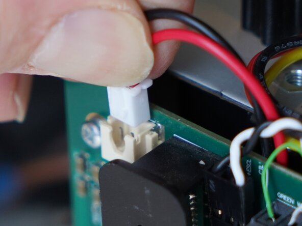

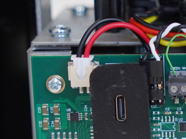

  6. Kaffelogic Nano 7/LINK (C-N Serial) USB Daughterboard Replacement, Disconnect the SSR signal: Schritt 6, Bild 1 von 2 Kaffelogic Nano 7/LINK (C-N Serial) USB Daughterboard Replacement, Disconnect the SSR signal: Schritt 6, Bild 2 von 2
    • Pull upwards on the SSR signal connector to remove it.

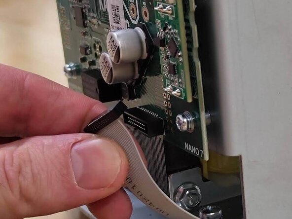

  8. Kaffelogic Nano 7/LINK (C-N Serial) USB Daughterboard Replacement, Disconnect the ribbon cable: Schritt 8, Bild 1 von 1
    • Carefully pull on the ribbon cable to remove it.

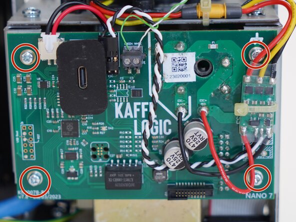

  9. Kaffelogic Nano 7/LINK (C-N Serial) USB Daughterboard Replacement, Remove PCB screws: Schritt 9, Bild 1 von 1
    • Remove the 4x PH2 PCB screws.

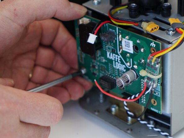

  10. Kaffelogic Nano 7/LINK (C-N Serial) USB Daughterboard Replacement, Pull the board: Schritt 10, Bild 1 von 1
    • Pull the board away from the chassis carefully, taking care with any wires still attached. We need to get to the back of the board.

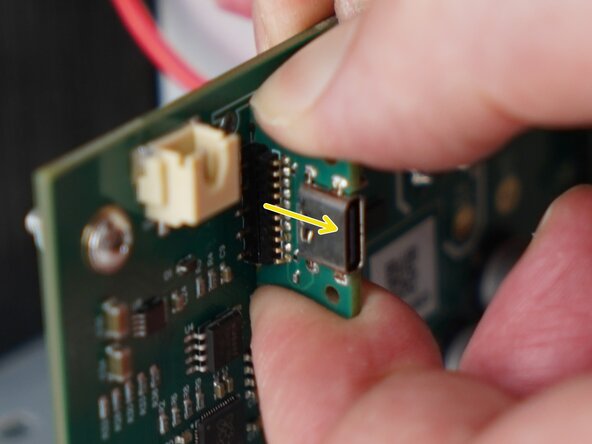

  13. Kaffelogic Nano 7/LINK (C-N Serial) USB Daughterboard Replacement, Remove the daughterboard: Schritt 13, Bild 1 von 2 Kaffelogic Nano 7/LINK (C-N Serial) USB Daughterboard Replacement, Remove the daughterboard: Schritt 13, Bild 2 von 2
    • Pull away on the daughterboard to remove it from the main PCB.
