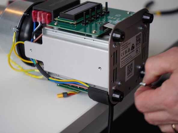

  4. Kaffelogic Nano 7/LINK (D-P Serial) Power Cable Replacement, Removing the rear panel: Schritt 4, Bild 1 von 3 Kaffelogic Nano 7/LINK (D-P Serial) Power Cable Replacement, Removing the rear panel: Schritt 4, Bild 2 von 3 Kaffelogic Nano 7/LINK (D-P Serial) Power Cable Replacement, Removing the rear panel: Schritt 4, Bild 3 von 3
    • Remove the last 2.5mm Hex screw securing the rear panel.
    • Pull up on the rear panel to remove it from the roaster.

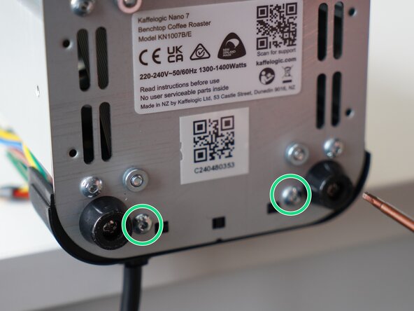

  6. Kaffelogic Nano 7/LINK (D-P Serial) Power Cable Replacement, Remove the cable carrier: Schritt 6, Bild 1 von 3 Kaffelogic Nano 7/LINK (D-P Serial) Power Cable Replacement, Remove the cable carrier: Schritt 6, Bild 2 von 3 Kaffelogic Nano 7/LINK (D-P Serial) Power Cable Replacement, Remove the cable carrier: Schritt 6, Bild 3 von 3
    • Remove the 2x 2.5mm Hex screws securing the cable carrier to the base.
    • Be careful not to lay the roaster on its front as the buttons can be damaged or broken off.

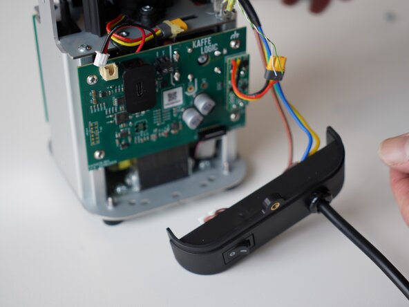

  7. Kaffelogic Nano 7/LINK (D-P Serial) Power Cable Replacement, Remove the mains wiring cover: Schritt 7, Bild 1 von 3 Kaffelogic Nano 7/LINK (D-P Serial) Power Cable Replacement, Remove the mains wiring cover: Schritt 7, Bild 2 von 3 Kaffelogic Nano 7/LINK (D-P Serial) Power Cable Replacement, Remove the mains wiring cover: Schritt 7, Bild 3 von 3
    • Remove the terminal PCB cover and set it aside. This is held in with four small plastic clips at each corner.

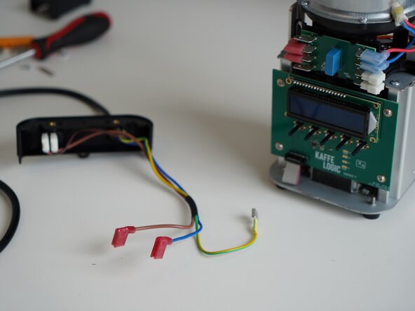

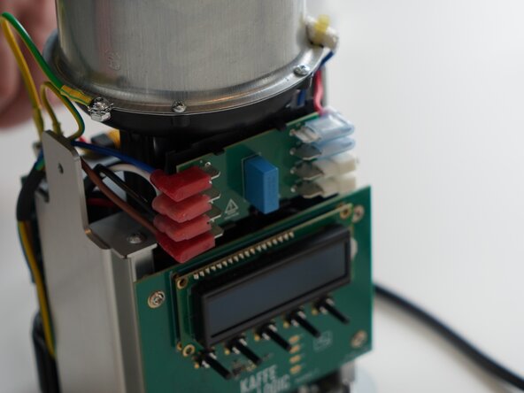

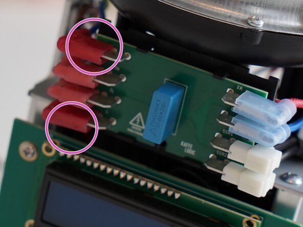

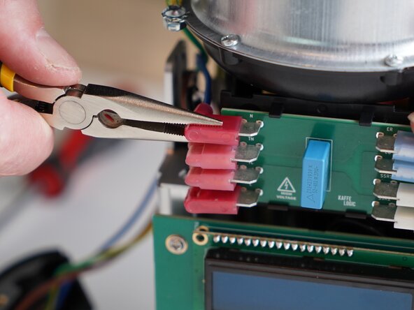

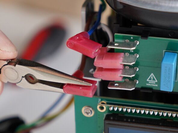

  8. Kaffelogic Nano 7/LINK (D-P Serial) Power Cable Replacement, Disconnect the mains input: Schritt 8, Bild 1 von 3 Kaffelogic Nano 7/LINK (D-P Serial) Power Cable Replacement, Disconnect the mains input: Schritt 8, Bild 2 von 3 Kaffelogic Nano 7/LINK (D-P Serial) Power Cable Replacement, Disconnect the mains input: Schritt 8, Bild 3 von 3
    • Disconnect the mains cables. Marked an N (Neutral) and L (Live)

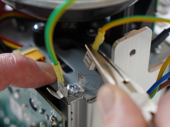

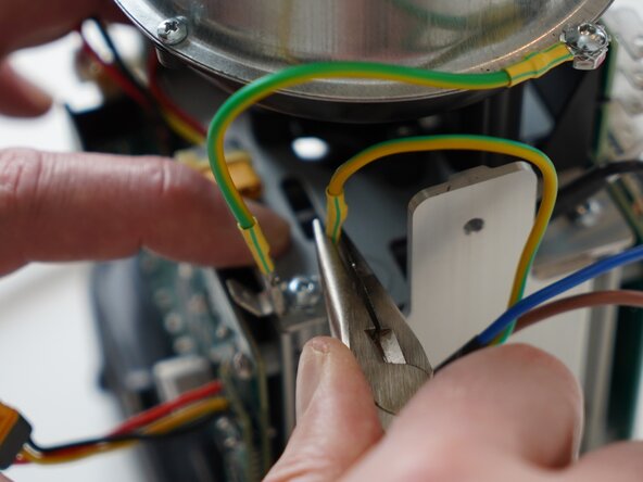

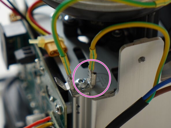

  9. Kaffelogic Nano 7/LINK (D-P Serial) Power Cable Replacement, Remove the earth tab: Schritt 9, Bild 1 von 3 Kaffelogic Nano 7/LINK (D-P Serial) Power Cable Replacement, Remove the earth tab: Schritt 9, Bild 2 von 3 Kaffelogic Nano 7/LINK (D-P Serial) Power Cable Replacement, Remove the earth tab: Schritt 9, Bild 3 von 3
    • Remove the mains earthing connector from the tab. Pliers can be used for this as it can be tight.
  10. Kaffelogic Nano 7/LINK (D-P Serial) Power Cable Replacement, Cable removed: Schritt 10, Bild 1 von 2 Kaffelogic Nano 7/LINK (D-P Serial) Power Cable Replacement, Cable removed: Schritt 10, Bild 2 von 2
    • Your mains cable is now free, and ready for repair or replacement.
