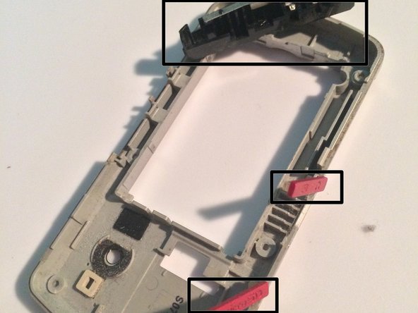

  5. LG Shine Complete Disassembly., Optional Replacement.: Schritt 5, Bild 1 von 2 LG Shine Complete Disassembly., Optional Replacement.: Schritt 5, Bild 2 von 2
    • It is possible to remove and swap out these parts before reassembly: battery cover release button, grounding clip, charging and SD card slot covers, plastic/metal framework

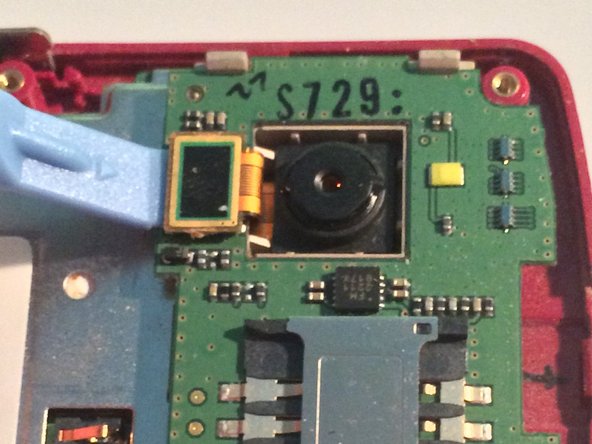

    • Remove the button strip by prying on the rubber pin loop on the top side of the strip.
    • Remove the camera by releasing the ribbon cable connection with a plastic spudger, then pulling it out with tweezers.

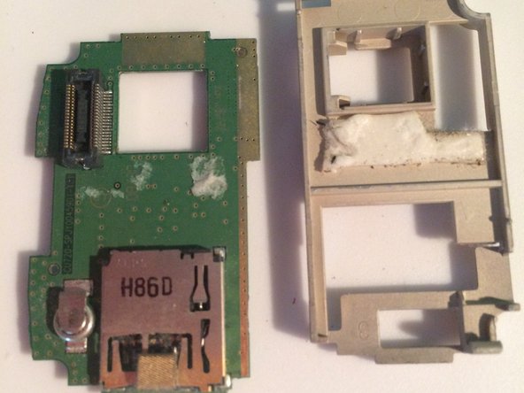

  7. LG Shine Complete Disassembly., Camera Circuit Board: Schritt 7, Bild 1 von 3 LG Shine Complete Disassembly., Camera Circuit Board: Schritt 7, Bild 2 von 3 LG Shine Complete Disassembly., Camera Circuit Board: Schritt 7, Bild 3 von 3
    • Use a plastic spudger to lift the camera circuit board up, then pull it out.
    • If needed, release the clips and remove the plastic casing around this circuit board (revealing a soldered-on button battery) but you will need to remove and replace the sticky foam between the casing and the board.

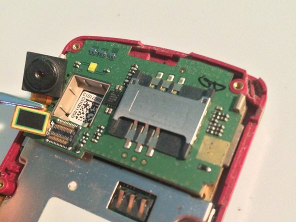

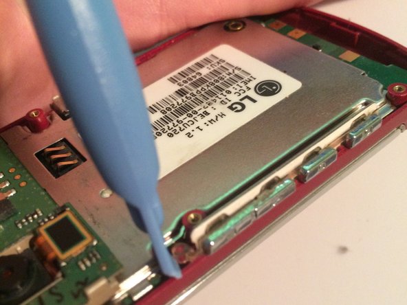

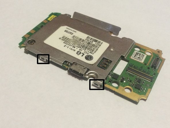

  8. LG Shine Complete Disassembly., Motherboard: Schritt 8, Bild 1 von 3 LG Shine Complete Disassembly., Motherboard: Schritt 8, Bild 2 von 3 LG Shine Complete Disassembly., Motherboard: Schritt 8, Bild 3 von 3
    • Pry the ribbon cable connection up with a plastic spudger and slide the screen up.
    • Pry each side of the phone case away from the motherboard releasing the clips to the motherboard.
    • Pull the motherboard out.
    • If the keyboard has not fallen out during removal, remove it now.

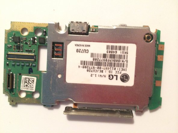

  9. LG Shine Complete Disassembly., Optional Disassembly.: Schritt 9, Bild 1 von 3 LG Shine Complete Disassembly., Optional Disassembly.: Schritt 9, Bild 2 von 3 LG Shine Complete Disassembly., Optional Disassembly.: Schritt 9, Bild 3 von 3
    • If needed, you can remove the metal casing around the motherboard by bending the clips and lifting up on the right side. Take note that you will have to bend back the clips for reassembly.
    • You can also remove the rubber microphone gasket if needed.

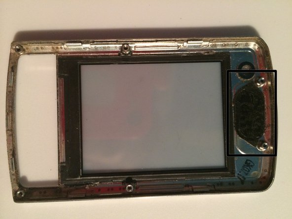

  13. LG Shine Complete Disassembly., Optional Disassembly: Schritt 13, Bild 1 von 2 LG Shine Complete Disassembly., Optional Disassembly: Schritt 13, Bild 2 von 2
    • Remove the front screen if needed, but you will most likely have to throw out the one you take off because of the adhesive on it.
    • Once the screen has been removed, you can replace the screen. Cleaning of the speaker dust filter is also possible.

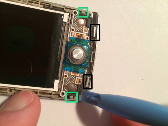

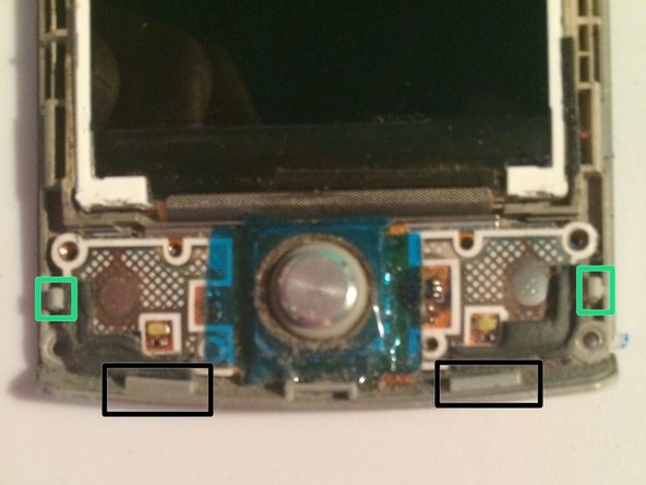

  14. LG Shine Complete Disassembly., Button Stabilizer.: Schritt 14, Bild 1 von 3 LG Shine Complete Disassembly., Button Stabilizer.: Schritt 14, Bild 2 von 3 LG Shine Complete Disassembly., Button Stabilizer.: Schritt 14, Bild 3 von 3
    • Remove the two black Phillips head screws holding the joystick assembly.
    • Keep these screws separate from all other screws.
    • Push down on the side of the clip holding the button assembly together and pry the side of the button assembly above the clip. (repeat on each side)
    • When removing, make sure you are not catching the bottom lip.

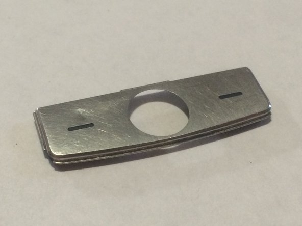

  15. LG Shine Complete Disassembly., Disconnecting and Removing LCD.: Schritt 15, Bild 1 von 3 LG Shine Complete Disassembly., Disconnecting and Removing LCD.: Schritt 15, Bild 2 von 3 LG Shine Complete Disassembly., Disconnecting and Removing LCD.: Schritt 15, Bild 3 von 3

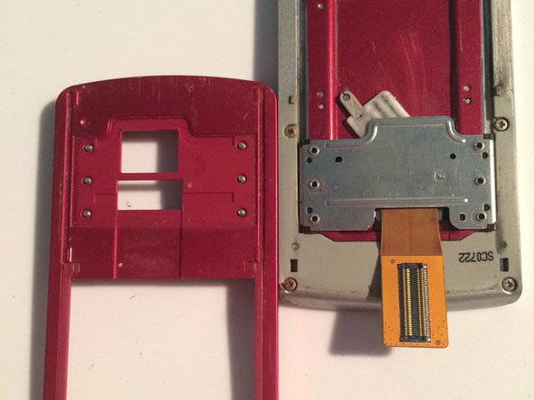

    • Flip over the LCD and button assembly to the right, and if covered, peel the tape on the back of the button assembly back to expose a ribbon connection.
    • Use a plastic spudger to lift up the lock on the ribbon cable, this lets you pull the LCD out.
  16. LG Shine Complete Disassembly., Backing Plate: Schritt 16, Bild 1 von 2 LG Shine Complete Disassembly., Backing Plate: Schritt 16, Bild 2 von 2
    • Pry out the metal backing plate where the LCD was.
    • There are adhesives on each side of the plate, sticking to the ribbon cable, pry carefully.
    • Once removed, slide the ribbon cable through the slot in the casing.

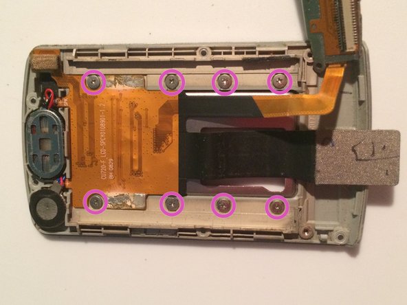

  17. LG Shine Complete Disassembly., Ribbon Cable/Slide Mechanism: Schritt 17, Bild 1 von 2 LG Shine Complete Disassembly., Ribbon Cable/Slide Mechanism: Schritt 17, Bild 2 von 2
    • Keep pressure on the slide mechanism as it is spring loaded and will want to fly off the phone once the next screws are removed.
    • Remove the eight Phillips head screws.
    • Keep these away from all other screws, they are more flat so they sit flush under the LCD.
    • Once all these screws are removed, slowly and carefully peel the ribbon cable from the slider mechanism.

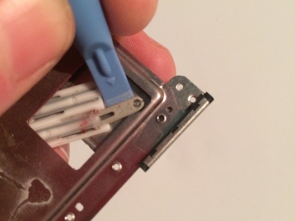

    • Further take apart the slide mechanism by removing the spring with a plastic spudger.
