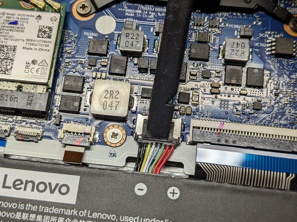

  4. Lenovo IdeaPad 5 15ITL05 Battery Replacement, Disconnect the battery: Schritt 4, Bild 1 von 2 Lenovo IdeaPad 5 15ITL05 Battery Replacement, Disconnect the battery: Schritt 4, Bild 2 von 2
    • Use the flat end of a spudger to push the square tab on the battery connector and slide it out of its socket.
