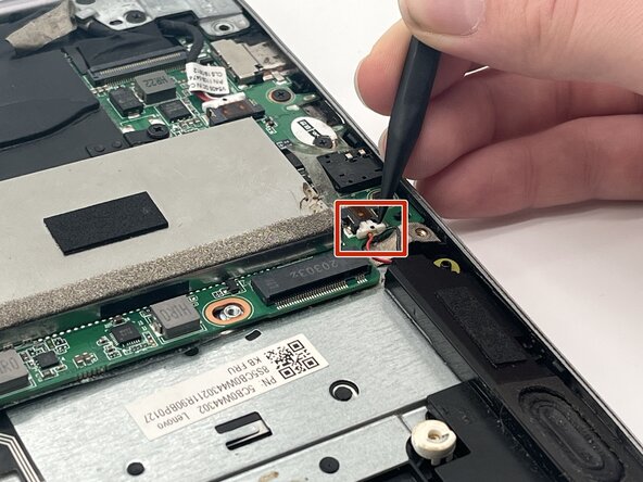

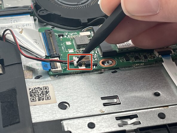

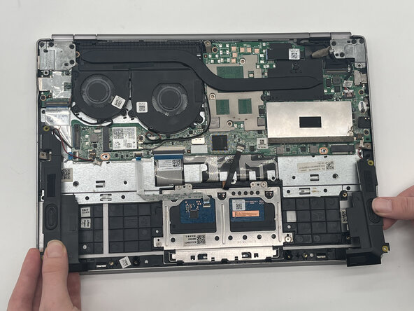

  4. Lenovo ThinkBook 13s-IML Speakers Replacement, Speakers: Schritt 4, Bild 1 von 3 Lenovo ThinkBook 13s-IML Speakers Replacement, Speakers: Schritt 4, Bild 2 von 3 Lenovo ThinkBook 13s-IML Speakers Replacement, Speakers: Schritt 4, Bild 3 von 3
    • Disconnect each of the two speakers by using a spudger to carefully push each of the two speaker connectors out of their sockets.
    • Carefully lift the speakers up and out of the chassis.
