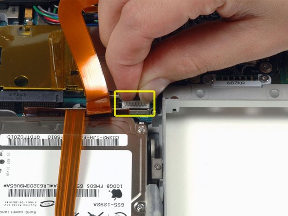

    • Disconnect the hard drive and ExpressCard connectors from the left side of the logic board.

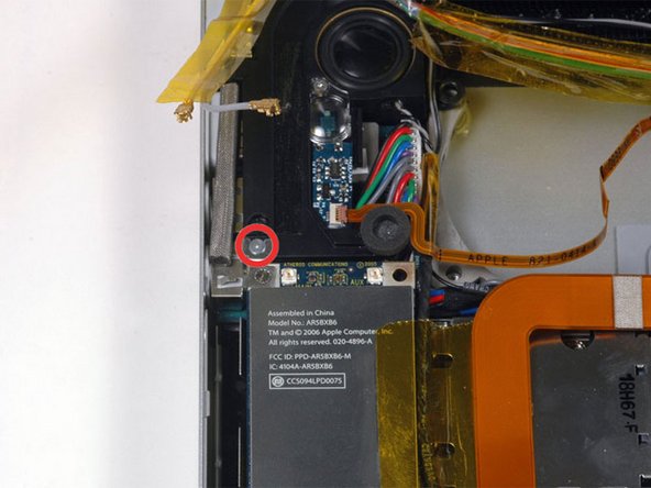

    • Remove the single silver Phillips screw located just above the Airport Extreme card.
    • Lift the small silver metal retaining bracket up and out of the computer.

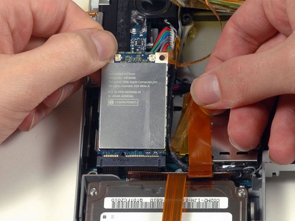

    • Peel back the orange tape on the right side of the Airport Extreme card.
    • Lift the Airport Extreme card up and slide it out of its connector.

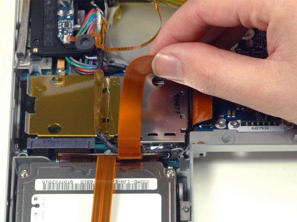

    • Peel up the orange hard drive cable from above the ExpressCard cage.

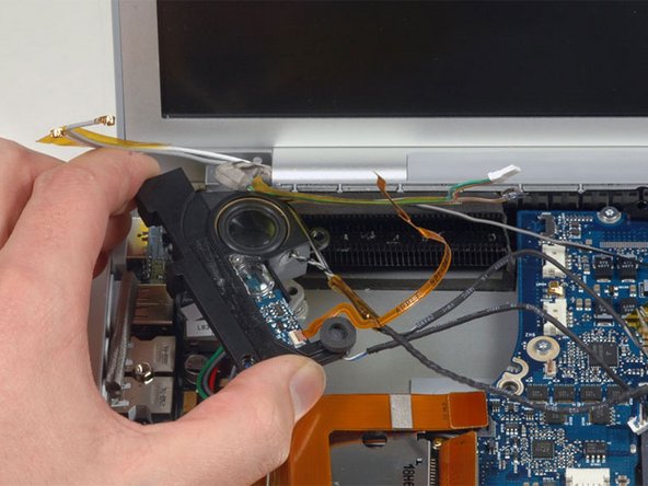

  23. MacBook Pro 15" Core Duo Model A1150 ExpressCard Cage Replacement: Schritt 23, Bild 1 von 1
    • Remove the single black T6 Torx screw securing the left speaker.
  24. MacBook Pro 15" Core Duo Model A1150 ExpressCard Cage Replacement: Schritt 24, Bild 1 von 1

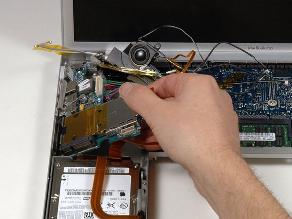

    • Lift the left speaker assembly out of its housing and place it in the area previously occupied by the left fan.
  25. MacBook Pro 15" Core Duo Model A1150 ExpressCard Cage Replacement: Schritt 25, Bild 1 von 1

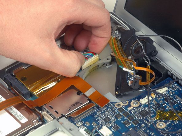

    • Disconnect the large multi-colored power cable from the left I/O board.
  26. MacBook Pro 15" Core Duo Model A1150 ExpressCard Cage Replacement: Schritt 26, Bild 1 von 1

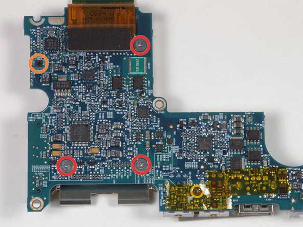

  29. MacBook Pro 15" Core Duo Model A1150 ExpressCard Cage Replacement: Schritt 29, Bild 1 von 1
    • Lift the left I/O board off the ExpressCard cage.
