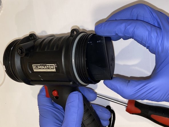

  1. MasterCraft Eliminator Waterproof Spotlight Battery Replacement, Battery: Schritt 1, Bild 1 von 2 MasterCraft Eliminator Waterproof Spotlight Battery Replacement, Battery: Schritt 1, Bild 2 von 2
    • Twist the front cover of the spotlight in a counter-clockwise rotation and remove it from the device.

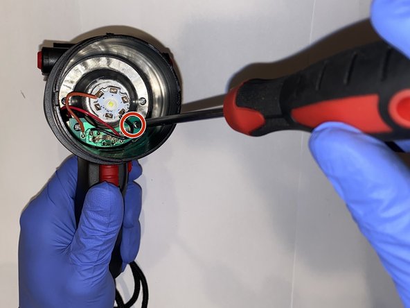

  2. MasterCraft Eliminator Waterproof Spotlight Battery Replacement: Schritt 2, Bild 1 von 2 MasterCraft Eliminator Waterproof Spotlight Battery Replacement: Schritt 2, Bild 2 von 2
    • Remove the rear piece which is the protection cover for the charging port.

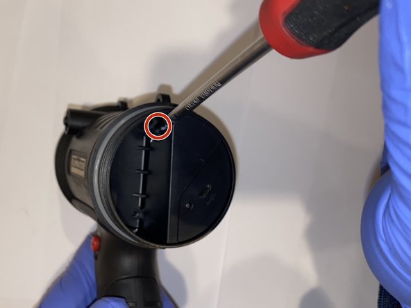

  3. MasterCraft Eliminator Waterproof Spotlight Battery Replacement: Schritt 3, Bild 1 von 2 MasterCraft Eliminator Waterproof Spotlight Battery Replacement: Schritt 3, Bild 2 von 2
    • Using the JIS #00 screwdriver, remove the two screws securing the motherboard to the device.
  4. MasterCraft Eliminator Waterproof Spotlight Battery Replacement: Schritt 4, Bild 1 von 3 MasterCraft Eliminator Waterproof Spotlight Battery Replacement: Schritt 4, Bild 2 von 3 MasterCraft Eliminator Waterproof Spotlight Battery Replacement: Schritt 4, Bild 3 von 3
    • Using the JIS #00 screwdriver, remove the single screw securing the charging port and remove the charging port from the device.
