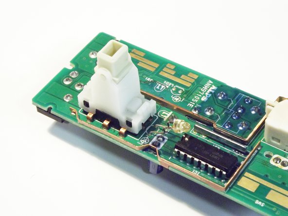

    • There is a white lever on the circuit board, and next to it there is an LED.
    • Bend this LED back to allow for the removal of the lever.
    • Remember to bend this back into place during reassembly.
  8. Nissan Frontier 2004-2015 Faulty Power Window Switch Fix: Schritt 8, Bild 1 von 3 Nissan Frontier 2004-2015 Faulty Power Window Switch Fix: Schritt 8, Bild 2 von 3 Nissan Frontier 2004-2015 Faulty Power Window Switch Fix: Schritt 8, Bild 3 von 3
    • Using a thin spudger, carefully pry these two latches off of the lever.
    • Do not pry against the copper rail marked red. Only pry against the area marked green.
    • Carefully wiggle the lever off, and remove the small metal parts from under the lever. These parts are moving electrical contacts.
    • These moving electrical contacts may fly out upon removal of the lever. Be sure to clear the area to avoid losing them.
  9. Nissan Frontier 2004-2015 Faulty Power Window Switch Fix: Schritt 9, Bild 1 von 2 Nissan Frontier 2004-2015 Faulty Power Window Switch Fix: Schritt 9, Bild 2 von 2
    • Clean each of the six contacts shown with cotton-swabs soaked in isopropyl alcohol.
    • Do not over soak the board.
    • Be sure to wear gloves.
    • After cleaning the board, let it dry for 5 minutes
