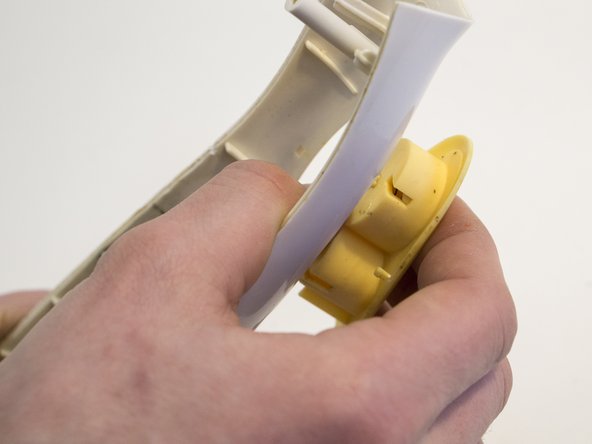

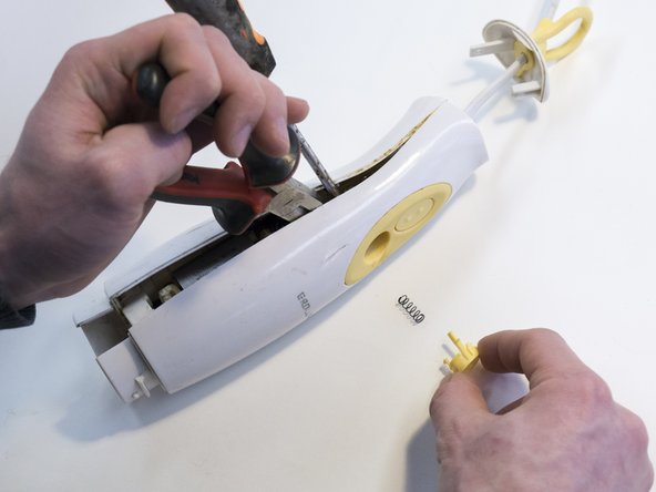

  3. ProLine HB25 Disassembly: Schritt 3, Bild 1 von 2 ProLine HB25 Disassembly: Schritt 3, Bild 2 von 2
    • Separate the housing with calibrated force.
    • Keep your fingers away from the housing and do not bend or break the housing.
    • Use a flathead screwdriver to push out the lower function button.
    • Remove the separating device.

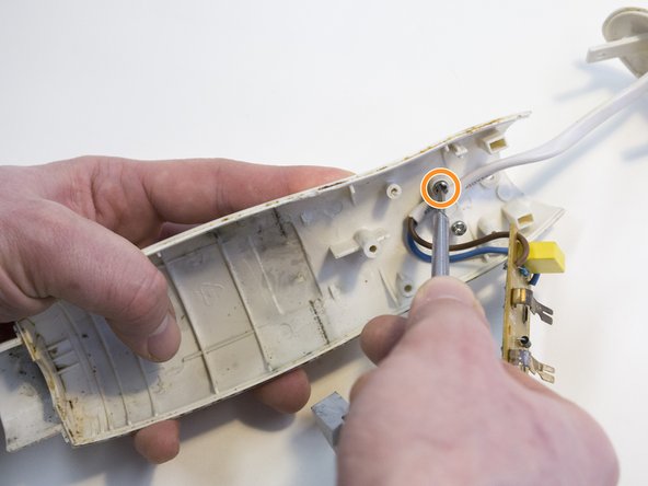

  4. ProLine HB25 Disassembly: Schritt 4, Bild 1 von 1
    • Unscrew the hidden screw under the button.
  5. ProLine HB25 Disassembly: Schritt 5, Bild 1 von 2 ProLine HB25 Disassembly: Schritt 5, Bild 2 von 2
    • Open the housing.
    • Unscrew the circuit board.
    • Unscrew the wire lock.

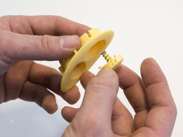

  6. ProLine HB25 Disassembly: Schritt 6, Bild 1 von 2 ProLine HB25 Disassembly: Schritt 6, Bild 2 von 2
    • Push the housing of the button out of the housing.
  7. ProLine HB25 Disassembly: Schritt 7, Bild 1 von 2 ProLine HB25 Disassembly: Schritt 7, Bild 2 von 2
    • Push on the side of the housing of the button to push the button out of the housing.
    • The spring can jump away when you push out the button.
