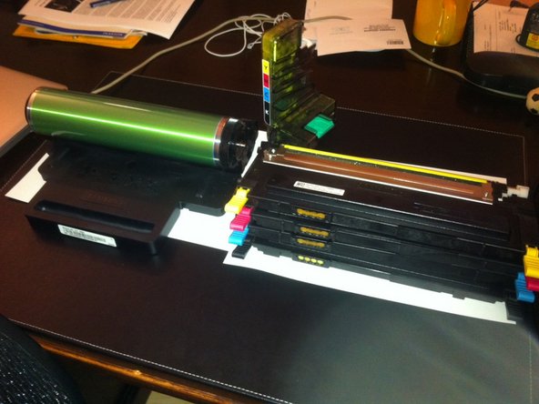

    • Open the printer front and take everything out
    • Take out the toners
    • Take out the drum together with the waste bin

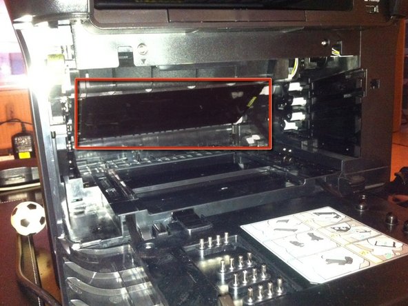

  3. Repairing Samsung clx-3175 Colour Laser Printer Fix black vertical lines: Schritt 3, Bild 1 von 1
    • Your printer should now look like in the image attached
    • Use a flashlight to see inside the printer
    • On the glossy black plastic you will see vertical lines of color which are the cause of your printers problem

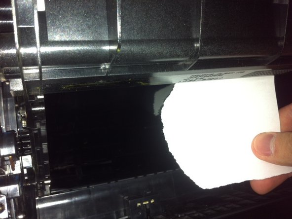

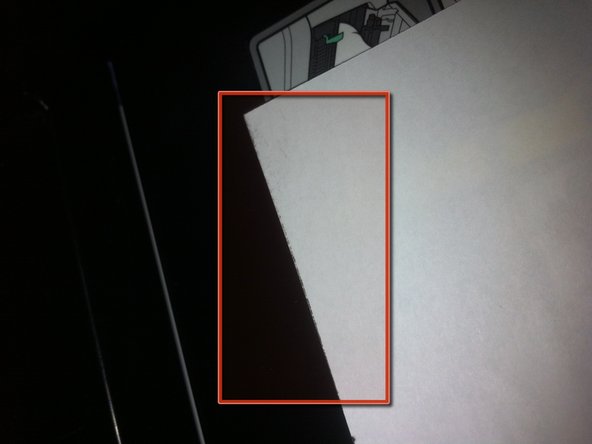

    • Use a small white paper and try to stick it into the top - like shown
    • Move it from left to right and drag it out again
    • You will see that it is pretty dirty afterwards
    • Do this multiple times and clean the black glossy plastic with a cotton cloth - be careful not to scratch it
  5. Repairing Samsung clx-3175 Colour Laser Printer Fix black vertical lines: Schritt 5, Bild 1 von 1
    • Close the printer again and print some pages
    • After the 2nd or 3rd the black vertical lines should be gone completely
    • Have fun - again!

My printer was many years practically only B&W because of awful colors. This trick helped to restore colors. Thank you!
visitor visitor - Antwort
Step 4: you can also clean the bottom (and not only the top) of the black glossy plastic: it was the root cause of my black lines
Tested with CLX-3185FW
Thanks
Jean-Baptiste Beaufreton - Antwort
this will laso work for the samsunc clp-310(n,w) and the clp-315(n,w)
thijs kunst - Antwort
