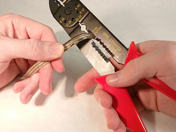

  10. Repairing a Broken 3-Prong Bodycord for a Fencing Sword: Schritt 10, Bild 1 von 3 Repairing a Broken 3-Prong Bodycord for a Fencing Sword: Schritt 10, Bild 2 von 3 Repairing a Broken 3-Prong Bodycord for a Fencing Sword: Schritt 10, Bild 3 von 3
    • Strip the wires, about 1/4", or 5 mm, from the end.
    • Stripping the wires is removing the plastic insulation to expose the inner metal conductor.
    • Repeat for each wire.
