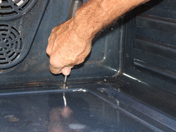

    3. Samsung NX58H5600SS Oven Igniter Replacement: Schritt 3, Bild 1 von 3 Samsung NX58H5600SS Oven Igniter Replacement: Schritt 3, Bild 2 von 3 Samsung NX58H5600SS Oven Igniter Replacement: Schritt 3, Bild 3 von 3
      • Remove the vented floor pan from the bottom of the oven by removing the two 11 mm Phillips #2 screws from the rear of the base plate.
      • Lift out the base plate.
