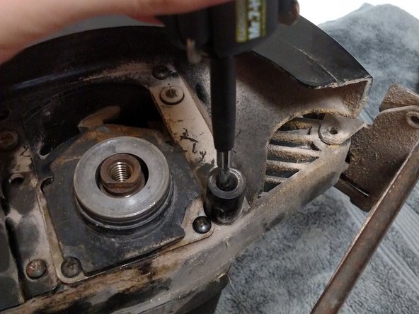

  6. Sears Craftsman 315.109020 Motor Replacement: Schritt 6, Bild 1 von 2 Sears Craftsman 315.109020 Motor Replacement: Schritt 6, Bild 2 von 2
    • Unscrew the 70 mm screw that is inside the black tube (see first picture).
    • Unscrew the five screws as highlighted in the second picture. The bottom left is a 70 mm screw and the other four are 20 mm screws.
    • Unscrewing the remaining four 20 mm screws are unnecessary unless you wish to repair or replace the cogs in the saw.
