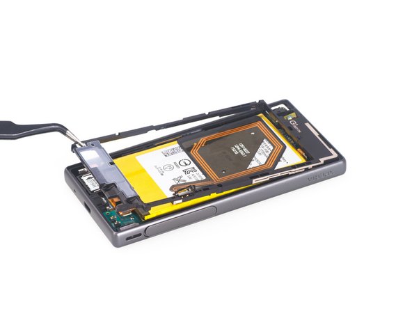

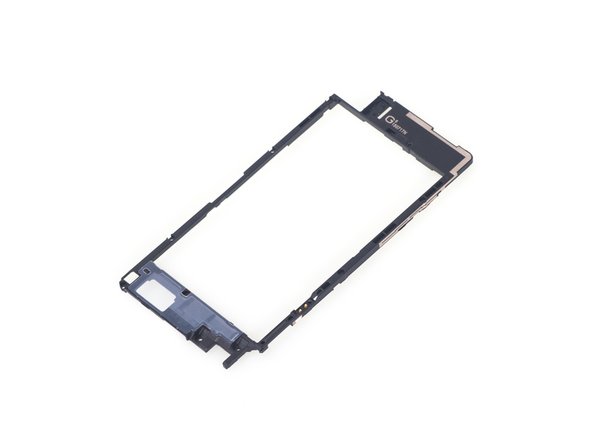

  4. Sony Xperia Z5 Compact LCD Screen Assembly Replacement: Schritt 4, Bild 1 von 3 Sony Xperia Z5 Compact LCD Screen Assembly Replacement: Schritt 4, Bild 2 von 3 Sony Xperia Z5 Compact LCD Screen Assembly Replacement: Schritt 4, Bild 3 von 3
    • Remove the plastic bracket.
    • Pry up and remove back frame.
