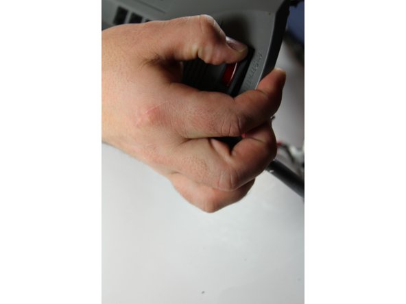

  1. Stratitec S5202A Snap-in Circuit Breaker Replacement, Snap-in Circuit Breaker: Schritt 1, Bild 1 von 1
    • Place the power strip on a level surface with the bottom facing up.

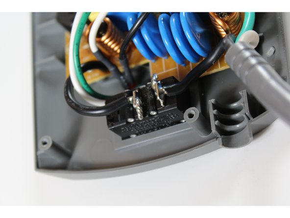

  5. Stratitec S5202A Snap-in Circuit Breaker Replacement: Schritt 5, Bild 1 von 2 Stratitec S5202A Snap-in Circuit Breaker Replacement: Schritt 5, Bild 2 von 2
    • Locate the power switch leads and apply solder iron tip to wire 1.
    • Waiting for the solder to completely melt may take up to a minute or two.
    • Do not pull on the wire until the solder on both the lead and the wire is completely melted.
  6. Stratitec S5202A Snap-in Circuit Breaker Replacement: Schritt 6, Bild 1 von 1
    • Once the solder has melted on the switch, use a pair of flat-head pliers to remove the wire.
    • In some cases it may be necessary to cut the tips of the wire off in order to free the wire.
  7. Stratitec S5202A Snap-in Circuit Breaker Replacement: Schritt 7, Bild 1 von 1
    • Repeat steps 5 and 6 for wire two.
  8. Stratitec S5202A Snap-in Circuit Breaker Replacement: Schritt 8, Bild 1 von 1
    • Loosen the power switch by pushing on the plastic side tabs located inside the power strip case.
    • If you can't get the tabs to release, use a pair of flat-heat pliers and push down on one tab at a time.
    • There are two tabs on each side of the switch.
