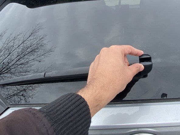

    • Firmly grip the edge of the lock located at the base of the wiper.
    • Simultaneously push both sides of the lock upward to open it.
  2. Toyota Rav4 2019-2024 Rear Windshield Wiper Replacement: Schritt 2, Bild 1 von 1
    • Lift the rear windshield wiper upwards and away from the back window.
