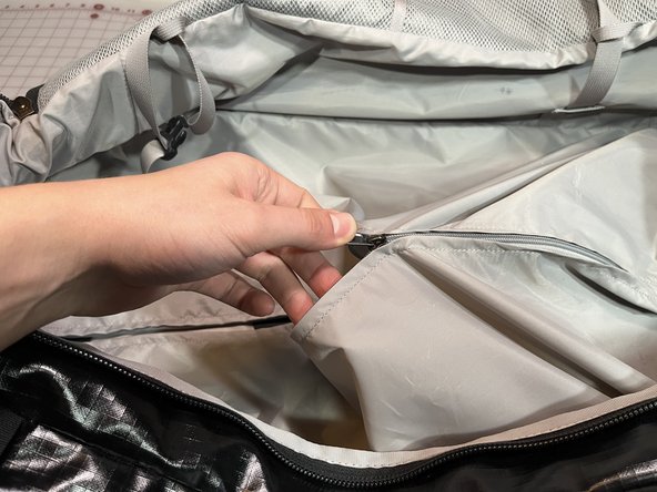

    • Starting with an empty duffel, open the main zipper compartment.
    • Locate the zipper in the liner and open. This will expose the inside of the plastic wheel housing.
    • If the wheel and axle are missing, a nut and washer may be loose inside this liner compartment. Try to locate the washer and nut to reuse.
    • Patagonia Repair Tech Tip: To increase visibility, use an extra light source like a flashlight or headlamp.

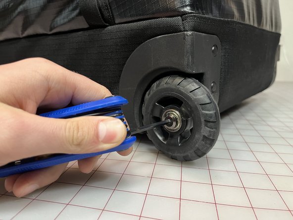

  2. Wheel Replacement on a Patagonia Black Hole® Wheeled Duffel, Remove Broken Wheel & Axle: Schritt 2, Bild 1 von 3 Wheel Replacement on a Patagonia Black Hole® Wheeled Duffel, Remove Broken Wheel & Axle: Schritt 2, Bild 2 von 3 Wheel Replacement on a Patagonia Black Hole® Wheeled Duffel, Remove Broken Wheel & Axle: Schritt 2, Bild 3 von 3

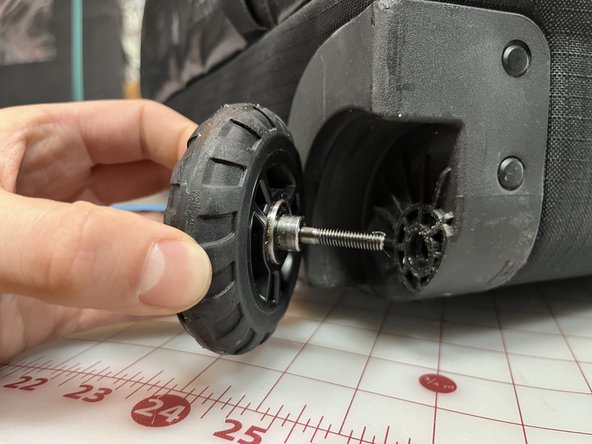

    • If the damaged wheel and axle are still attached, locate the axle nut inside the liner compartment and hold it in place with the adjustable wrench.
    • If there is excess foam and lining fabric blocking access, see Step 5 and then come back.
    • From the outside, turn the axle using the 4mm Allen wrench to free the wheel and axle from the plastic wheel housing. Save the washer and nut to reuse.
    • Righty tighty, lefty loosey!
    • Test the other wheel for functionality and remove if it is broken.

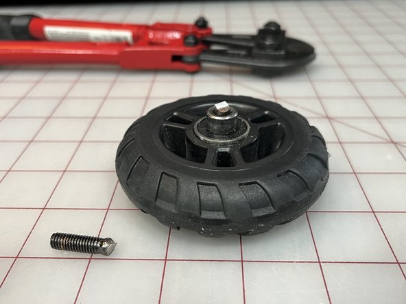

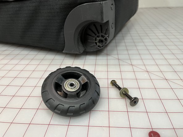

  3. Wheel Replacement on a Patagonia Black Hole® Wheeled Duffel, Assess Damage of Wheel Parts: Schritt 3, Bild 1 von 3 Wheel Replacement on a Patagonia Black Hole® Wheeled Duffel, Assess Damage of Wheel Parts: Schritt 3, Bild 2 von 3 Wheel Replacement on a Patagonia Black Hole® Wheeled Duffel, Assess Damage of Wheel Parts: Schritt 3, Bild 3 von 3
    • Assess both wheels on the luggage:
    • Damaged Tread – If the wheel has a worn rubber tread or a flat spot (reference image #2), the wheel must be replaced, skip to Step 5.
    • Damaged Axle – If the original wheel is in working shape, but the axle is bent (reference image #3), continue to Step 4.
    • Missing Wheel – If both the wheel and axle are missing, skip to Step 5.
    • Responsibly discard any unusable pieces.

  4. Wheel Replacement on a Patagonia Black Hole® Wheeled Duffel, Salvage Working Wheel from Bent Axle: Schritt 4, Bild 1 von 3 Wheel Replacement on a Patagonia Black Hole® Wheeled Duffel, Salvage Working Wheel from Bent Axle: Schritt 4, Bild 2 von 3 Wheel Replacement on a Patagonia Black Hole® Wheeled Duffel, Salvage Working Wheel from Bent Axle: Schritt 4, Bild 3 von 3
    • If the original wheel is in working shape, but the axle is bent, you can often free the wheel by cutting the axle off.
    • Using bolt cutters, cut the axle as close to wheel as possible.
    • Use safety glasses.
    • If the cut axle remains stuck inside the wheel, elevate the wheel with a sturdy surface, and tap the cut end of the axle using a flat head screwdriver and a hammer until the axle is driven out.
    • What did I just say about safety glasses?

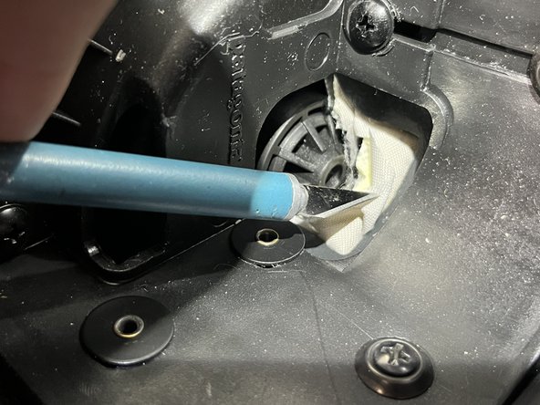

  5. Wheel Replacement on a Patagonia Black Hole® Wheeled Duffel, Prepare the Inside of the Plastic Housing: Schritt 5, Bild 1 von 2 Wheel Replacement on a Patagonia Black Hole® Wheeled Duffel, Prepare the Inside of the Plastic Housing: Schritt 5, Bild 2 von 2
    • There is often excess foam and lining fabric blocking access to the back of the plastic housing.
    • It is okay to cut away this excess using an X-Acto blade.
    • Use extreme caution to avoid cutting yourself or other parts of the duffel.

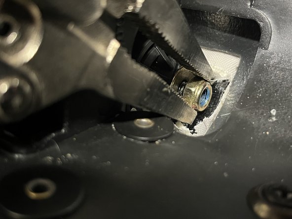

  6. Wheel Replacement on a Patagonia Black Hole® Wheeled Duffel, Reassemble Wheel & Axle: Schritt 6, Bild 1 von 3 Wheel Replacement on a Patagonia Black Hole® Wheeled Duffel, Reassemble Wheel & Axle: Schritt 6, Bild 2 von 3 Wheel Replacement on a Patagonia Black Hole® Wheeled Duffel, Reassemble Wheel & Axle: Schritt 6, Bild 3 von 3
    • Place a new or salvaged wheel onto a new axle and insert the axle into the plastic wheel housing.
    • Inside the plastic wheel housing, place a washer and a nut onto the axle and finger-turn until attached.
    • Then use the adjustable wrench or needle nose vise grip to keep the nut in-place and tighten the axle from the outside using the 4mm Allen wrench.
    • Make sure the locking nylon ring on the nut engages on the axle. This prevents the nut from loosening during use.
