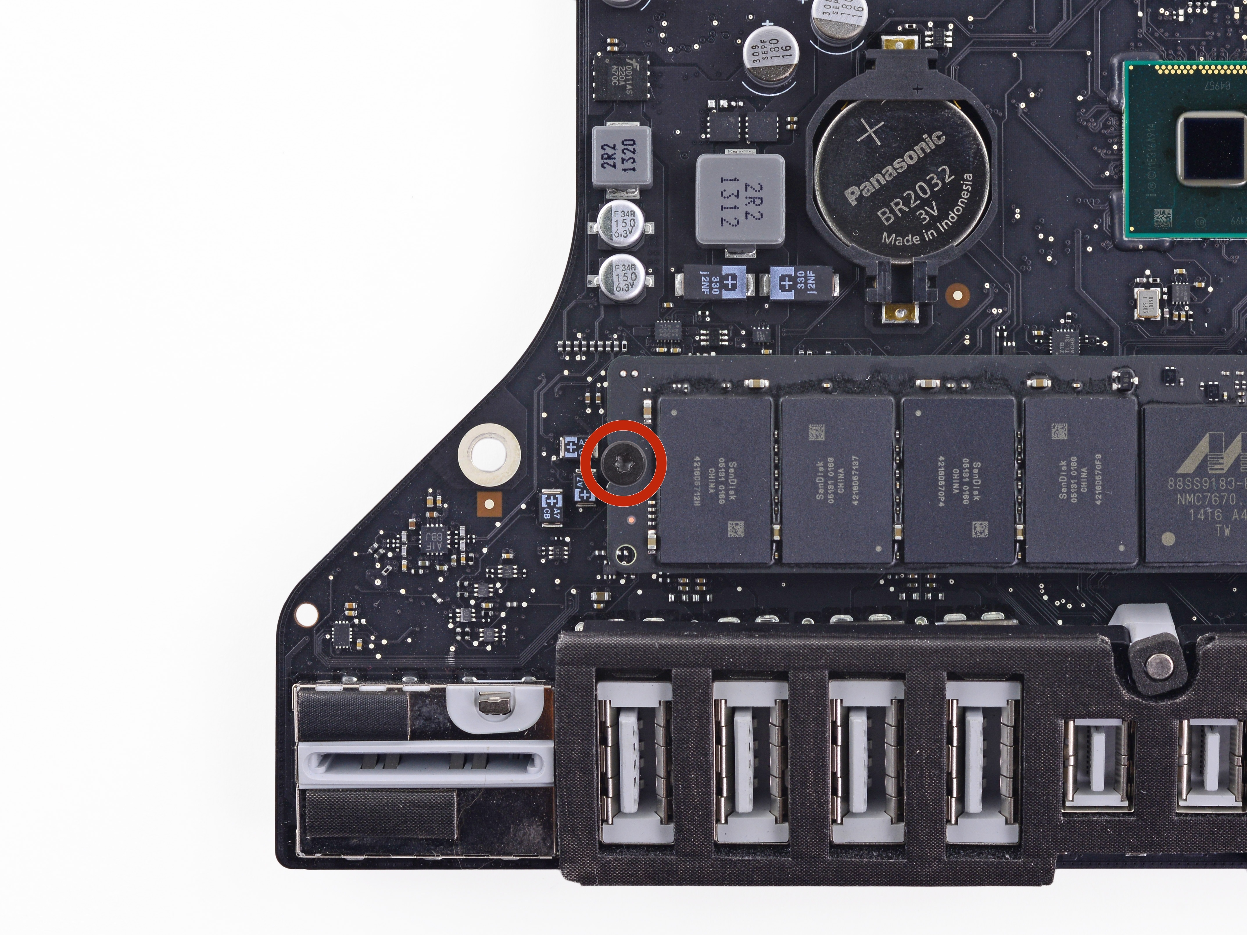

Hi!
I'm planning to add a SSD in PCIe slot on my iMac Late 2013 using your instructions.
Everything seems to be bought, I'm almost ready to start except one thing - I don't know the size of a screw which holds the SSD on mother board and I don't know if it exists (I mean - if it exists while there is no SSD in my config)?
Here's a picture SSD hold down screw
What's the length and diameter of this screw? Can I use a drop of silicone sealant instead of a screw?

Hi dv1977, I have the same iMac and thinking of SSD upgrade. I do have only HDD, would like to add blade SSD.
Would you mind to tell which model have you used ?

That appears to be a T5.

This "chosen solution" is not a solution at all. It is actually incorrect. According to these two how to videos, it is a T8 screw, that I am still trying to find myself!
https://eshop.macsales.com/installvideos...
iMac Intel 27" EMC 2639 Blade SSD austauschen
von
You are correct it is showing as a T8 which I have never seen as a blade hold down screw.

I think this is the screw for the SSD on the Imac
https://www.ebay.com/itm/SSD-Screw-Torx-...
