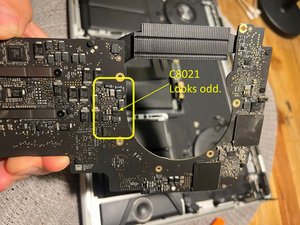

@steffhei just had another look at your images and realized that your computers logic board is actually a 820-00239. You had it listed a Function Key meanwhile said it was a Touch Bar. Sorry about missing that. Anyhow, take a look at C8021. That capacitor looks a bit odd. Could just be me and my old eyes :-)
That capacitor is not part of the charging circuitry but belongs to the SSD circuit.

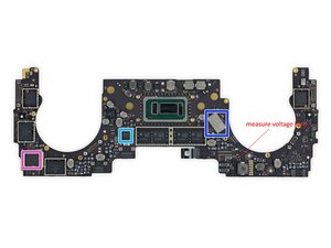

@steffhei first we need to see if your USB-C port controller UB300 get's proper voltages to turn on. UB300 is actually what turns the 5V in to 20V. The same goes of course for U3100 which is the USB-C controller on the other port. Both get the power from PP3V3_G3H rail. So, Measure the voltage on the component that sits on that rail right next to U3100. Measure at the point where the red arrow points to. You should get 3.3V on that point. I know its tight but your regular multimeter test probe should still reach it. I also marked the ground points you can use for your ground probe.
What I am proposing is to test PP3V3_G3H by connecting your charger and USB-C meter. Place your meter in DC mode at a range of 30V (just in case) or so. Now Red probe from your meter to C3100 (where the red arrow terminates. Black probe to ground. What voltage do you have? If you have 3.3V then your controller is getting the voltage it needs to and in theory should switch the 5V to 20V. If it does not, then we know the issue is with the PP3V3_G3H rail and we will have to check the components where that originates.
I do hope that this all makes sense and is not to much technobabble :-)

Check on C5256 and see if you have the right voltage there
Check PPVIN_G3H_P3V3G3H
Next measure PPDCIN_G3H_CHGR_R
@steffhei lets check the power on the fuse. Measure each point separate black on ground and then each point on the fuse
@steffhei now let's check enable for the charging IC PPDCIN_G3H
@steffhei last one. Measure the voltage on here

@steffhei okay that is your Charge IC enable line and it does not get power either. We have had some really weird voltages at some places and we do not have the right voltages on the USB-C controller. With the battery not charging and the measurements we took it appears as if the issue is the U7000 IC which is the ISL8239 charging IC. It is a BGA IC and ill require some knowledge of BGA soldering. This might just be something you will have to get to somebody to repair it for you. I wonder if this was not already happening before you replaced the battery. The old one may not have charged properly either. Of course there is always a chance that this involved more components but personally I'd start with U7000.
Of course, you always want to make sure that your charger is the right charger and that everything gets connected right when you re-assemble your computer. That is really all we can do for now until you find someone who can possibly assist you with this repair.

@steffhei here is the location of the charge IC. It is U7000 which is a ISL9239
@steffhei hier ist die Position des Ladungs-IC. Es ist U7000, das ein ISL9239 ist
