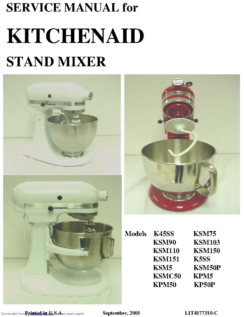

SERVICE MANUAL for KITCHENAID STAND MIXER
Downloaded from www.Manualslib.com manuals search engine
Models K45SS KS M75 KSM90 KS M103 KSM110 KS M150 KSM151 K5SS KSM5 KS M50P KSMC50 KPM5 KPM50 KP50P
Printed in U.S.A. September, 2005
LIT4177310-C
