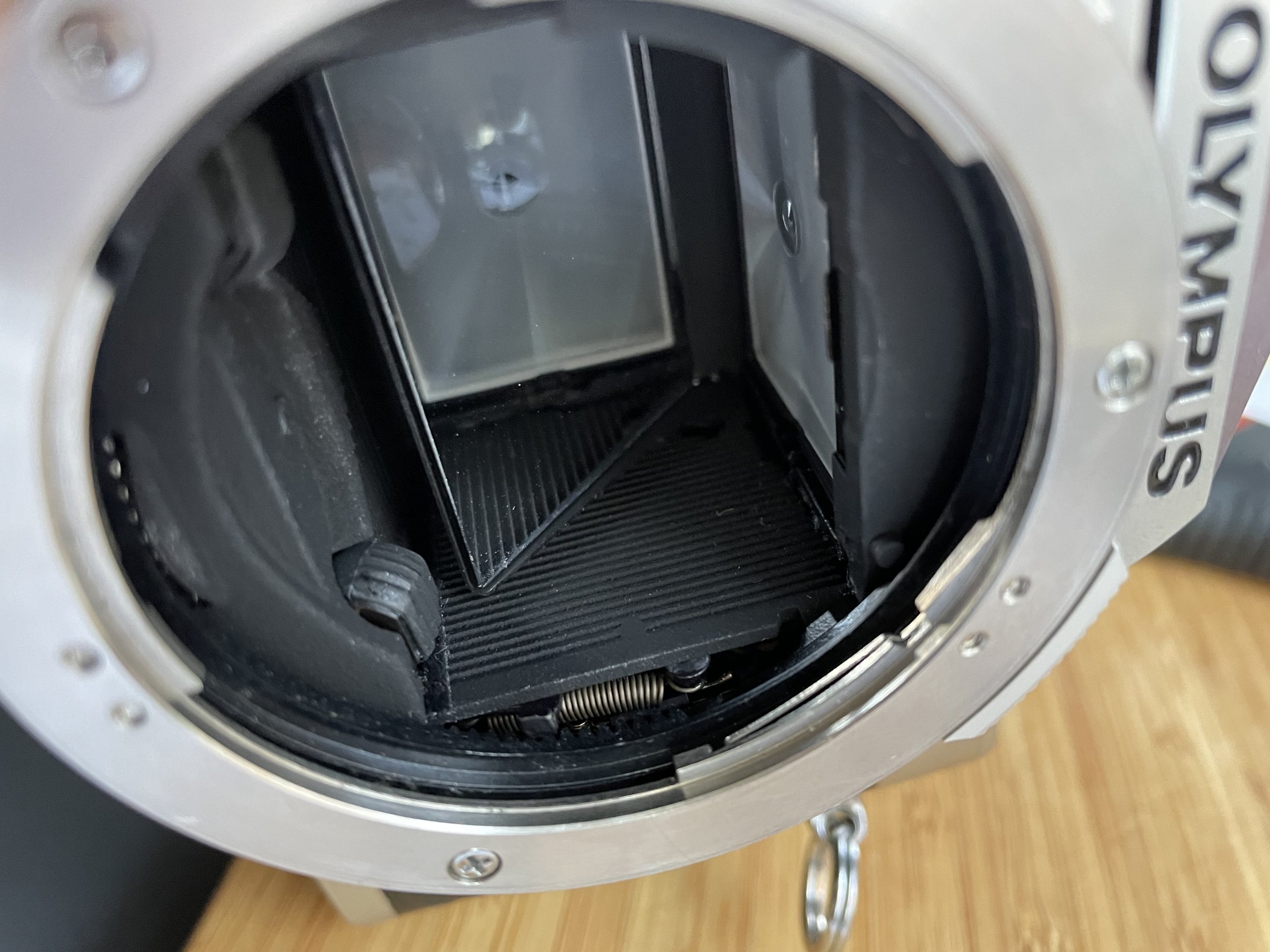

The mirror damper
![Inside the Olympus OM-2n camera's mirror mechanism.](https://valkyrie.cdn.ifixit.com/media/2020/12/23131810/IMG_0369-rotated.jpeg)
When you take a photo with an SLR or DSLR, the mirror flips up out of the way to let the light reach the film. The camera has a few foam pads that cushions the impact of the mirror against the top of the mirror box. This may reduce camera vibration, as well as protect the mirror. The exact position will vary between makes and models; in my camera there are four pads, two small squares, and two skinny rectangles. I’ve jacked up the exposure on this photo to show you.
![Olympus OM-2n mirror box, with damping pads highlighted.](https://valkyrie.cdn.ifixit.com/media/2020/12/23131856/IMG_0367-scaled.jpeg)
The camera is on its side. You see the mirror on the left, and the focusing screen on the right. That screen is found on the bottom of the pentaprism when the camera is upright.
I scraped out the old gunk, being super careful not to touch the focusing screen or the mirror. Cleaning the mirror is possible, but if you spoil the screen you’re screwed. Some, but not all, SLRs have replaceable screens.
Then I eyeballed the foam, cut it, and used pointed tweezers, and my faithful chopstick, to place them. It takes a steady hand, so don’t try this with a hangover.
After this was done, I blew out the dust with a blower bulb (don’t use canned air—it’s lazy, environmentally unsound, and way too harsh), cleaned up around the back, replaced the back, and closed it up. The foam puts up a little resistance against the rear door closing, but it latches shut nicely. A success, I hope.
