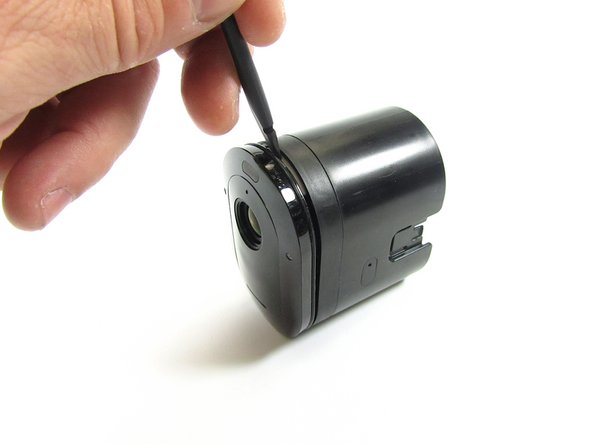

To open the Arlo Pro 3 Camera, press the Button on the bottom, and pull the Camera Face (Camera Body) away from the Camera Enclosure
Charging port for internal battery pack
Remove the Battery from the Camera Body by gently pulling the Battery away from the Camera Body
The Battery Capacity is 4800mAh
To remove the Camera Face Plate from the Camera Body, remove the four PH00 screws in the Battery Compartment area that secure the Camera Face Plate to the Camera Body
Use the Spudger Tool to pop off the Camera Faceplate
Once the Camera Face Plate has been removed, remove the small rubber gasket on the front with a Spudger Tool. At this point, we get the first look at the electronics that make of up the Arlo Pro 3 Security Camera

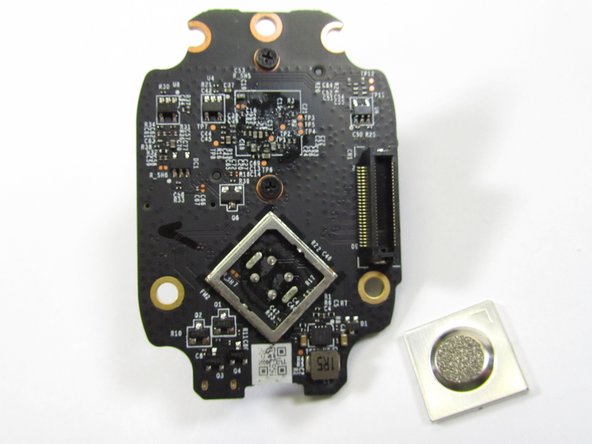

Once the Heatsink has been removed, the Top PCB can be inspected. The Top PCB has RF Shielding on both sides
The RF Shielding can be removed using a Dental Pick Took
Pro-tip, if the RF shielding has a small circle indention on it, there is a good chance the shield was snapped in place, and not soldered to the PCB, which makes it easier to remove
One side of the Top PCB appears to be Power and Audio. Three components were crossed on this PCB. One Part was located up under the RF shielding Frame
BQ25898 - I2C Controlled Single Cell 4-A Fast Charger with MaxChargeTM for High Input
TAS2560 - 5.6W Class-D Mono Audio Amplifier with IV Sense
DSP Group D2A3X - Audio DSP
