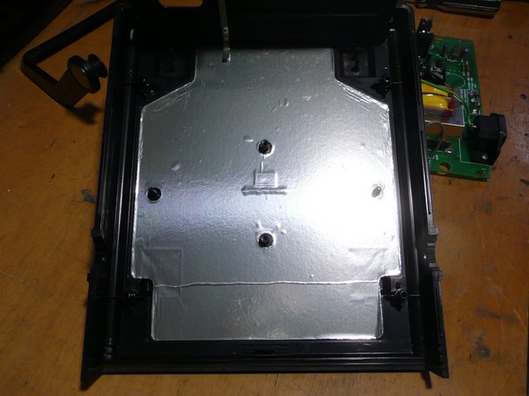

  3. BK Precision 3011B Teardown: Schritt 3, Bild 1 von 2 BK Precision 3011B Teardown: Schritt 3, Bild 2 von 2
    • Inside top cover of the function generator, you can see the shielding that they used.
    • Inside the bottom cover of the function generator, more shielding.

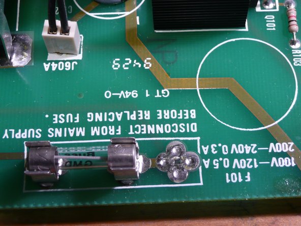

  4. BK Precision 3011B Teardown: Schritt 4, Bild 1 von 2 BK Precision 3011B Teardown: Schritt 4, Bild 2 von 2
    • One cool function of these function generators is how easy it is to switch from what input voltage to use. Moving to another country? Don't want to buy a power converter? Just open it up and change what prong the cable is connected to! Easy
    • They even have the appropriate fuse footprints for easy changing of fuses for different countries. The reason you see the "star" footprint to the right of the fuse is to accommodate the longer fuses, which I believe are for 240v, but I am not sure. I do know for sure that it is meant for longer fuses though.
