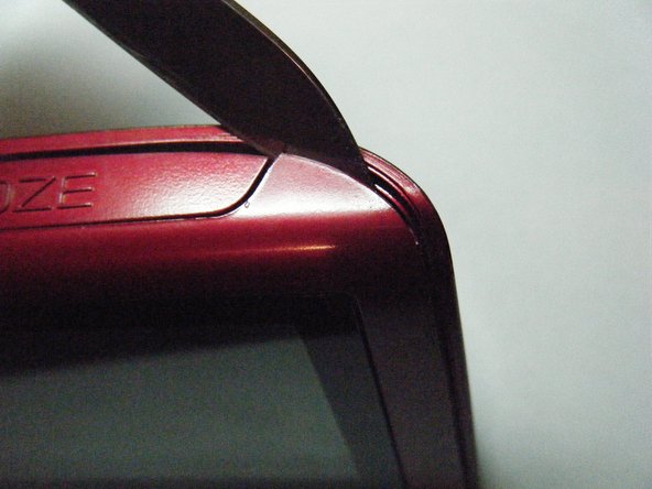

  3. Coby Digital Photo Frame Alarm Clock Teardown: Schritt 3, Bild 1 von 2 Coby Digital Photo Frame Alarm Clock Teardown: Schritt 3, Bild 2 von 2
    • After two outer case screws are removed, The two halves of the case can be easily snapped apart.

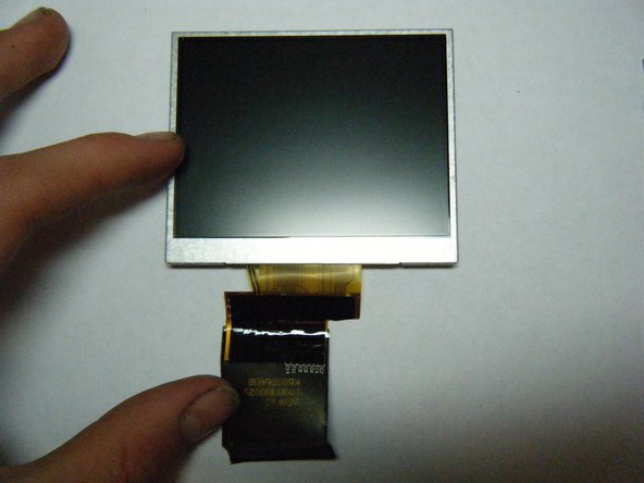

    • Yes! the LCD is not soldered on the logic board. It is held in by a ribbon cable connecter. It can easily be removed.
    • What a pain it would be to have it soldered in the logic board.

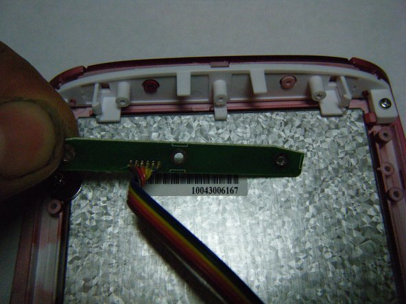

    • After taking out two screws, the inner snooze button comes out.
    • They are 2 buttons on this board, along with a few capacitors and resistors.

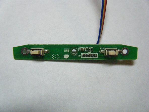

    • After removing the three screws holding down the control pad board, It can be easily lifted out.
    • On the other side of the board, just buttons.

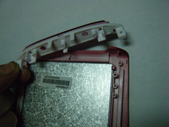

    • But before the LCD can be removed, the outer snooze button assembly has to come out. It is held on by two screws.

    • The LCD can finely be removed!
    • The screen quality and size is not too bad for the price I paid for it.
