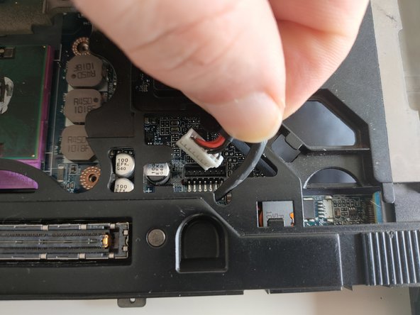

Disconnect the AC adapter by pulling power cable straight up.
