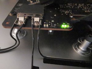

Kenn jemand die Bedeutung der LEDs? Bei diesem Model sind 5 Stück vorhanden.

LED 1
Zeigt an dass das Netzteil Strom hat und die Grundsätzliche versorgung anständig aufbaut.
LED 2
Zeigt an das der iMac eingeaschalten ist und läuft, also nicht im sleepmode ist.
LED 3
CPU wird erkannt und funktioniert.
LED 4
LCD ist an und funktioniert
LED 5
Ich “glaube”: Backlight ist an und funktioniert.

This is just to add clarification to the perfect answer by @spaeder
Diagnostic LEDs
LED 1
Indicates that the trickle voltage from the power supply has been detected by the main logic board. This LED will turn on when you connect the iMac to a working AC power source.
After disconnecting and reconnecting the AC power source, this LED could remain off:
If the AC power source is missing or disconnected.
If the logic board is disconnected from the power supply or the AC receptacle.
If the power supply board is faulty.
LED 2
Indicates that the computer is turned on. This LED will be on as long as the computer is turned on (but is not asleep) and the power supply and voltage regulators are working correctly.
LED 3
Indicates that the logic board and GPU are communicating. This LED will be on when the CPU is communicating properly with the GPU. If LEDs 1 and 2 are on and LED 3 is off, then the backup battery (on the back of the logic board) may need to be reseated or the logic board may need replacement.
LED 4
Indicates that the logic board and LCD panel are communicating. This LED will be on when the computer is turned on and a video signal is being generated. If LED 4 is on and there is no image on the display, then the LCD panel or the cables between the LCD and logic board might be installed incorrectly or need replacement.
LED 5
Indicates that the logic board and LCD panel are communicating. This LED is on when the computer is turned on, a video signal is being generated, and the LCD Panel is signaling to turn on the backlight. If LED 5 is ON and there is no image on the display, then the LCD backlight or circuitry on the logic board may be malfunctioning. The LCD panel or the cables or the logic board may need replacement.

LED Startup Sequence
LED 1 = Power is available.
If no LED is visible:
Disconnect the power cord from the computer and wait 15 seconds to reset the power supply and LED status.
Reconnect the power cord and check the LED status again.
Verify the AC source.
Verify that a known-good power cord is connected.
Verify the cable connection between the AC inlet and the power supply.
Verify the cable connection between the power supply and the logic board.
Verify the power supply.
LED 1 + LED 2 = Power is available and the system is turned on.
If the second LED is not visible when the power button is pressed:
Verify that the power button is connected to the power supply.
Verify power button functionality.
Verify the logic board.
LED 1 + LED 2 + LED 3 = Power is available, the system is turned on, and the GPU was found.
If the third LED is not visible after the system is turned on:
Verify whether the fan is running when turned on (reset SMC and NVRAM, verify backup battery voltage for proper startup).
If the fan is not heard, go to the “No Startup” troubleshooting flow.
LED 1 + LED 2 + LED 3 + LED 4 = Power is available, the system is turned on, the logic board is communicating with the GPU, and the internal LCD was found.
If the fourth LED is not visible after the system is turned on:
Verify the embedded DisplayPort cable (eDP) connections between the LCD panel and the logic board.
Inspect the LCD display cables for cable damage.
Verify external video functionality and proceed according to the result:
If an external display works, verify/replace the LCD panel.
If an external display does not work, verify/replace the logic board.
LED 1 + LED 2 + LED 3 + LED 4 + LED 5 = Power is available, system is turned on, GPU is working, logic board is communicating with the LCD panel, and the LCD panel has turned on the LCD backlight.
If the fifth LED is not visible after the computer is turned on:
Verify the eDP cable and backlight cable connections between the LCD panel and the logic board.
Using a flashlight, check the following areas on the panel:
Look in the top left corner of the panel to see if there is a dim Apple logo (the Apple menu logo).
Look in the center of the panel to see if there is a login screen.
Look at the bottom of the panel to see if there is a Dock visible.
If the following items are visible, there may be something wrong with the display cables or the logic board.
Proceed to the next step.
Replace the LCD panel, check that all the LEDs are visible, and that backlight functions. If the computer does not function after replacing the LCD panel, replace the logic board.
