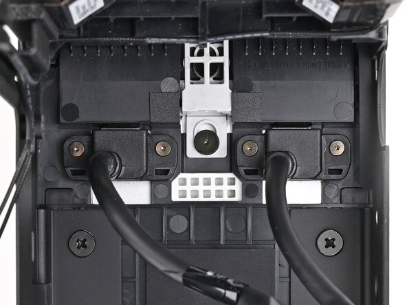

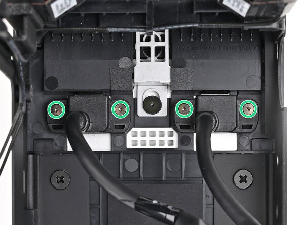

  35. Framework Desktop Expansion Card Cables Replacement, Loosen the Expansion Card cable screws: Schritt 35, Bild 1 von 2 Framework Desktop Expansion Card Cables Replacement, Loosen the Expansion Card cable screws: Schritt 35, Bild 2 von 2
    • Use your Framework Desktop Screwdriver to loosen the four captive T5 Torx screws securing the two Expansion Card cables.

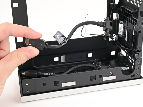

  36. Framework Desktop Expansion Card Cables Replacement, Remove the Expansion Card cables: Schritt 36, Bild 1 von 2 Framework Desktop Expansion Card Cables Replacement, Remove the Expansion Card cables: Schritt 36, Bild 2 von 2
    • Lift the Expansion Card cables out of the Desktop and remove them.

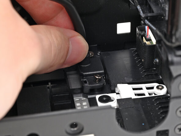

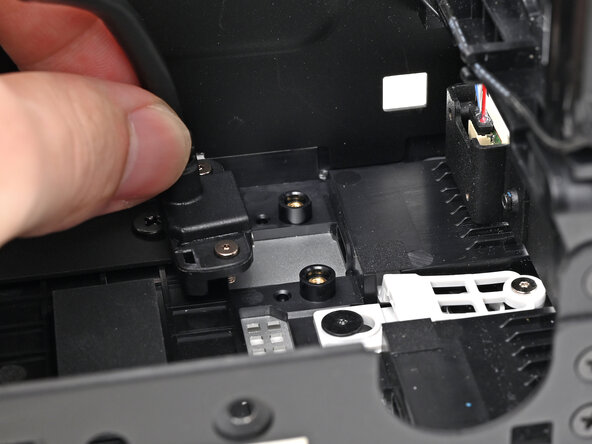

  38. Framework Desktop Expansion Card Cables Replacement, Place the Expansion Card cables: Schritt 38, Bild 1 von 2 Framework Desktop Expansion Card Cables Replacement, Place the Expansion Card cables: Schritt 38, Bild 2 von 2
    • Insert the the Expansion Card cable into its slot and align it over its two screw pegs.
    • Repeat for the other Expansion Card cable.
  39. Framework Desktop Expansion Card Cables Replacement, Install the Expansion Card cable screws: Schritt 39, Bild 1 von 1
    • Use your Framework Desktop Screwdriver to install the four captive T5 Torx screws securing the two Expansion Card cables.
