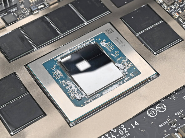

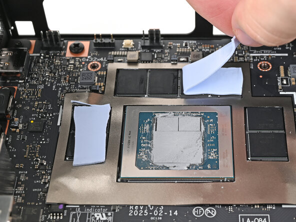

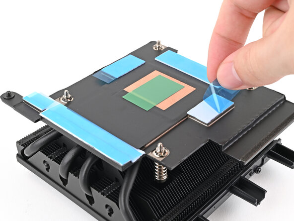

  16. Framework Desktop Heatsink Replacement, Thermal pad information: Schritt 16, Bild 1 von 2 Framework Desktop Heatsink Replacement, Thermal pad information: Schritt 16, Bild 2 von 2
    • There are two types of thermal pads in the Desktop:
    • One thin, grey pad covering the back of the APU
    • Four thicker, blue pads covering the memory and power management
    • Upon removing the heatsink, the thicker pads will stick to either the bottom of the heatsink or to the Mainboard. Since replacement heatsinks come with pre-installed thermal pads, you just need to clean off the pads that remain on the Mainboard.
    • Follow the next two steps to remove the thermal pads remaining on the Mainboard.

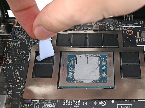

  17. Framework Desktop Heatsink Replacement, Remove the thermal pads: Schritt 17, Bild 1 von 2 Framework Desktop Heatsink Replacement, Remove the thermal pads: Schritt 17, Bild 2 von 2
    • Use your fingers to peel off the thermal pads from the memory and power management.

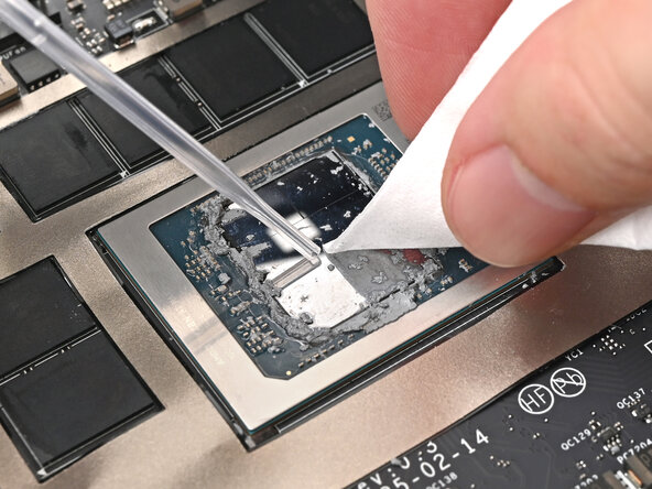

  18. Framework Desktop Heatsink Replacement, Clean the APU: Schritt 18, Bild 1 von 2 Framework Desktop Heatsink Replacement, Clean the APU: Schritt 18, Bild 2 von 2
    • Apply a few drops of isopropyl alcohol (>90%) to the APU and use a coffee filter or a lint-free cloth to wipe away any residue.

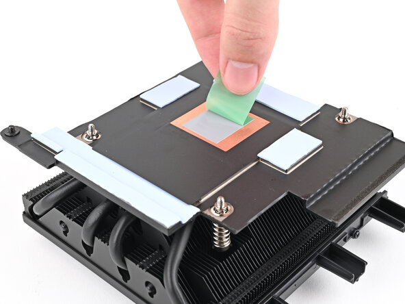

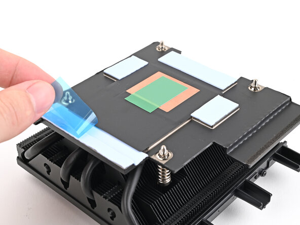

  20. Framework Desktop Heatsink Replacement, Remove the liners: Schritt 20, Bild 1 von 3 Framework Desktop Heatsink Replacement, Remove the liners: Schritt 20, Bild 2 von 3 Framework Desktop Heatsink Replacement, Remove the liners: Schritt 20, Bild 3 von 3
    • Remove the liners covering the thermal pads on your replacement heatsink.
