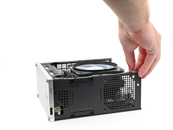

  2. Framework Desktop Power Button Board Replacement, Remove the Left Panel: Schritt 2, Bild 1 von 3 Framework Desktop Power Button Board Replacement, Remove the Left Panel: Schritt 2, Bild 2 von 3 Framework Desktop Power Button Board Replacement, Remove the Left Panel: Schritt 2, Bild 3 von 3
    • Use your fingers to grip the top of the Left Panel and slide it upward to release its clips.
    • Remove the Left Panel.

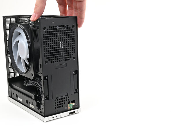

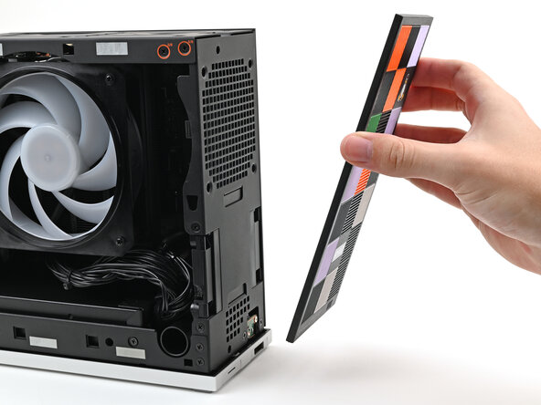

  3. Framework Desktop Power Button Board Replacement, Remove the Right Panel: Schritt 3, Bild 1 von 3 Framework Desktop Power Button Board Replacement, Remove the Right Panel: Schritt 3, Bild 2 von 3 Framework Desktop Power Button Board Replacement, Remove the Right Panel: Schritt 3, Bild 3 von 3
    • Use your fingers to grip the top of the Right Panel and slide it upward to release its clips.
    • Remove the Right Panel.

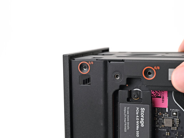

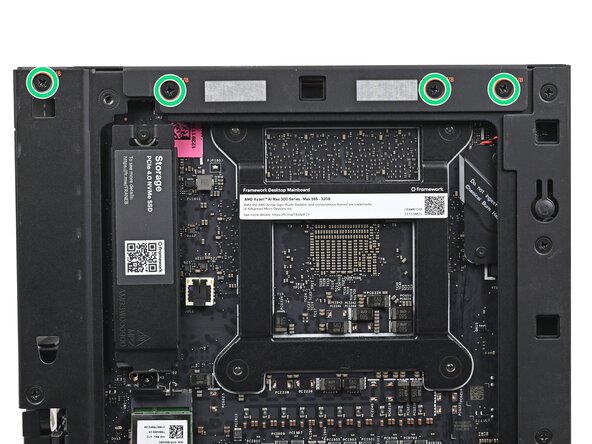

  5. Framework Desktop Power Button Board Replacement, Remove the top plate screws: Schritt 5, Bild 1 von 2 Framework Desktop Power Button Board Replacement, Remove the top plate screws: Schritt 5, Bild 2 von 2
    • While holding the Desktop steady, use your Framework Desktop Screwdriver to remove the eight 4.0 mm‑long Phillips screws securing the top plate.

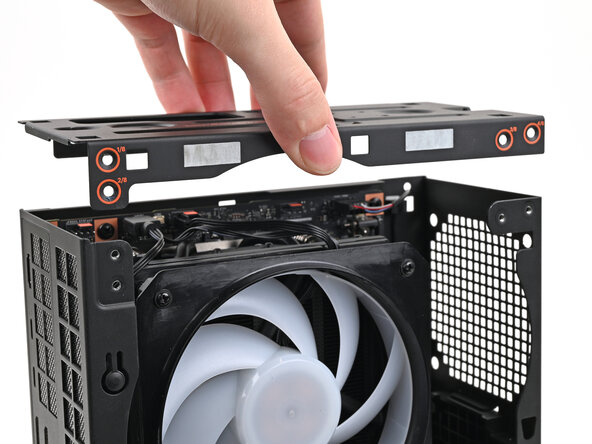

  6. Framework Desktop Power Button Board Replacement, Remove the top plate: Schritt 6, Bild 1 von 2 Framework Desktop Power Button Board Replacement, Remove the top plate: Schritt 6, Bild 2 von 2
    • Lift the top plate off the Desktop and remove it.

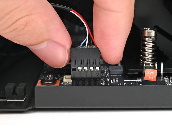

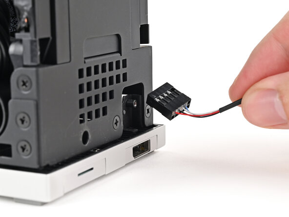

  8. Framework Desktop Power Button Board Replacement, Disconnect the power button: Schritt 8, Bild 1 von 2 Framework Desktop Power Button Board Replacement, Disconnect the power button: Schritt 8, Bild 2 von 2
    • Use your fingers to lift the power button cable connector off its nine‑pronged socket on the Mainboard.

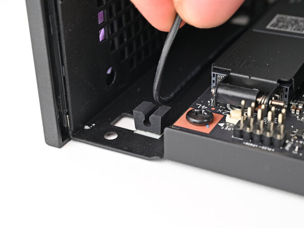

  9. Framework Desktop Power Button Board Replacement, Reroute the power button cable: Schritt 9, Bild 1 von 2 Framework Desktop Power Button Board Replacement, Reroute the power button cable: Schritt 9, Bild 2 von 2
    • Pull the power button cable out of its rubber clips in the chassis.

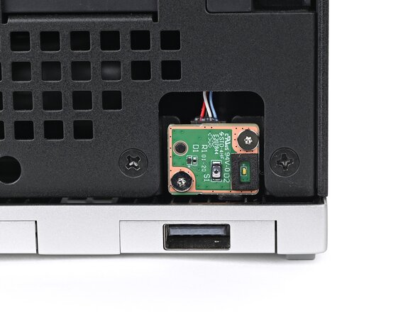

  11. Framework Desktop Power Button Board Replacement, Remove the Power Button Board screws: Schritt 11, Bild 1 von 2 Framework Desktop Power Button Board Replacement, Remove the Power Button Board screws: Schritt 11, Bild 2 von 2
    • Use your Framework Desktop Screwdriver to remove the two 4.5 mm‑long screws securing the Power Button Board.

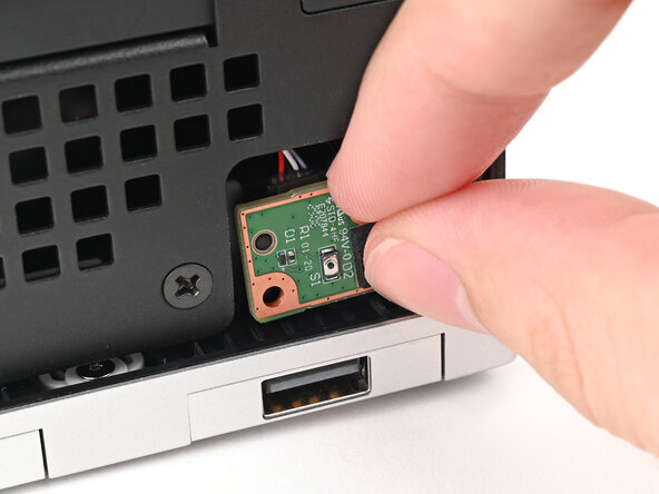

  12. Framework Desktop Power Button Board Replacement, Reposition the Power Button Board: Schritt 12, Bild 1 von 2 Framework Desktop Power Button Board Replacement, Reposition the Power Button Board: Schritt 12, Bild 2 von 2
    • Use your finger to pull the Power Button Board off its alignment peg.

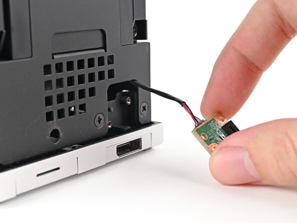

  13. Framework Desktop Power Button Board Replacement, Remove the Power Button Board: Schritt 13, Bild 1 von 3 Framework Desktop Power Button Board Replacement, Remove the Power Button Board: Schritt 13, Bild 2 von 3 Framework Desktop Power Button Board Replacement, Remove the Power Button Board: Schritt 13, Bild 3 von 3
    • Pull the Power Button Board away from the Desktop, threading its cable through the chassis.

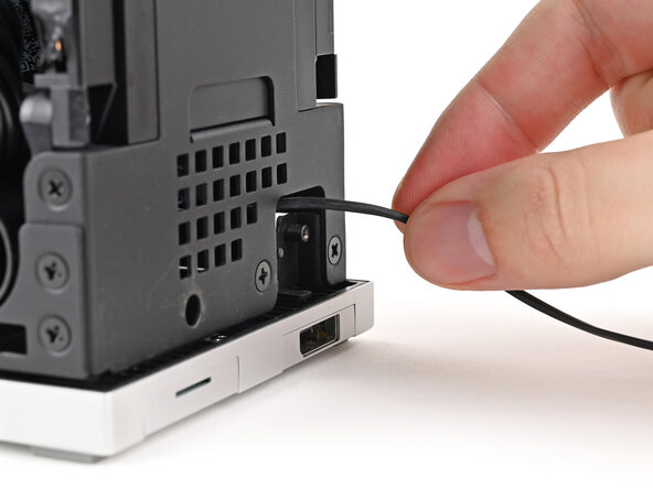

  15. Framework Desktop Power Button Board Replacement, Place the Power Button Board: Schritt 15, Bild 1 von 3 Framework Desktop Power Button Board Replacement, Place the Power Button Board: Schritt 15, Bild 2 von 3 Framework Desktop Power Button Board Replacement, Place the Power Button Board: Schritt 15, Bild 3 von 3

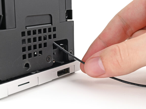

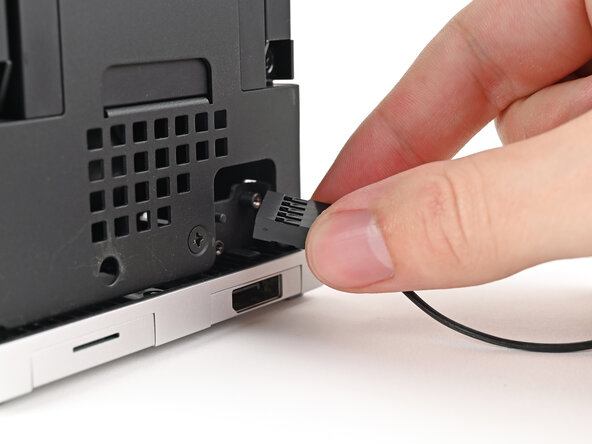

    • Insert the Power Button Board cable into the slot in the Desktop.
    • Grip the cable from the top of the Desktop and thread it through the chassis.
  16. Framework Desktop Power Button Board Replacement, Reposition the Power Button Board: Schritt 16, Bild 1 von 2 Framework Desktop Power Button Board Replacement, Reposition the Power Button Board: Schritt 16, Bild 2 von 2
    • Place the board into its slot in the Desktop so the alignment peg is threaded through its hole in the board.
  17. Framework Desktop Power Button Board Replacement, Install the Power Button Board screws: Schritt 17, Bild 1 von 2 Framework Desktop Power Button Board Replacement, Install the Power Button Board screws: Schritt 17, Bild 2 von 2
    • Use your Framework Desktop Screwdriver to install the two 4.5 mm‑long screws securing the Power Button Board.

  19. Framework Desktop Power Button Board Replacement, Reroute the power button cable: Schritt 19, Bild 1 von 2 Framework Desktop Power Button Board Replacement, Reroute the power button cable: Schritt 19, Bild 2 von 2
    • Press the power button cable into its rubber clips in the chassis.

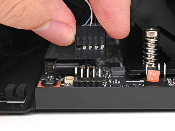

  20. Framework Desktop Power Button Board Replacement, Connect the power button: Schritt 20, Bild 1 von 2 Framework Desktop Power Button Board Replacement, Connect the power button: Schritt 20, Bild 2 von 2
    • Slide the power button cable over the nine-pronged connector on the Mainboard.

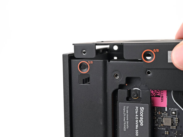

  22. Framework Desktop Power Button Board Replacement, Place the top plate: Schritt 22, Bild 1 von 2 Framework Desktop Power Button Board Replacement, Place the top plate: Schritt 22, Bild 2 von 2
    • Place the top plate on top of the Desktop, making sure it slots into the chassis so the orange circles are visible.
  23. Framework Desktop Power Button Board Replacement: Schritt 23, Bild 1 von 2 Framework Desktop Power Button Board Replacement: Schritt 23, Bild 2 von 2
    • Make sure the matching screw hole on the top plate labeled "5/8" is slotted on the inside of the Chassis so that the orange circle is visible.
  24. Framework Desktop Power Button Board Replacement, Install the top plate screws: Schritt 24, Bild 1 von 2 Framework Desktop Power Button Board Replacement, Install the top plate screws: Schritt 24, Bild 2 von 2
    • While holding the Desktop steady, use your Framework Desktop Screwdriver to install the eight 4.0 mm‑long Phillips screws securing the top plate.

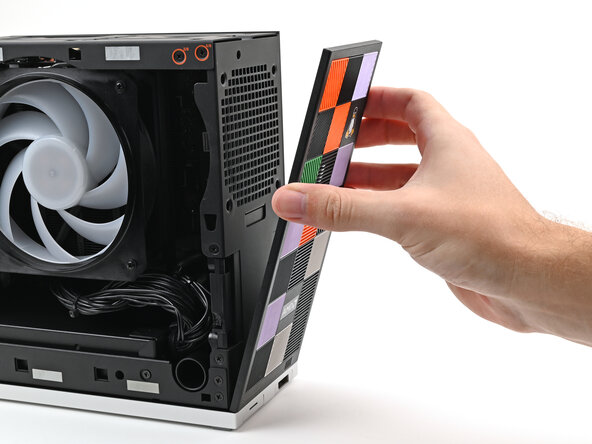

  27. Framework Desktop Power Button Board Replacement, Install the Left Panel: Schritt 27, Bild 1 von 3 Framework Desktop Power Button Board Replacement, Install the Left Panel: Schritt 27, Bild 2 von 3 Framework Desktop Power Button Board Replacement, Install the Left Panel: Schritt 27, Bild 3 von 3
    • Slide the Left Panel onto the left edge of the chassis and press it flat to ensure its clips are slotted into place.
    • There should be a small gap between the bottom of the Left Panel and the silver base.
    • Push the Left Panel towards the base of the computer to close the gap and engage the clips.
