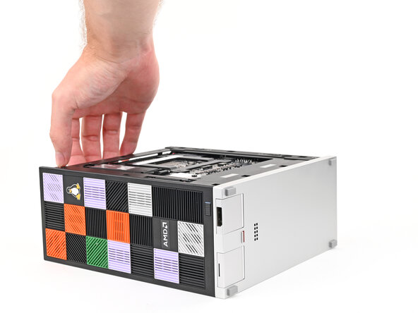

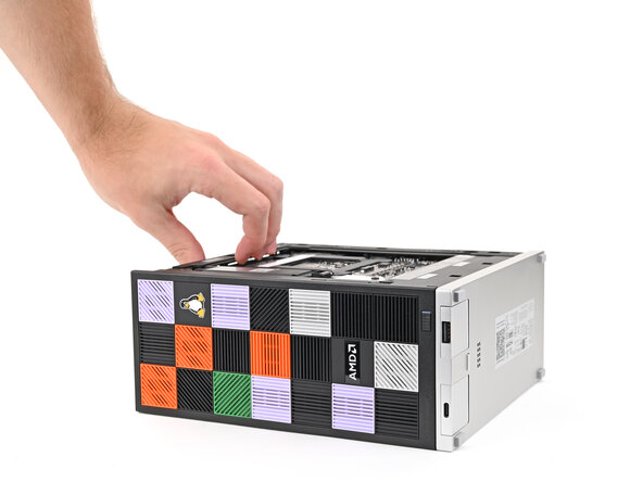

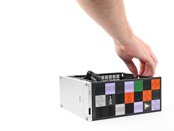

  6. Framework Desktop Power Supply Duct Replacement, Remove the Top Panel: Schritt 6, Bild 1 von 3 Framework Desktop Power Supply Duct Replacement, Remove the Top Panel: Schritt 6, Bild 2 von 3 Framework Desktop Power Supply Duct Replacement, Remove the Top Panel: Schritt 6, Bild 3 von 3
    • Slide the Top Panel towards the rear of the computer to release the clips securing it to the chassis.
    • If you're having a hard time gripping the Top Panel, use the screw holes to get a better handhold.
    • Lift the Top Panel off the chassis and remove it.

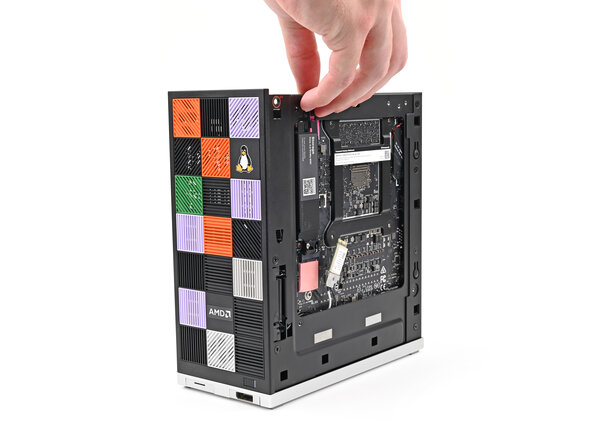

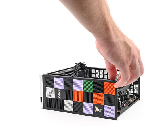

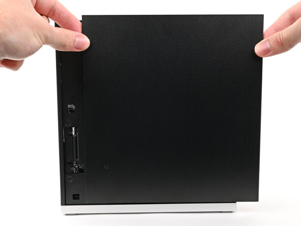

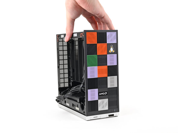

  7. Framework Desktop Power Supply Duct Replacement, Remove the Left Panel: Schritt 7, Bild 1 von 3 Framework Desktop Power Supply Duct Replacement, Remove the Left Panel: Schritt 7, Bild 2 von 3 Framework Desktop Power Supply Duct Replacement, Remove the Left Panel: Schritt 7, Bild 3 von 3
    • Use your fingers to grip the top of the Left Panel and slide it upward to release its clips.
    • Remove the Left Panel.

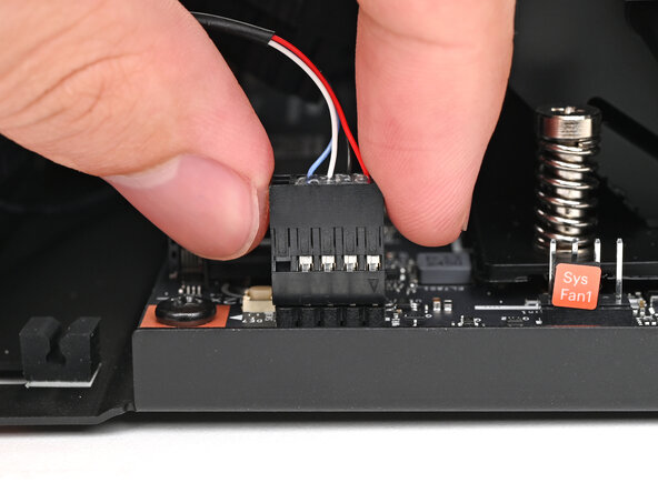

  9. Framework Desktop Power Supply Duct Replacement, Disconnect the fan: Schritt 9, Bild 1 von 2 Framework Desktop Power Supply Duct Replacement, Disconnect the fan: Schritt 9, Bild 2 von 2
    • Use your fingers to lift the APU fan cable connector off its four‑pronged socket on the Mainboard.

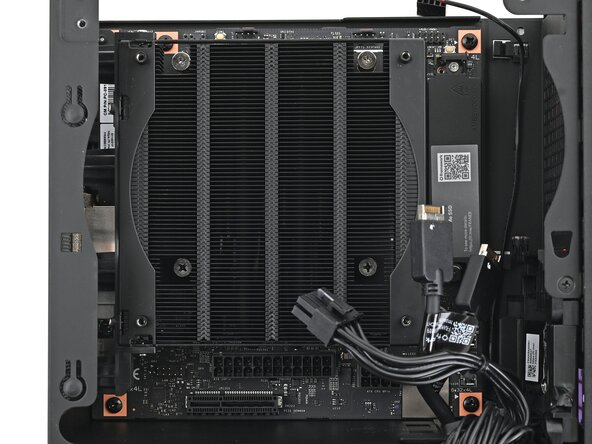

  11. Framework Desktop Power Supply Duct Replacement, Remove the CPU fan screws: Schritt 11, Bild 1 von 2 Framework Desktop Power Supply Duct Replacement, Remove the CPU fan screws: Schritt 11, Bild 2 von 2
    • Use your Framework Desktop Screwdriver to remove the four 27.3 mm‑long Phillips screws securing the CPU fan and fan duct.
  12. Framework Desktop Power Supply Duct Replacement, Remove the fan duct: Schritt 12, Bild 1 von 2 Framework Desktop Power Supply Duct Replacement, Remove the fan duct: Schritt 12, Bild 2 von 2
    • Lift the fan duct off the fan and remove it.
  13. Framework Desktop Power Supply Duct Replacement, Remove the fan: Schritt 13, Bild 1 von 3 Framework Desktop Power Supply Duct Replacement, Remove the fan: Schritt 13, Bild 2 von 3 Framework Desktop Power Supply Duct Replacement, Remove the fan: Schritt 13, Bild 3 von 3
    • Lift the fan out of the chassis, making sure the cables thread through the side of the heatsink.

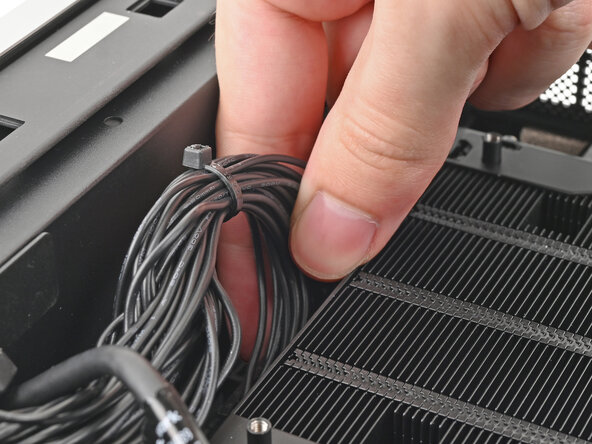

  14. Framework Desktop Power Supply Duct Replacement, Disconnect the top Expansion Card cable: Schritt 14, Bild 1 von 2 Framework Desktop Power Supply Duct Replacement, Disconnect the top Expansion Card cable: Schritt 14, Bild 2 von 2
    • Pull the top Expansion Card connector straight out of its socket in the Mainboard to disconnect it.

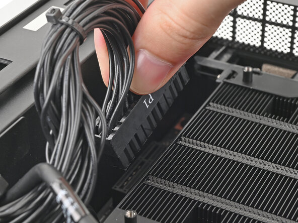

  15. Framework Desktop Power Supply Duct Replacement, Disconnect the main power cable: Schritt 15, Bild 1 von 2 Framework Desktop Power Supply Duct Replacement, Disconnect the main power cable: Schritt 15, Bild 2 von 2
    • While squeezing the clip on the main power cable, pull it straight up and out of its socket to disconnect it.

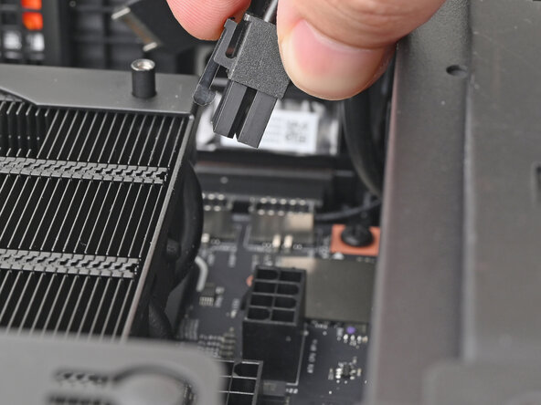

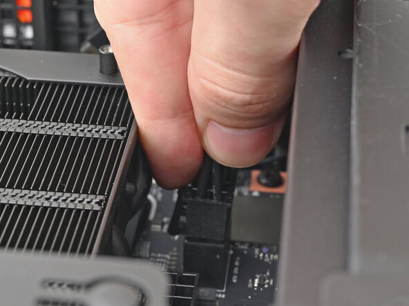

  16. Framework Desktop Power Supply Duct Replacement, Disconnect the CPU power cable: Schritt 16, Bild 1 von 2 Framework Desktop Power Supply Duct Replacement, Disconnect the CPU power cable: Schritt 16, Bild 2 von 2
    • While squeezing the clip on the CPU power cable, pull it straight up and out of its socket to disconnect it.
  17. Framework Desktop Power Supply Duct Replacement, Disconnect the bottom Expansion Card cable: Schritt 17, Bild 1 von 2 Framework Desktop Power Supply Duct Replacement, Disconnect the bottom Expansion Card cable: Schritt 17, Bild 2 von 2
    • Pull the bottom Expansion Card connector straight out of its socket in the Mainboard to disconnect it.

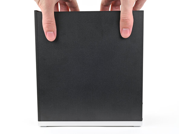

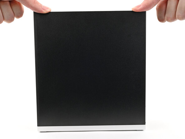

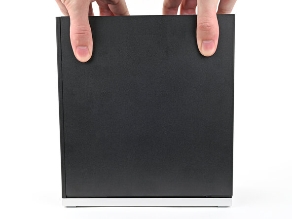

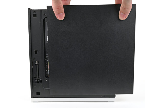

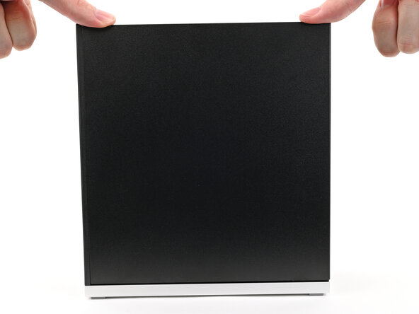

  19. Framework Desktop Power Supply Duct Replacement, Remove the Right Panel: Schritt 19, Bild 1 von 3 Framework Desktop Power Supply Duct Replacement, Remove the Right Panel: Schritt 19, Bild 2 von 3 Framework Desktop Power Supply Duct Replacement, Remove the Right Panel: Schritt 19, Bild 3 von 3
    • Use your fingers to grip the top of the Right Panel and slide it upward to release its clips.
    • Remove the Right Panel.

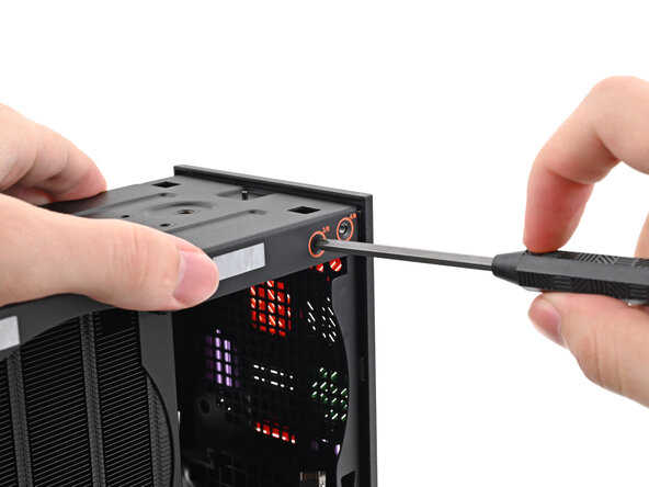

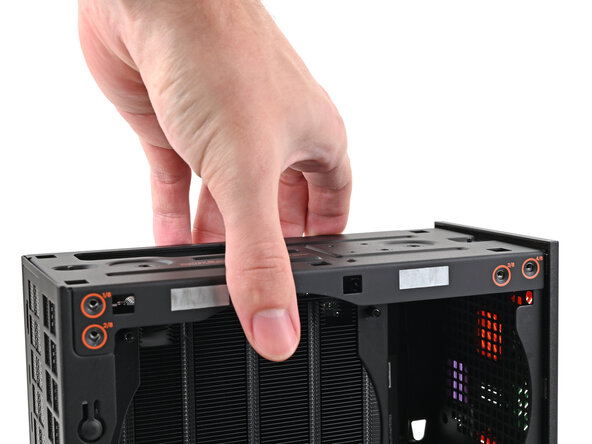

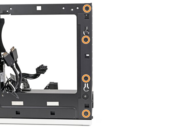

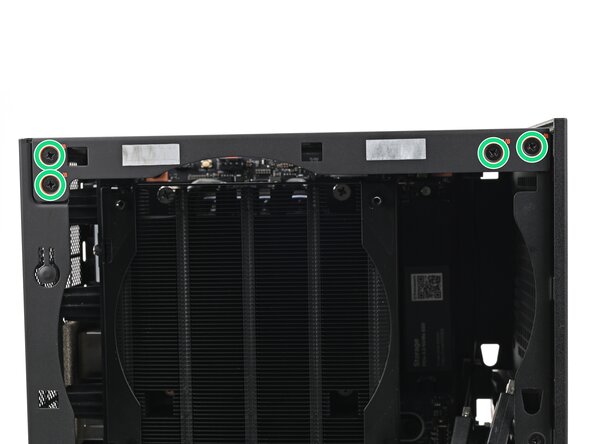

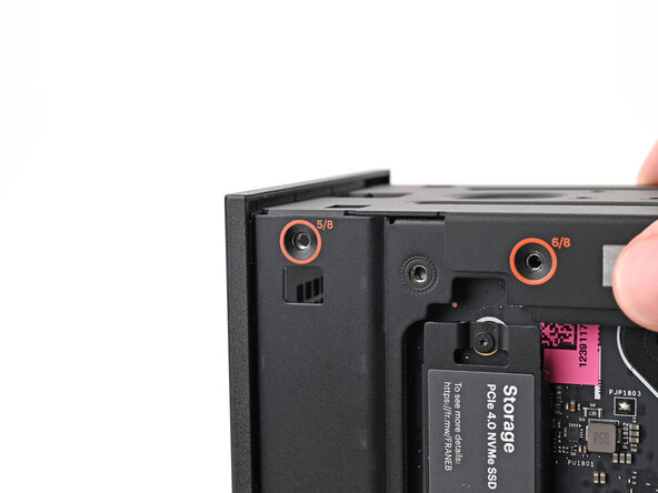

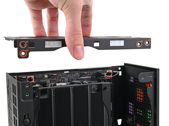

  20. Framework Desktop Power Supply Duct Replacement, Remove the top plate screws: Schritt 20, Bild 1 von 3 Framework Desktop Power Supply Duct Replacement, Remove the top plate screws: Schritt 20, Bild 2 von 3 Framework Desktop Power Supply Duct Replacement, Remove the top plate screws: Schritt 20, Bild 3 von 3
    • While holding the Desktop steady, use your Framework Desktop Screwdriver to remove the eight 4.0 mm‑long Phillips screws securing the top plate.

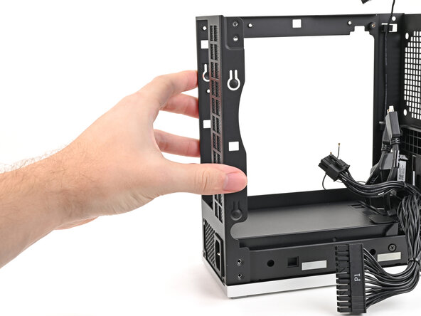

  21. Framework Desktop Power Supply Duct Replacement, Remove the top plate: Schritt 21, Bild 1 von 2 Framework Desktop Power Supply Duct Replacement, Remove the top plate: Schritt 21, Bild 2 von 2
    • Lift the top plate off the Desktop and remove it.

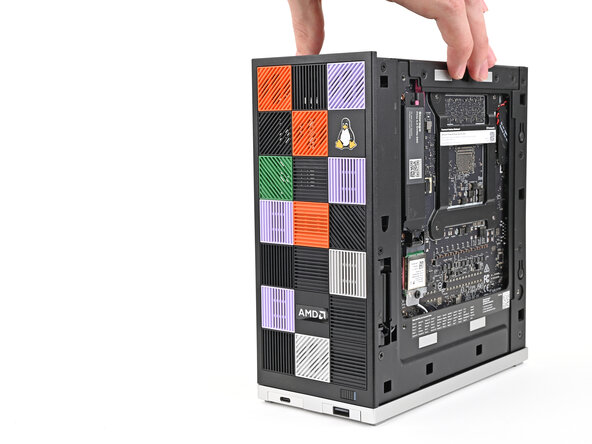

  22. Framework Desktop Power Supply Duct Replacement, Reposition the Desktop: Schritt 22, Bild 1 von 2 Framework Desktop Power Supply Duct Replacement, Reposition the Desktop: Schritt 22, Bild 2 von 2
    • Lay the left side of the Desktop on your work surface so the underside of the Mainboard is facing upward.

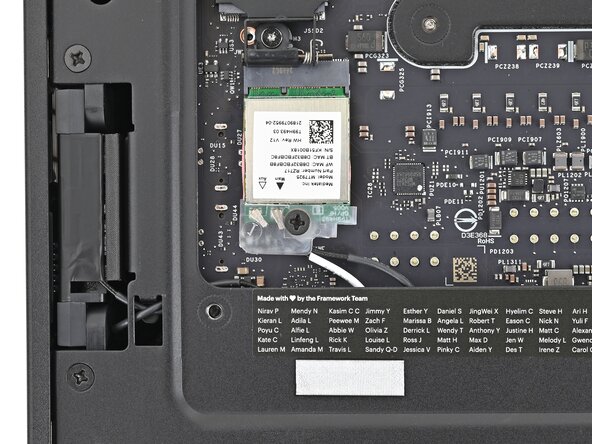

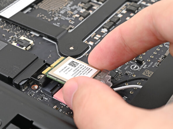

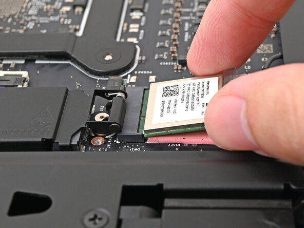

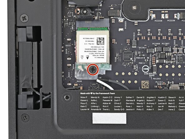

  23. Framework Desktop Power Supply Duct Replacement, Remove the Wi-Fi Module screw: Schritt 23, Bild 1 von 2 Framework Desktop Power Supply Duct Replacement, Remove the Wi-Fi Module screw: Schritt 23, Bild 2 von 2
    • Use your Framework Desktop Screwdriver to remove the 7.0 mm‑long Phillips screw securing the Wi-Fi module.

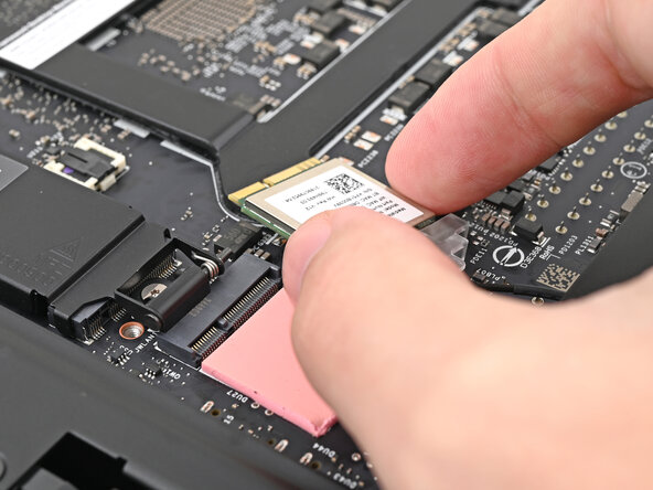

  24. Framework Desktop Power Supply Duct Replacement, Disconnect the Wi-Fi module: Schritt 24, Bild 1 von 2 Framework Desktop Power Supply Duct Replacement, Disconnect the Wi-Fi module: Schritt 24, Bild 2 von 2
    • Grip the Wi-Fi module by its edges and pull it straight out of its socket.
  25. Framework Desktop Power Supply Duct Replacement, Reposition the Wi-Fi module: Schritt 25, Bild 1 von 3 Framework Desktop Power Supply Duct Replacement, Reposition the Wi-Fi module: Schritt 25, Bild 2 von 3 Framework Desktop Power Supply Duct Replacement, Reposition the Wi-Fi module: Schritt 25, Bild 3 von 3
    • Move the Wi-Fi module towards the center of the Mainboard to keep it out of the way.

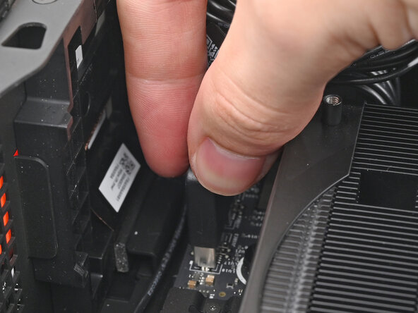

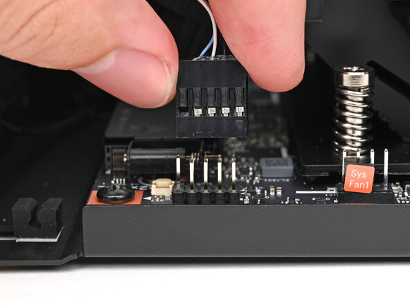

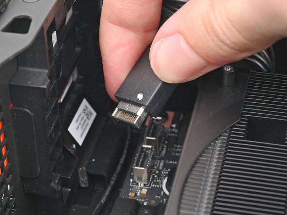

  27. Framework Desktop Power Supply Duct Replacement, Disconnect the power button: Schritt 27, Bild 1 von 2 Framework Desktop Power Supply Duct Replacement, Disconnect the power button: Schritt 27, Bild 2 von 2
    • Use your fingers to lift the power button cable connector off its nine‑pronged socket on the Mainboard.

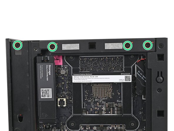

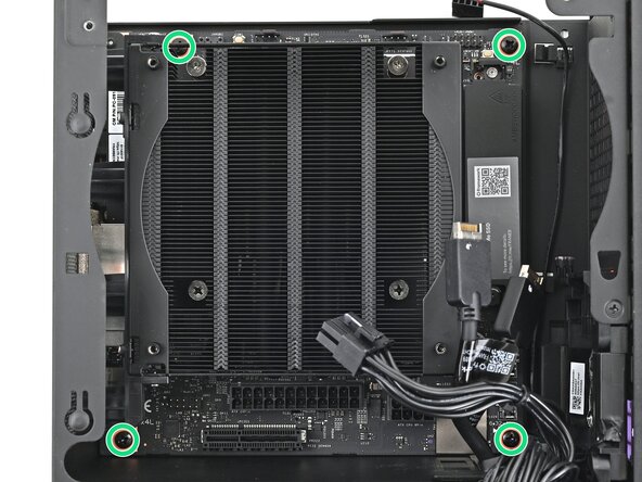

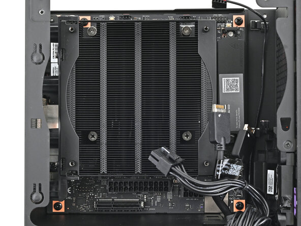

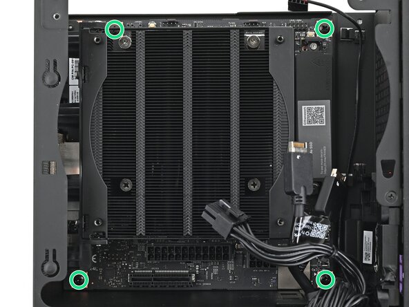

  28. Framework Desktop Power Supply Duct Replacement, Remove the Mainboard screws: Schritt 28, Bild 1 von 2 Framework Desktop Power Supply Duct Replacement, Remove the Mainboard screws: Schritt 28, Bild 2 von 2
    • Use your Framework Desktop Screwdriver to remove the four 8.2 mm‑long Phillips screws securing the Mainboard.

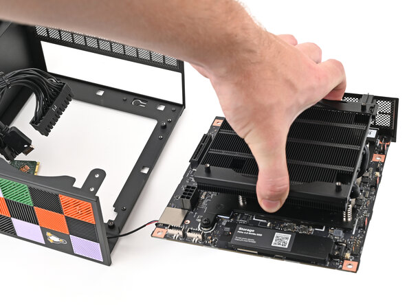

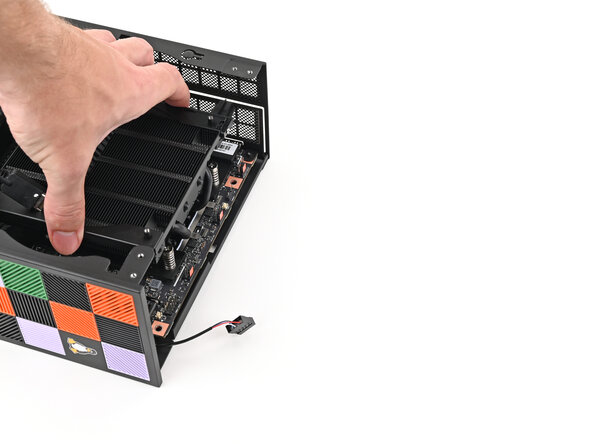

  29. Framework Desktop Power Supply Duct Replacement, Remove the Mainboard: Schritt 29, Bild 1 von 3 Framework Desktop Power Supply Duct Replacement, Remove the Mainboard: Schritt 29, Bild 2 von 3 Framework Desktop Power Supply Duct Replacement, Remove the Mainboard: Schritt 29, Bild 3 von 3
    • Grab the Mainboard by its heatsink and pull it towards the front of the Desktop to slide it out of the rear port cutout.
    • Slide the Mainboard towards the top of the Desktop to remove it from the chassis.

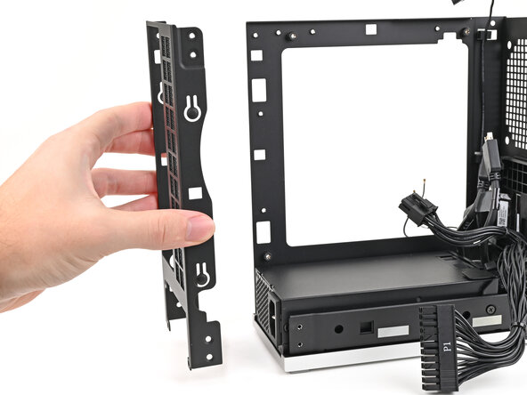

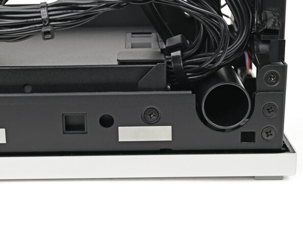

  30. Framework Desktop Power Supply Duct Replacement, Remove the rear plate screws: Schritt 30, Bild 1 von 3 Framework Desktop Power Supply Duct Replacement, Remove the rear plate screws: Schritt 30, Bild 2 von 3 Framework Desktop Power Supply Duct Replacement, Remove the rear plate screws: Schritt 30, Bild 3 von 3
    • Use your Framework Desktop Screwdriver to remove the three 5.9 mm‑long Phillips screws securing the power supply.
    • Optionally, you can remove the six 4.0 mm‑long screws securing the rear plate to make removing the power supply easier.
    • If you don't remove the rear plate screws, skip the next step.
  31. Framework Desktop Power Supply Duct Replacement, Remove the rear plate: Schritt 31, Bild 1 von 2 Framework Desktop Power Supply Duct Replacement, Remove the rear plate: Schritt 31, Bild 2 von 2
    • Pull the rear plate off the back of the Desktop and remove it.

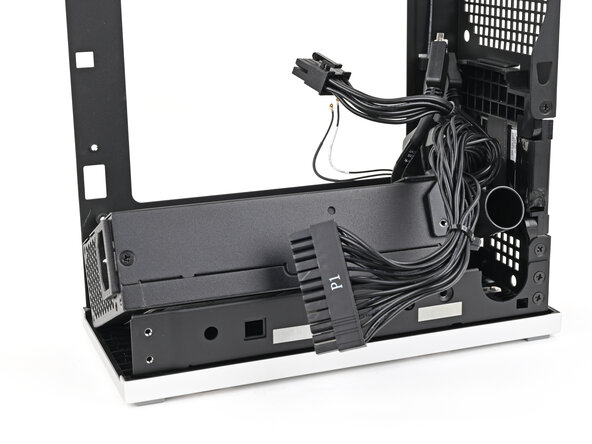

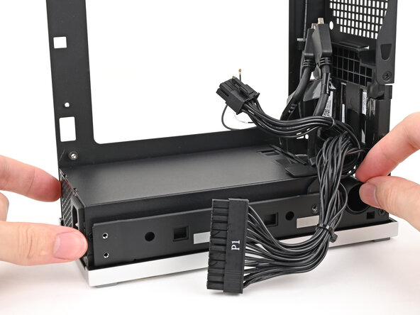

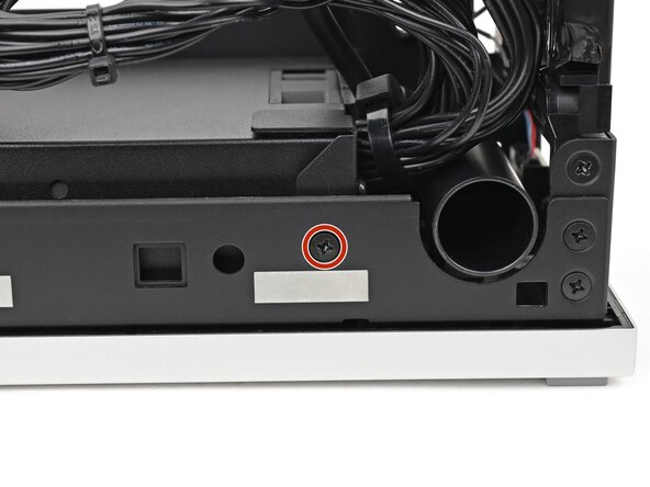

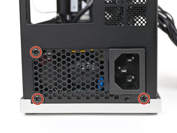

  32. Framework Desktop Power Supply Duct Replacement, Remove the power supply screw: Schritt 32, Bild 1 von 2 Framework Desktop Power Supply Duct Replacement, Remove the power supply screw: Schritt 32, Bild 2 von 2
    • Use your Framework Desktop Screwdriver to remove the 4.0 mm‑long Phillips screw securing the power supply.

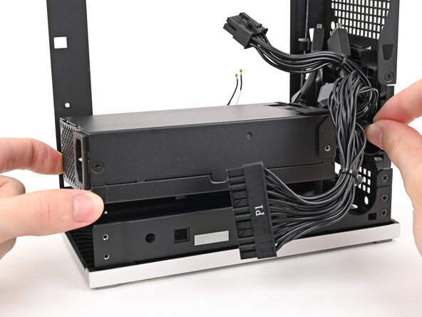

  33. Framework Desktop Power Supply Duct Replacement, Reposition the power supply: Schritt 33, Bild 1 von 3 Framework Desktop Power Supply Duct Replacement, Reposition the power supply: Schritt 33, Bild 2 von 3 Framework Desktop Power Supply Duct Replacement, Reposition the power supply: Schritt 33, Bild 3 von 3
    • Lift the power supply out of its slot and let it rest on the left side of the Desktop.

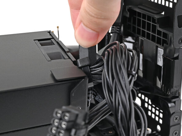

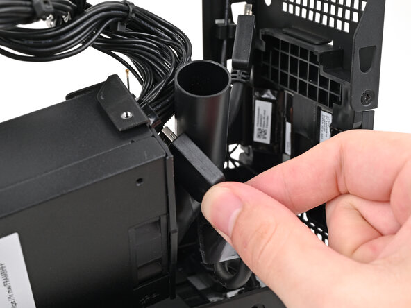

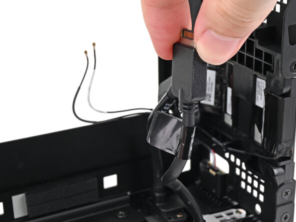

  34. Framework Desktop Power Supply Duct Replacement, Remove the power supply: Schritt 34, Bild 1 von 3 Framework Desktop Power Supply Duct Replacement, Remove the power supply: Schritt 34, Bild 2 von 3 Framework Desktop Power Supply Duct Replacement, Remove the power supply: Schritt 34, Bild 3 von 3
    • Push the right Expansion Card cable through the gap between the power supply and its duct.
    • The gap is very small and might require some force to thread the cable through.
    • Remove the power supply.

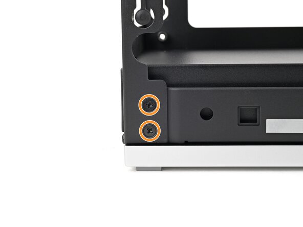

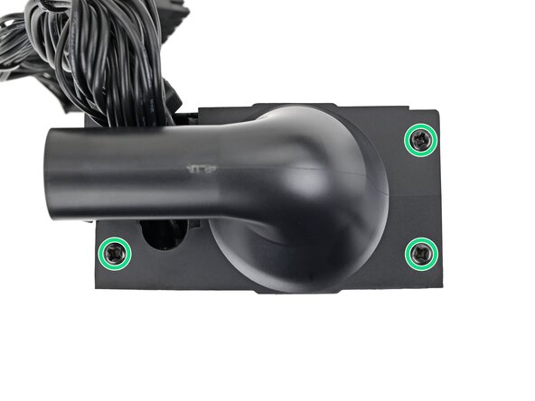

  35. Framework Desktop Power Supply Duct Replacement, Remove the Power Supply Duct screws: Schritt 35, Bild 1 von 2 Framework Desktop Power Supply Duct Replacement, Remove the Power Supply Duct screws: Schritt 35, Bild 2 von 2
    • Use your Framework Desktop Screwdriver to remove the three 5.8 mm‑long Phillips screws securing the Power Supply Duct.

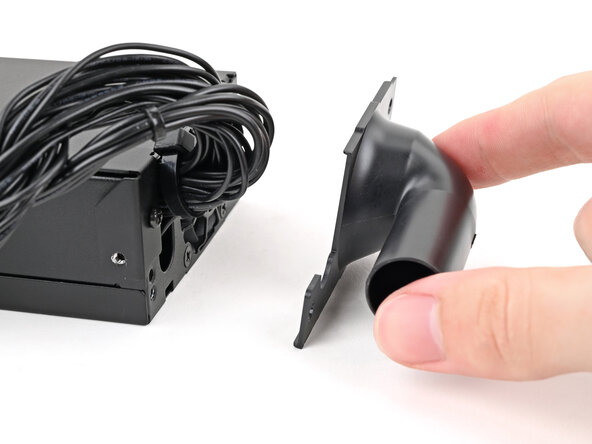

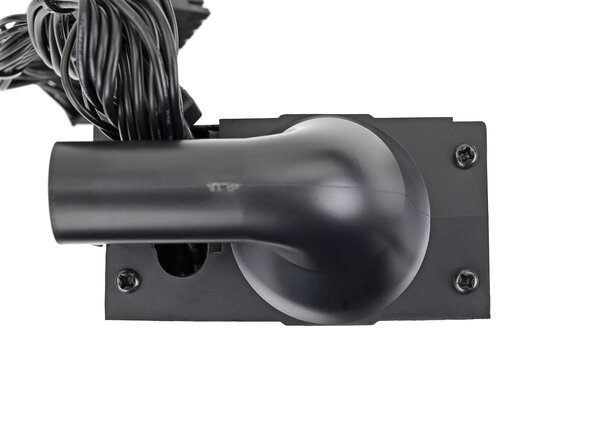

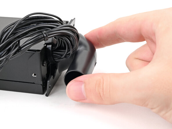

  36. Framework Desktop Power Supply Duct Replacement, Remove the Power Supply Duct: Schritt 36, Bild 1 von 2 Framework Desktop Power Supply Duct Replacement, Remove the Power Supply Duct: Schritt 36, Bild 2 von 2
    • Pull the Power Supply Duct off the power supply and remove it.

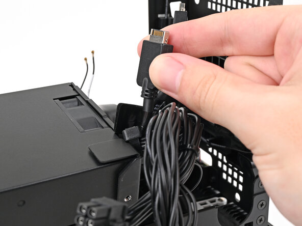

  40. Framework Desktop Power Supply Duct Replacement, Insert the Expansion card cable: Schritt 40, Bild 1 von 3 Framework Desktop Power Supply Duct Replacement, Insert the Expansion card cable: Schritt 40, Bild 2 von 3 Framework Desktop Power Supply Duct Replacement, Insert the Expansion card cable: Schritt 40, Bild 3 von 3
    • Thread the right Expansion card cable through the gap between the power supply and its duct.
  41. Framework Desktop Power Supply Duct Replacement, Place the power supply: Schritt 41, Bild 1 von 2 Framework Desktop Power Supply Duct Replacement, Place the power supply: Schritt 41, Bild 2 von 2
    • Place the power supply into its slot in the bottom of the Desktop.
  42. Framework Desktop Power Supply Duct Replacement, Install the power supply screw: Schritt 42, Bild 1 von 2 Framework Desktop Power Supply Duct Replacement, Install the power supply screw: Schritt 42, Bild 2 von 2
    • Use your Framework Desktop Screwdriver to install the 4.0 mm‑long Phillips screw securing the power supply.
  43. Framework Desktop Power Supply Duct Replacement, Place the rear plate: Schritt 43, Bild 1 von 2 Framework Desktop Power Supply Duct Replacement, Place the rear plate: Schritt 43, Bild 2 von 2
    • If you didn't remove the rear plate, skip this step.
    • Place the rear plate onto the back of the Desktop.
  44. Framework Desktop Power Supply Duct Replacement, Install the rear plate screws: Schritt 44, Bild 1 von 3 Framework Desktop Power Supply Duct Replacement, Install the rear plate screws: Schritt 44, Bild 2 von 3 Framework Desktop Power Supply Duct Replacement, Install the rear plate screws: Schritt 44, Bild 3 von 3
    • Use your Framework Desktop Screwdriver to install the three 5.9 mm‑long Phillips screws securing the power supply.
    • If you removed the rear plate, install the six 4.0 mm‑long screws securing the rear plate.

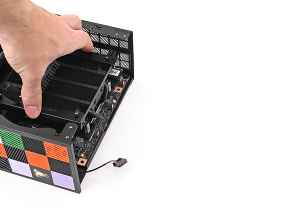

  45. Framework Desktop Power Supply Duct Replacement, Place the Mainboard: Schritt 45, Bild 1 von 3 Framework Desktop Power Supply Duct Replacement, Place the Mainboard: Schritt 45, Bild 2 von 3 Framework Desktop Power Supply Duct Replacement, Place the Mainboard: Schritt 45, Bild 3 von 3
    • Grab the Mainboard by its heatsink and slide it into the chassis.
    • Align the rear ports with its cutout and the screw posts with the screw holes on the Mainboard.
    • You'll feel the Mainboard rest onto the screw posts when it's aligned properly.
    • Make sure no cables are trapped underneath the Mainboard before continuing.
  46. Framework Desktop Power Supply Duct Replacement, Install the Mainboard screws: Schritt 46, Bild 1 von 2 Framework Desktop Power Supply Duct Replacement, Install the Mainboard screws: Schritt 46, Bild 2 von 2
    • Use your Framework Desktop Screwdriver to install the four 8.2 mm‑long Phillips screws securing the Mainboard.

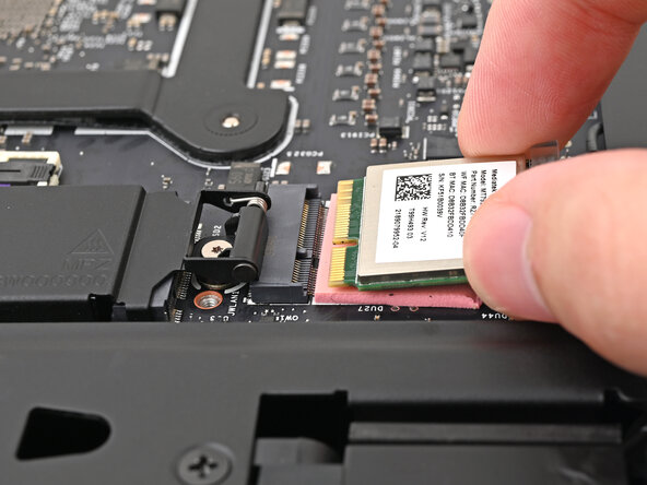

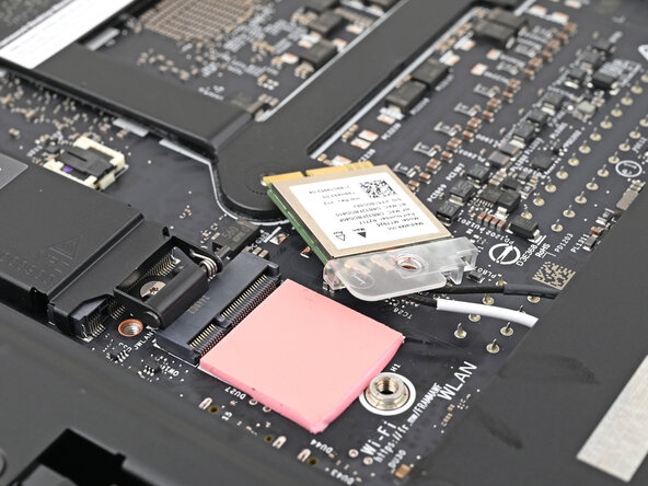

  49. Framework Desktop Power Supply Duct Replacement, Install the Wi-Fi module: Schritt 49, Bild 1 von 2 Framework Desktop Power Supply Duct Replacement, Install the Wi-Fi module: Schritt 49, Bild 2 von 2
    • Hold the Wi-Fi module by its edges. Don't touch the gold contacts with your fingers. If you do, wipe the contacts with a clean, lint-free cloth to remove any finger oils.
    • Align the Wi-Fi module's gold contacts and notch with the socket on the Mainboard.
    • Insert the Wi-Fi module into the socket at a shallow angle. The gold contacts should mostly be covered by the socket.
    • The Wi-Fi module fits into the socket in one orientation. If it doesn't fit, try flipping the module.
  50. Framework Desktop Power Supply Duct Replacement, Install the Wi-Fi module screw: Schritt 50, Bild 1 von 2 Framework Desktop Power Supply Duct Replacement, Install the Wi-Fi module screw: Schritt 50, Bild 2 von 2
    • Use your Framework Desktop Screwdriver to install the 7.0 mm‑long Phillips screw securing the Wi-Fi module.

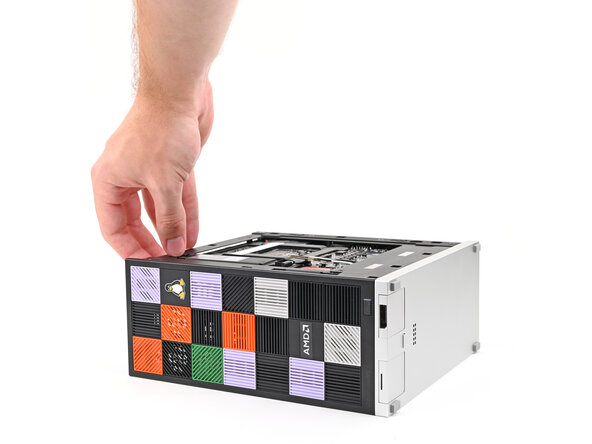

  52. Framework Desktop Power Supply Duct Replacement, Place the top plate: Schritt 52, Bild 1 von 2 Framework Desktop Power Supply Duct Replacement, Place the top plate: Schritt 52, Bild 2 von 2
    • Place the top plate on top of the Desktop, making sure it slots into the chassis so the orange circles are visible.
  53. Framework Desktop Power Supply Duct Replacement: Schritt 53, Bild 1 von 2 Framework Desktop Power Supply Duct Replacement: Schritt 53, Bild 2 von 2
    • Make sure the matching screw hole on the top plate labeled "5/8" is slotted on the inside of the Chassis so that the orange circle is visible.
  54. Framework Desktop Power Supply Duct Replacement, Install the top plate screws: Schritt 54, Bild 1 von 3 Framework Desktop Power Supply Duct Replacement, Install the top plate screws: Schritt 54, Bild 2 von 3 Framework Desktop Power Supply Duct Replacement, Install the top plate screws: Schritt 54, Bild 3 von 3
    • While holding the Desktop steady, use your Framework Desktop Screwdriver to install the eight 4.0 mm‑long Phillips screws securing the top plate.
  55. Framework Desktop Power Supply Duct Replacement, Install the Right Panel: Schritt 55, Bild 1 von 3 Framework Desktop Power Supply Duct Replacement, Install the Right Panel: Schritt 55, Bild 2 von 3 Framework Desktop Power Supply Duct Replacement, Install the Right Panel: Schritt 55, Bild 3 von 3
    • Slide the Right Panel onto the right edge of the chassis, from top to bottom, and press it flat to ensure its clips are slotted into place.
    • There should be a small gap between the bottom of the Right Panel and the silver base.
    • Push the Right Panel towards the base of the computer to engage the clips.
  56. Framework Desktop Power Supply Duct Replacement, Reposition the Mainboard: Schritt 56, Bild 1 von 2 Framework Desktop Power Supply Duct Replacement, Reposition the Mainboard: Schritt 56, Bild 2 von 2
    • Lay the right side of the Desktop on your work surface so the Mainboard is facing upward.
  57. Framework Desktop Power Supply Duct Replacement, Connect the bottom Expansion Card cable: Schritt 57, Bild 1 von 2 Framework Desktop Power Supply Duct Replacement, Connect the bottom Expansion Card cable: Schritt 57, Bild 2 von 2
    • Slide the bottom Expansion Card cable into its socket on the Mainboard.
  58. Framework Desktop Power Supply Duct Replacement, Connect the CPU power cable: Schritt 58, Bild 1 von 2 Framework Desktop Power Supply Duct Replacement, Connect the CPU power cable: Schritt 58, Bild 2 von 2
    • Orient the CPU power supply cable so its clip is facing the heatsink.
    • Slide the cable into its socket on the Mainboard until you feel it click into place.
  59. Framework Desktop Power Supply Duct Replacement, Connect the main power cable: Schritt 59, Bild 1 von 2 Framework Desktop Power Supply Duct Replacement, Connect the main power cable: Schritt 59, Bild 2 von 2
    • Orient the main power supply cable so its clip is facing away from the heatsink.
  60. Framework Desktop Power Supply Duct Replacement, Connect the top Expansion Card cable: Schritt 60, Bild 1 von 2 Framework Desktop Power Supply Duct Replacement, Connect the top Expansion Card cable: Schritt 60, Bild 2 von 2
    • Slide the top Expansion Card cable into its socket on the Mainboard.
  61. Framework Desktop Power Supply Duct Replacement, Insert the fan: Schritt 61, Bild 1 von 3 Framework Desktop Power Supply Duct Replacement, Insert the fan: Schritt 61, Bild 2 von 3 Framework Desktop Power Supply Duct Replacement, Insert the fan: Schritt 61, Bild 3 von 3
    • Orient the fan so its label is facing downward and the cable(s) is pointing towards the top of the computer.
    • If your fan has an arrow indicating airflow direction, make sure it's pointed towards the heatsink.
    • If you're using a different fan, orient it such that the fan is blowing towards the heatsink, not away.
    • Lay the fan on top of the heatsink, making sure the cables are routed so they poke out of the hole on the top of the computer.

  63. Framework Desktop Power Supply Duct Replacement, Insert the fan duct: Schritt 63, Bild 1 von 2 Framework Desktop Power Supply Duct Replacement, Insert the fan duct: Schritt 63, Bild 2 von 2
    • Lay the fan duct on top of the fan with the lip facing upward.
    • Align the screw holes on the fan duct with the ones on the fan.
  64. Framework Desktop Power Supply Duct Replacement, Install the fan screws: Schritt 64, Bild 1 von 2 Framework Desktop Power Supply Duct Replacement, Install the fan screws: Schritt 64, Bild 2 von 2
    • Use your Framework Desktop Screwdriver to install the four 27.3 mm‑long screws securing the fan and fan duct.
  65. Framework Desktop Power Supply Duct Replacement, Connect the fan: Schritt 65, Bild 1 von 2 Framework Desktop Power Supply Duct Replacement, Connect the fan: Schritt 65, Bild 2 von 2
    • Orient the main fan cable so its two vertical lines are facing you.
    • Slide the main fan cable over the four-pronged connector labeled "APU Fan," making sure the orange label slots between the vertical lines.

  67. Framework Desktop Power Supply Duct Replacement, Install the Left Panel: Schritt 67, Bild 1 von 3 Framework Desktop Power Supply Duct Replacement, Install the Left Panel: Schritt 67, Bild 2 von 3 Framework Desktop Power Supply Duct Replacement, Install the Left Panel: Schritt 67, Bild 3 von 3
    • Slide the Left Panel onto the left edge of the chassis and press it flat to ensure its clips are slotted into place.
    • There should be a small gap between the bottom of the Left Panel and the silver base.
    • Push the Left Panel towards the base of the computer to close the gap and engage the clips.

  71. Framework Desktop Power Supply Duct Replacement, Install the top panel screws: Schritt 71, Bild 1 von 3 Framework Desktop Power Supply Duct Replacement, Install the top panel screws: Schritt 71, Bild 2 von 3 Framework Desktop Power Supply Duct Replacement, Install the top panel screws: Schritt 71, Bild 3 von 3
    • Insert the top panel screw into its hole and twist clockwise until it feels snug.
  72. Framework Desktop Power Supply Duct Replacement: Schritt 72, Bild 1 von 3 Framework Desktop Power Supply Duct Replacement: Schritt 72, Bild 2 von 3 Framework Desktop Power Supply Duct Replacement: Schritt 72, Bild 3 von 3
    • Repeat the same procedure for the other top panel screw.
