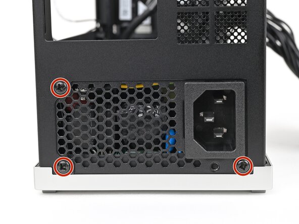

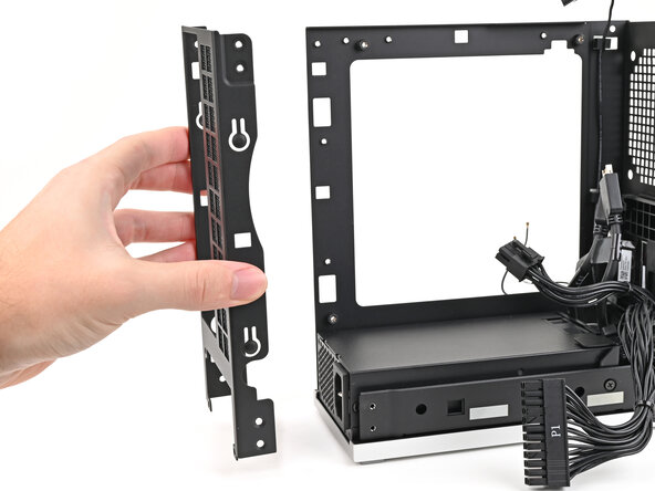

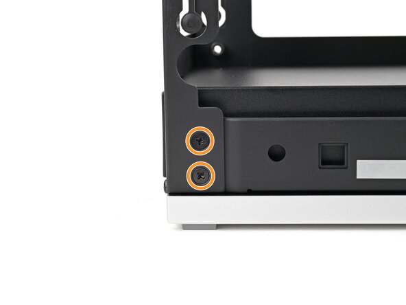

  30. Framework Desktop Power Supply Replacement, Remove the rear plate screws: Schritt 30, Bild 1 von 3 Framework Desktop Power Supply Replacement, Remove the rear plate screws: Schritt 30, Bild 2 von 3 Framework Desktop Power Supply Replacement, Remove the rear plate screws: Schritt 30, Bild 3 von 3
    • Use your Framework Desktop Screwdriver to remove the three 5.9 mm‑long Phillips screws securing the power supply.
    • Optionally, you can remove the six 4.0 mm‑long screws securing the rear plate to make removing the power supply easier.
    • If you don't remove the rear plate screws, skip the next step.
  31. Framework Desktop Power Supply Replacement, Remove the rear plate: Schritt 31, Bild 1 von 2 Framework Desktop Power Supply Replacement, Remove the rear plate: Schritt 31, Bild 2 von 2
    • Pull the rear plate off the back of the Desktop and remove it.

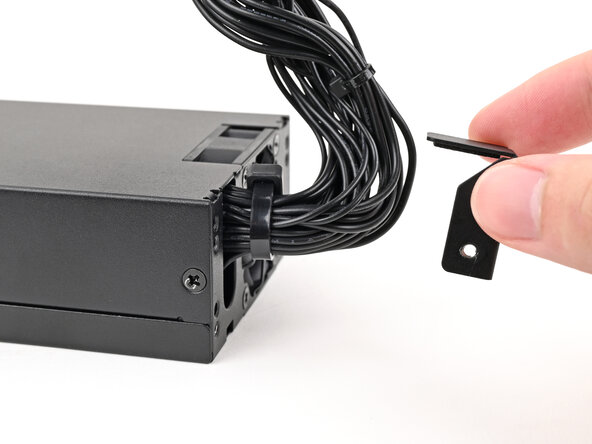

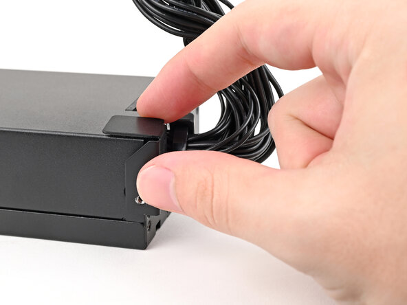

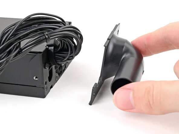

  36. Framework Desktop Power Supply Replacement, Place the mounting bracket: Schritt 36, Bild 1 von 2 Framework Desktop Power Supply Replacement, Place the mounting bracket: Schritt 36, Bild 2 von 2
    • If your power supply doesn't come with its mounting bracket and Power Supply Duct pre-installed, follow the next four steps. Otherwise, skip ahead four steps.
    • Place the mounting bracket on the corner of the power supply closest to the wire bundle.
  37. Framework Desktop Power Supply Replacement, Install the mounting bracket screw: Schritt 37, Bild 1 von 2 Framework Desktop Power Supply Replacement, Install the mounting bracket screw: Schritt 37, Bild 2 von 2
    • Use your Framework Desktop Screwdriver to Install the 5.8 mm‑long Phillips screw securing the mounting bracket.

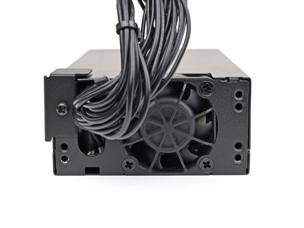

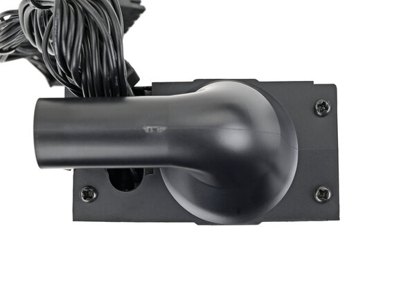

  38. Framework Desktop Power Supply Replacement, Place the Power Supply Duct: Schritt 38, Bild 1 von 2 Framework Desktop Power Supply Replacement, Place the Power Supply Duct: Schritt 38, Bild 2 von 2
    • Place the Power Supply Duct on the power supply and align its screw holes.

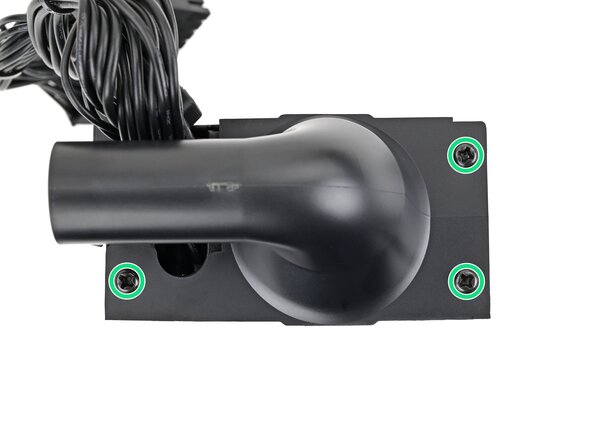

  39. Framework Desktop Power Supply Replacement, Install the Power Supply Duct screws: Schritt 39, Bild 1 von 2 Framework Desktop Power Supply Replacement, Install the Power Supply Duct screws: Schritt 39, Bild 2 von 2
    • Use your Framework Desktop Screwdriver to Install the three 5.8 mm‑long Phillips screws securing the Power Supply Duct.
