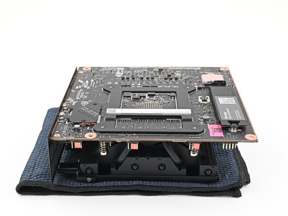

  30. Framework Desktop RTC Battery Replacement, Place the Mainboard: Schritt 30, Bild 1 von 2 Framework Desktop RTC Battery Replacement, Place the Mainboard: Schritt 30, Bild 2 von 2
    • Place the Mainboard on your work surface with its heatsink resting on a soft, clean cloth.

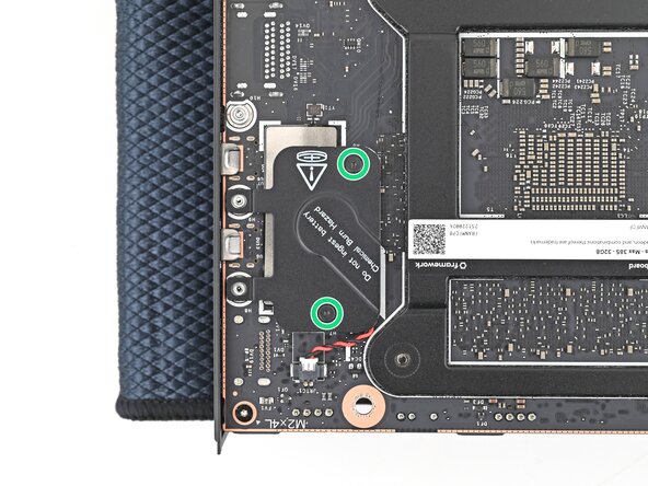

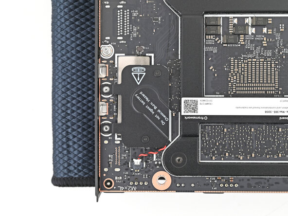

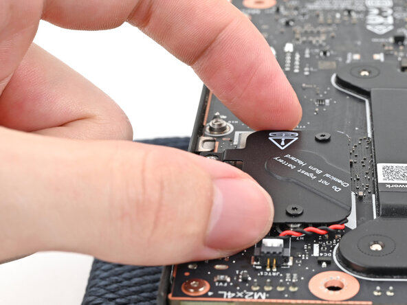

  31. Framework Desktop RTC Battery Replacement, Loosen the RTC battery cover screws: Schritt 31, Bild 1 von 2 Framework Desktop RTC Battery Replacement, Loosen the RTC battery cover screws: Schritt 31, Bild 2 von 2
    • Use your Framework Desktop Screwdriver to loosen the two captive T5 Torx screws securing the RTC battery cover.

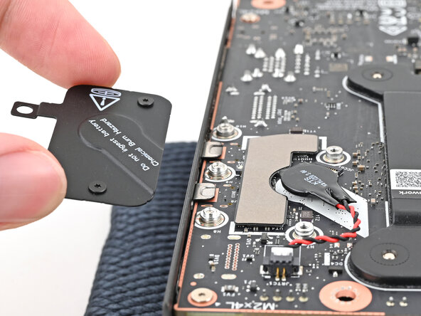

  32. Framework Desktop RTC Battery Replacement, Remove the RTC battery cover: Schritt 32, Bild 1 von 2 Framework Desktop RTC Battery Replacement, Remove the RTC battery cover: Schritt 32, Bild 2 von 2
    • Lift the RTC battery cover off the Mainboard and remove it.

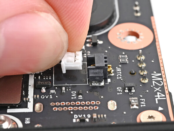

  33. Framework Desktop RTC Battery Replacement, Disconnect the RTC battery: Schritt 33, Bild 1 von 2 Framework Desktop RTC Battery Replacement, Disconnect the RTC battery: Schritt 33, Bild 2 von 2
    • Grip the RTC battery connector and pull it straight out of its socket to disconnect it.

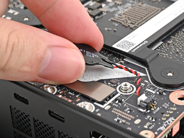

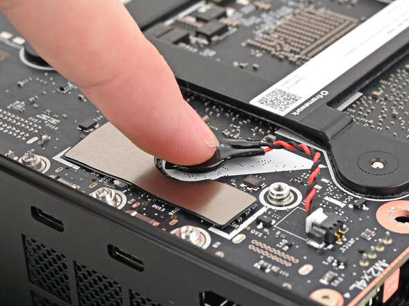

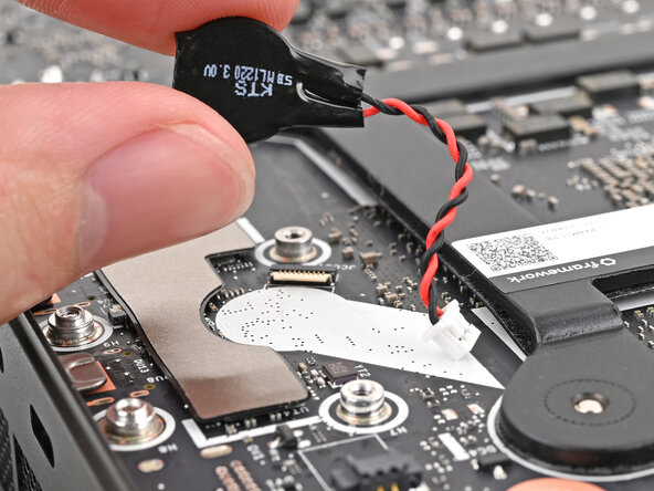

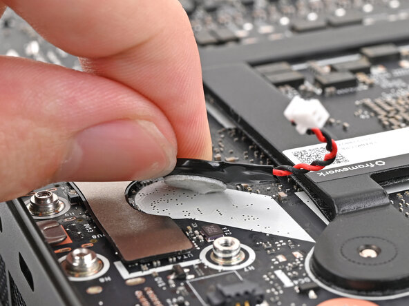

  34. Framework Desktop RTC Battery Replacement, Remove the RTC battery: Schritt 34, Bild 1 von 3 Framework Desktop RTC Battery Replacement, Remove the RTC battery: Schritt 34, Bild 2 von 3 Framework Desktop RTC Battery Replacement, Remove the RTC battery: Schritt 34, Bild 3 von 3
    • The RTC battery is lightly adhered to the Mainboard.
    • Use your fingers to peel the RTC battery off the Mainboard and remove it.

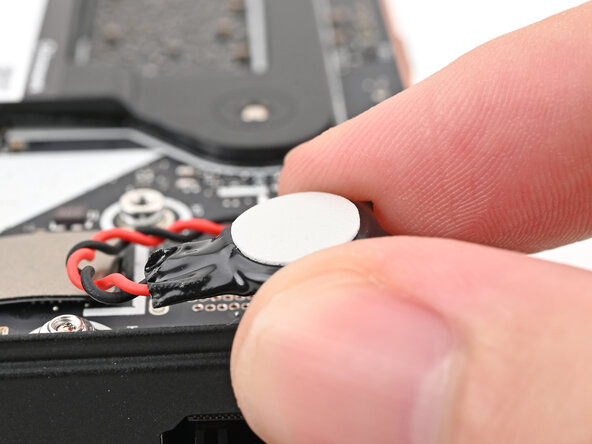

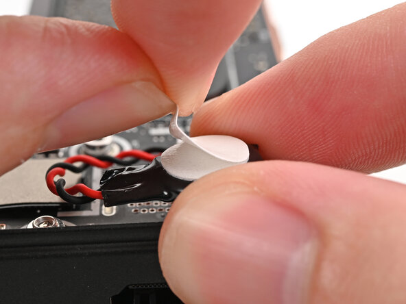

  37. Framework Desktop RTC Battery Replacement, Expose the adhesive: Schritt 37, Bild 1 von 3 Framework Desktop RTC Battery Replacement, Expose the adhesive: Schritt 37, Bild 2 von 3 Framework Desktop RTC Battery Replacement, Expose the adhesive: Schritt 37, Bild 3 von 3
    • Peel the white liner off the back of the RTC battery to expose the adhesive.
