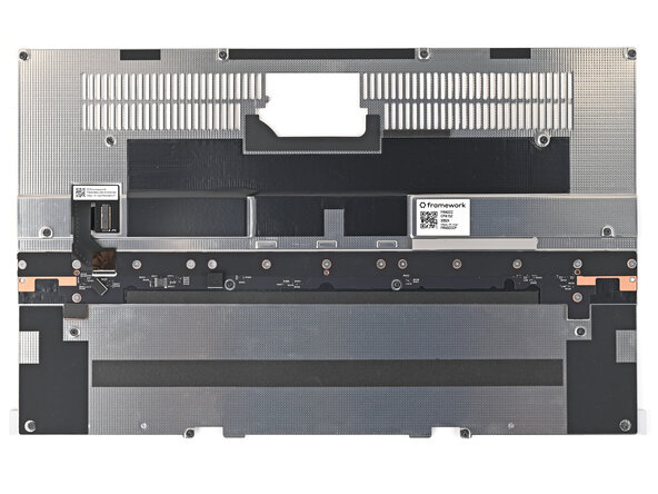

  10. Framework Laptop 16 Input Module Connector Board Replacement, Remove the Input Module Connector Board screws: Schritt 10, Bild 1 von 2 Framework Laptop 16 Input Module Connector Board Replacement, Remove the Input Module Connector Board screws: Schritt 10, Bild 2 von 2
    • Use your Framework Screwdriver to remove the fifteen 1.4 mm‑long Phillips screws securing the Input Module Connector Board.

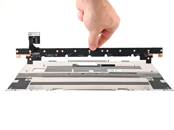

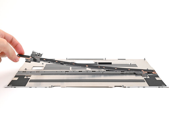

  11. Framework Laptop 16 Input Module Connector Board Replacement, Remove the Input Module Connector Board: Schritt 11, Bild 1 von 3 Framework Laptop 16 Input Module Connector Board Replacement, Remove the Input Module Connector Board: Schritt 11, Bild 2 von 3 Framework Laptop 16 Input Module Connector Board Replacement, Remove the Input Module Connector Board: Schritt 11, Bild 3 von 3
    • Lift the Input Module Connector Board off the Mid Plate and remove it.
