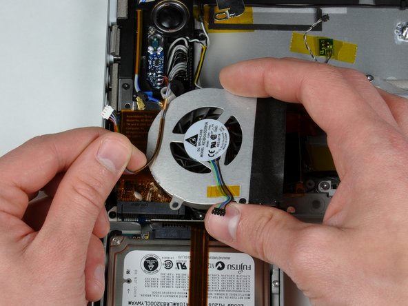

  20. MacBook Pro 15" Core 2 Duo Models A1226 and A1260 Lower Case Replacement: Schritt 20, Bild 1 von 2 MacBook Pro 15" Core 2 Duo Models A1226 and A1260 Lower Case Replacement: Schritt 20, Bild 2 von 2
    • Hold the logic board down with one hand and use your other hand to lift the left fan up from its housing. There is a piece of black tape securing the left fan to the heat sink. Carefully peel this tape up from the heat sink as you lift the left fan up.
    • Place the left fan above the Airport card. It is not necessary to remove the fan from the computer entirely.
    • Lift the right fan up and carefully peel up the tape securing the fan to the heat sink as you go.
    • Remove the right fan from the computer.

  22. MacBook Pro 15" Core 2 Duo Models A1226 and A1260 Lower Case Replacement, Lower Case: Schritt 22, Bild 1 von 2 MacBook Pro 15" Core 2 Duo Models A1226 and A1260 Lower Case Replacement, Lower Case: Schritt 22, Bild 2 von 2
    • Lift the heat sink out of the computer.
    • Peel up the iSight cable from the black tape at the top of the left fan.
    • Peel up the left ambient light sensor cable from above the left fan, removing tape as necessary.
    • Remove the left fan from the computer.
