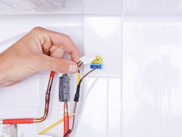

Use your fingers to squeeze the thermistor's white connector by the sides.
Pull the connector to disconnect it.
Use snips or scissors to cut any cable ties securing the yellow thermistor cable.
Use your fingers to twist and unclip the thermistor from the evaporator coil.
Remove the evaporator thermistor.
