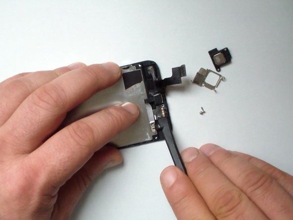

  10. iPhone 5s Display Assembly - Video Tutorial Replacement, Front camera and proximity flex cable.: Schritt 10, Bild 1 von 3 iPhone 5s Display Assembly - Video Tutorial Replacement, Front camera and proximity flex cable.: Schritt 10, Bild 2 von 3 iPhone 5s Display Assembly - Video Tutorial Replacement, Front camera and proximity flex cable.: Schritt 10, Bild 3 von 3
    • Use a plastic tool and gently remove the flex cable.
    • Originally the flex cable is stuck to the LCD shield by a black sticker. Unstuck the sticker or remove the flex cable together with the LCD shield. Do this careful!
    • Inspect the new spare part and install on it all small missing parts from the old spare part (front camera bracket, light sensor bracket, etc.).
