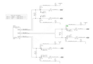

@xslushedx this is what the designators are for the IC U40 (HDMI RE-DRIVER NB7NQ621M)
Reference Designator R29 is a 0 ohm resistor in a 0402 package
Reference Designator R28 is a 0 ohm resistor in a 0402 package
Reference Designator R699 is a 0 ohm resistor in a 0402 package (EMPTY)
Reference Designator R693 is a 0 ohm resistor in a 0402 package (EMPTY)
Reference Designator R189 is a 0 ohm resistor in a 0402 package
Reference Designator R178 is a 100 ohm resistor in a 0201 package
Reference Designator C704 is a 1µF 20% 6.3V X5R capacitor in a 0201 package
There is definitely a pattern to why those were left off. All the ones missing are 0 ohm resistors. Some of those are even listed as Empty, meaning that whoever build the boards for Microsoft, was not supposed to place a component there. If you are not familiar with 0 ohm resistors do on a board, check on here Sorry, I only have an English link for that. Maybe @benz78 has the German equivalent.
Bottom line, those are not needed for the function with the exception of R178, which is needed. That is the reason why whoever worked on the board before you, left that one in place.
