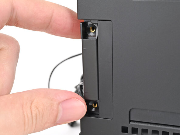

  2. Framework Desktop Antennas Replacement, Remove the Handle: Schritt 2, Bild 1 von 3 Framework Desktop Antennas Replacement, Remove the Handle: Schritt 2, Bild 2 von 3 Framework Desktop Antennas Replacement, Remove the Handle: Schritt 2, Bild 3 von 3
    • If you installed the Handle on your Desktop, follow this step. Otherwise, skip it.
    • Rotate the Handle's screw threads counterclockwise on both sides until it comes free.
    • Remove the Handle.

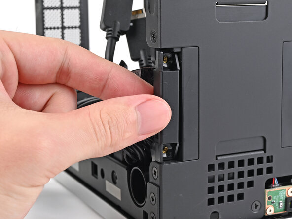

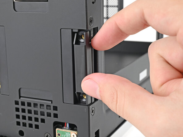

  3. Framework Desktop Antennas Replacement, Remove the Top Panel screws: Schritt 3, Bild 1 von 3 Framework Desktop Antennas Replacement, Remove the Top Panel screws: Schritt 3, Bild 2 von 3 Framework Desktop Antennas Replacement, Remove the Top Panel screws: Schritt 3, Bild 3 von 3
    • Use your finger to lift up the two D-rings on the Top Panel screws.
  4. Framework Desktop Antennas Replacement: Schritt 4, Bild 1 von 3 Framework Desktop Antennas Replacement: Schritt 4, Bild 2 von 3 Framework Desktop Antennas Replacement: Schritt 4, Bild 3 von 3
    • Use your fingers to twist the screw counter-clockwise and loosen it.
    • Remove the Top Panel screw.

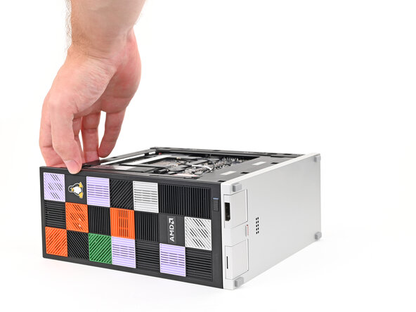

  7. Framework Desktop Antennas Replacement, Remove the Left Panel: Schritt 7, Bild 1 von 3 Framework Desktop Antennas Replacement, Remove the Left Panel: Schritt 7, Bild 2 von 3 Framework Desktop Antennas Replacement, Remove the Left Panel: Schritt 7, Bild 3 von 3
    • Use your fingers to grip the top of the Left Panel and slide it upward to release its clips.
    • Remove the Left Panel.

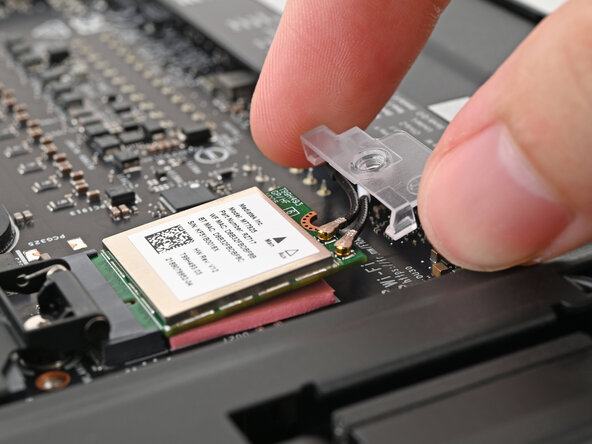

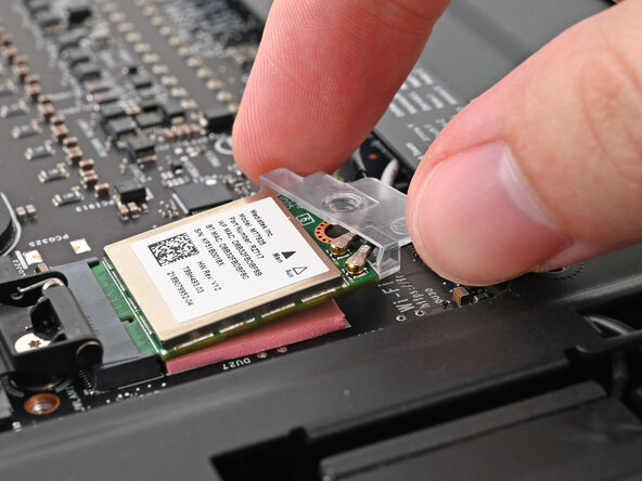

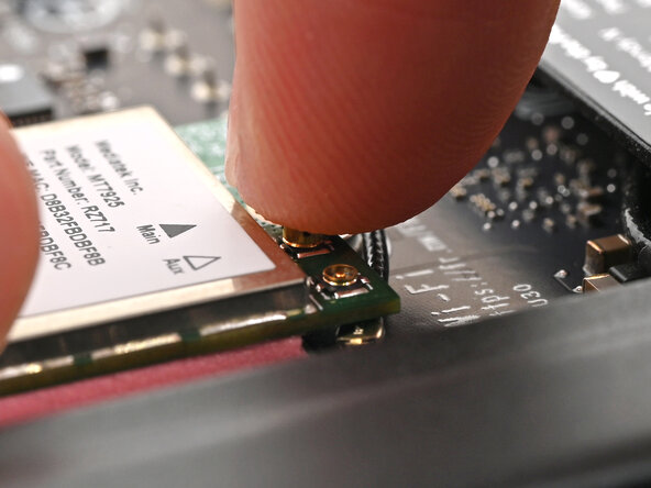

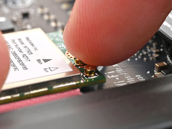

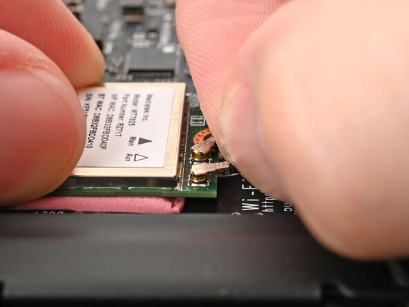

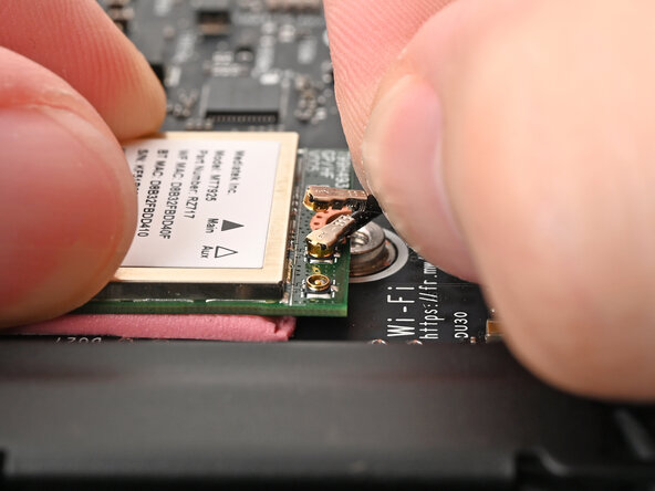

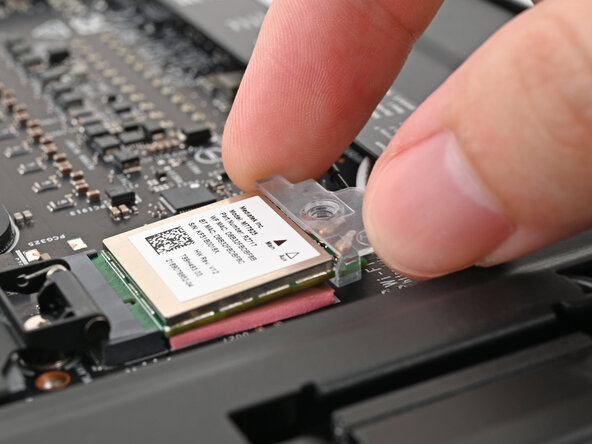

  25. Framework Desktop Antennas Replacement, Disconnect the Wi-Fi module: Schritt 25, Bild 1 von 3 Framework Desktop Antennas Replacement, Disconnect the Wi-Fi module: Schritt 25, Bild 2 von 3 Framework Desktop Antennas Replacement, Disconnect the Wi-Fi module: Schritt 25, Bild 3 von 3
    • The Wi-Fi module has two delicate coaxial cable connectors. Follow this step carefully to avoid damaging them.
    • Press and hold the Wi-Fi module down with your fingers.
    • Use your fingers to grip the white antenna cable, as close to the metal head as possible.
    • If you have angled tweezers, slide one arm of a pair of tweezers under the antenna connector, as close to the metal head as possible.
    • Gently lift the connector straight up to disconnect the white antenna cable.
    • Repeat the procedure with the black antenna cable.

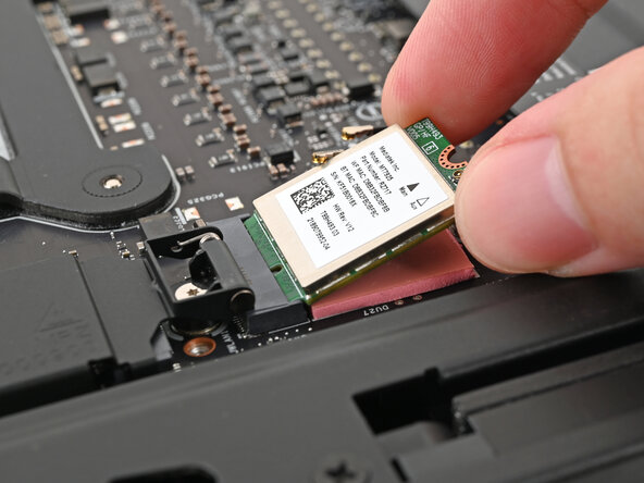

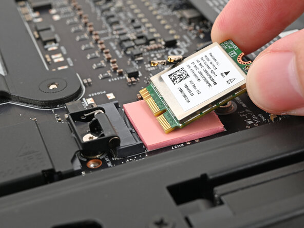

  26. Framework Desktop Antennas Replacement, Remove the Wi-Fi module: Schritt 26, Bild 1 von 2 Framework Desktop Antennas Replacement, Remove the Wi-Fi module: Schritt 26, Bild 2 von 2
    • Grip the Wi-Fi module by its edges and pull it straight out of its socket.
    • Remove the Wi-Fi module.

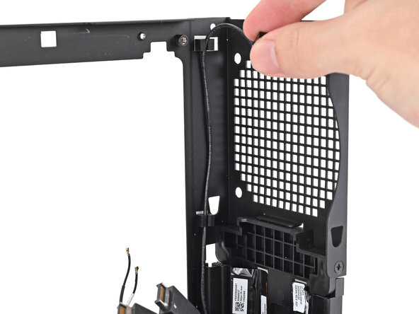

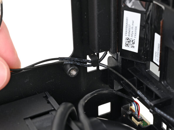

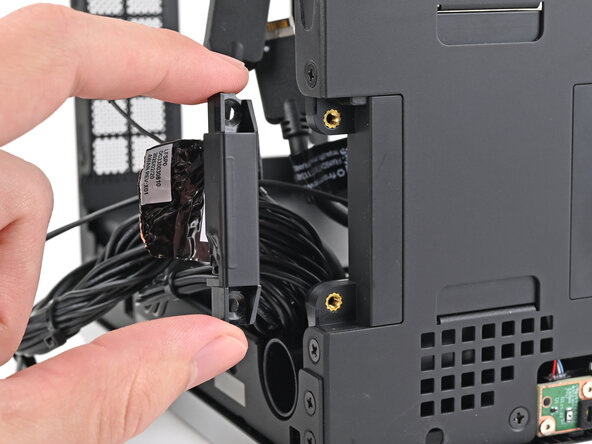

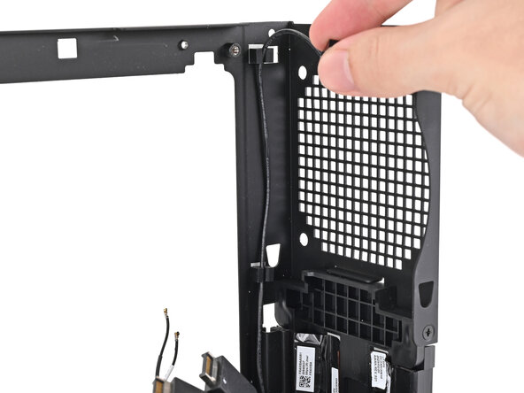

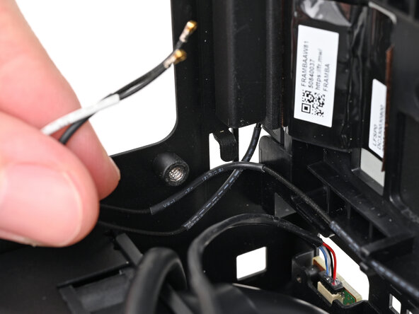

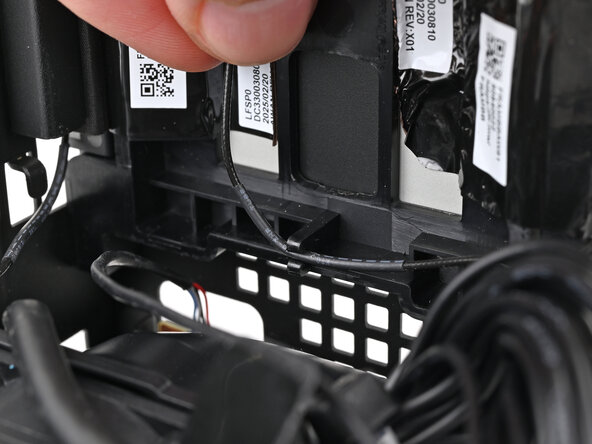

  32. Framework Desktop Antennas Replacement, Reroute the antenna cables: Schritt 32, Bild 1 von 2 Framework Desktop Antennas Replacement, Reroute the antenna cables: Schritt 32, Bild 2 von 2
    • Push the antenna cables out of the metal hook in the chassis.
  33. Framework Desktop Antennas Replacement: Schritt 33, Bild 1 von 2 Framework Desktop Antennas Replacement: Schritt 33, Bild 2 von 2
    • Pull the black antenna cable out of the plastic clip in the chassis.

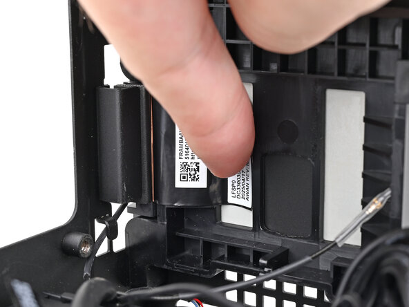

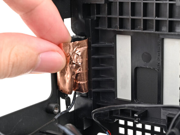

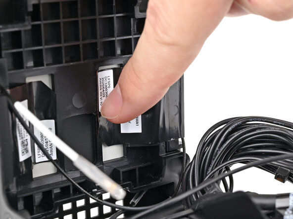

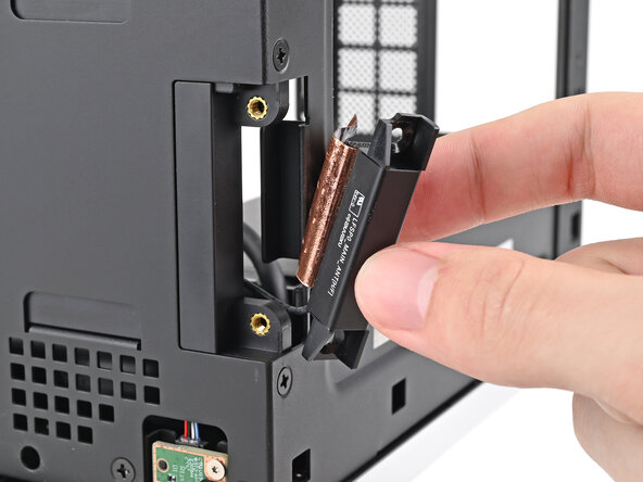

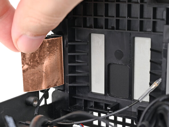

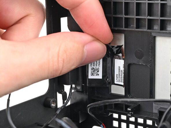

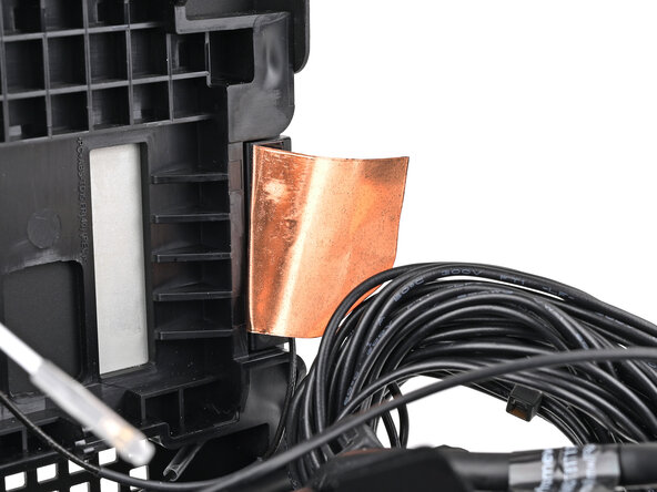

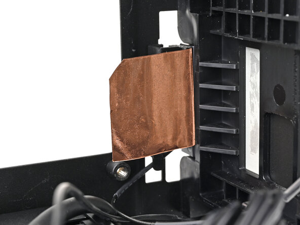

  34. Framework Desktop Antennas Replacement, Peel off the copper film: Schritt 34, Bild 1 von 2 Framework Desktop Antennas Replacement, Peel off the copper film: Schritt 34, Bild 2 von 2
    • Use your fingers to peel the left antenna's copper film off the chassis.

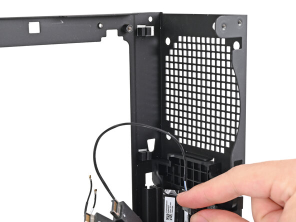

  35. Framework Desktop Antennas Replacement, Remove the left antenna screws: Schritt 35, Bild 1 von 2 Framework Desktop Antennas Replacement, Remove the left antenna screws: Schritt 35, Bild 2 von 2
    • Use your Framework Desktop Screwdriver to remove the two 4.0 mm‑long Phillips screws securing the left antenna.
  36. Framework Desktop Antennas Replacement, Remove the left antenna: Schritt 36, Bild 1 von 2 Framework Desktop Antennas Replacement, Remove the left antenna: Schritt 36, Bild 2 von 2
    • Lift the left antenna out of the chassis and remove it.

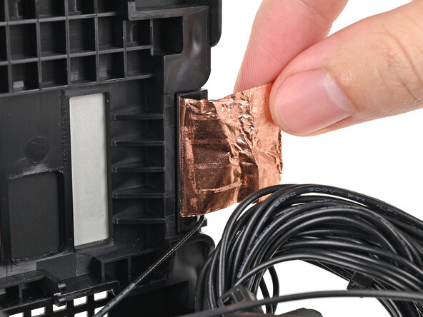

  37. Framework Desktop Antennas Replacement, Peel off the copper film: Schritt 37, Bild 1 von 2 Framework Desktop Antennas Replacement, Peel off the copper film: Schritt 37, Bild 2 von 2
    • Use your fingers to peel the right antenna's copper film off the chassis.

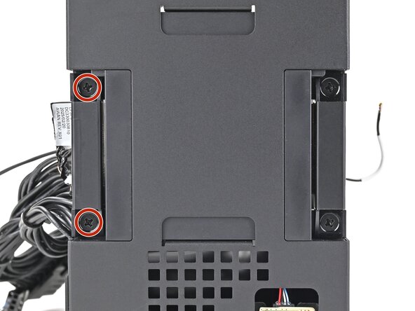

  38. Framework Desktop Antennas Replacement, Remove the right antenna screws: Schritt 38, Bild 1 von 2 Framework Desktop Antennas Replacement, Remove the right antenna screws: Schritt 38, Bild 2 von 2
    • Use your Framework Desktop Screwdriver to remove the two 4.0 mm‑long Phillips screws securing the right antenna.

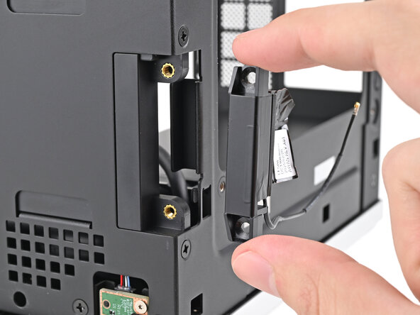

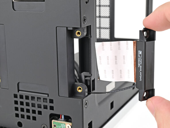

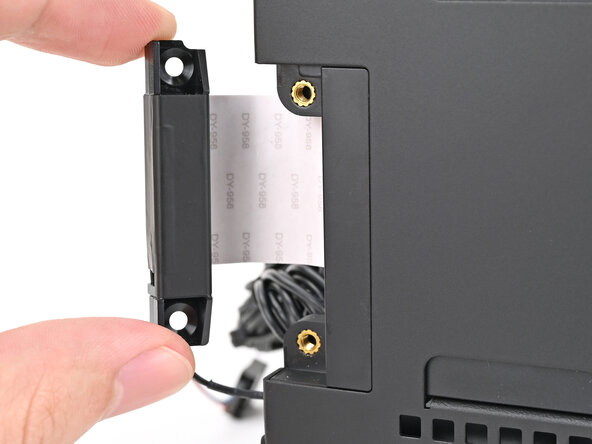

  39. Framework Desktop Antennas Replacement, Remove the right antenna: Schritt 39, Bild 1 von 3 Framework Desktop Antennas Replacement, Remove the right antenna: Schritt 39, Bild 2 von 3 Framework Desktop Antennas Replacement, Remove the right antenna: Schritt 39, Bild 3 von 3
    • Lift the right antenna out of the chassis, making sure to thread the cable through the slot.
    • Remove the antenna.

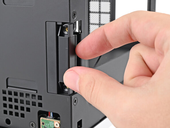

  41. Framework Desktop Antennas Replacement, Place the right antenna: Schritt 41, Bild 1 von 3 Framework Desktop Antennas Replacement, Place the right antenna: Schritt 41, Bild 2 von 3 Framework Desktop Antennas Replacement, Place the right antenna: Schritt 41, Bild 3 von 3
    • The replacement antennas look similar. The right antenna has a short, black antenna cable.
    • Place the replacement right antenna into its slot on the chassis, making sure to thread the cable through the slot.
  42. Framework Desktop Antennas Replacement, Install the right antenna screws: Schritt 42, Bild 1 von 2 Framework Desktop Antennas Replacement, Install the right antenna screws: Schritt 42, Bild 2 von 2
    • Use your Framework Desktop Screwdriver to install the two 4.0 mm‑long Phillips screws securing the right antenna.

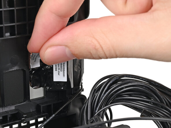

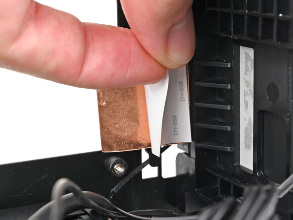

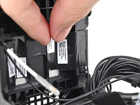

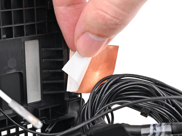

  43. Framework Desktop Antennas Replacement, Remove the adhesive liner: Schritt 43, Bild 1 von 2 Framework Desktop Antennas Replacement, Remove the adhesive liner: Schritt 43, Bild 2 von 2
    • Remove the liner from the back of your replacement right antenna.
  44. Framework Desktop Antennas Replacement, Adhere the right antenna: Schritt 44, Bild 1 von 3 Framework Desktop Antennas Replacement, Adhere the right antenna: Schritt 44, Bild 2 von 3 Framework Desktop Antennas Replacement, Adhere the right antenna: Schritt 44, Bild 3 von 3
    • Press the right antenna's copper film onto the chassis and adhere it.

  47. Framework Desktop Antennas Replacement, Remove the adhesive liner: Schritt 47, Bild 1 von 2 Framework Desktop Antennas Replacement, Remove the adhesive liner: Schritt 47, Bild 2 von 2
    • Remove the liner from the back of your replacement left antenna.
  48. Framework Desktop Antennas Replacement, Adhere the left antenna: Schritt 48, Bild 1 von 3 Framework Desktop Antennas Replacement, Adhere the left antenna: Schritt 48, Bild 2 von 3 Framework Desktop Antennas Replacement, Adhere the left antenna: Schritt 48, Bild 3 von 3
    • Press the left antenna's copper film onto the chassis and adhere it.

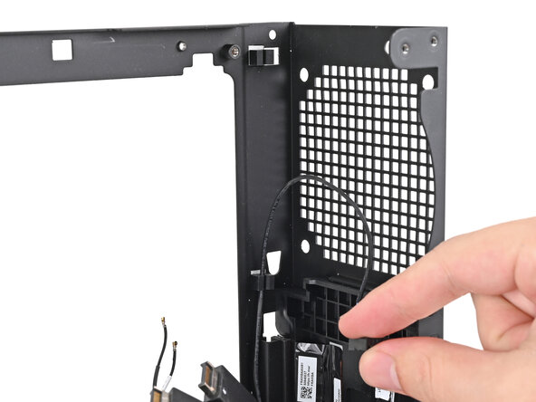

  49. Framework Desktop Antennas Replacement, Reroute the antenna cables: Schritt 49, Bild 1 von 2 Framework Desktop Antennas Replacement, Reroute the antenna cables: Schritt 49, Bild 2 von 2
    • Press the black antenna cable into the plastic clip in the chassis.
  50. Framework Desktop Antennas Replacement: Schritt 50, Bild 1 von 2 Framework Desktop Antennas Replacement: Schritt 50, Bild 2 von 2
    • Pull the antenna cables into their metal hook in the chassis.

  56. Framework Desktop Antennas Replacement, Install the Wi-Fi module: Schritt 56, Bild 1 von 2 Framework Desktop Antennas Replacement, Install the Wi-Fi module: Schritt 56, Bild 2 von 2
    • Hold the Wi-Fi module by its edges. Don't touch the gold contacts with your fingers. If you do, wipe the contacts with a clean, lint-free cloth to remove any finger oils.
    • Align the Wi-Fi module's gold contacts and notch with the socket on the Mainboard.
    • Insert the Wi-Fi module into the socket at a shallow angle. The gold contacts should mostly be covered by the socket.
    • The Wi-Fi module fits into the socket in one orientation. If it doesn't fit, try flipping the module.
  57. Framework Desktop Antennas Replacement, Connect the Wi-Fi Module: Schritt 57, Bild 1 von 3 Framework Desktop Antennas Replacement, Connect the Wi-Fi Module: Schritt 57, Bild 2 von 3 Framework Desktop Antennas Replacement, Connect the Wi-Fi Module: Schritt 57, Bild 3 von 3
    • Hold the Wi-Fi module down with your fingers.
    • Position the black antenna cable connector over the left Wi-Fi module's coaxial socket.
    • Tweezers can help position the connector.
    • Use your finger to press the connector into place. You should feel a faint click, and the cable will stay attached to the socket by itself.
    • These connectors are very delicate! If the connector doesn't feel like it's clicking in place, reposition the connector and try again.
    • Repeat the procedure with the white antenna cable.
  58. Framework Desktop Antennas Replacement: Schritt 58, Bild 1 von 3 Framework Desktop Antennas Replacement: Schritt 58, Bild 2 von 3 Framework Desktop Antennas Replacement: Schritt 58, Bild 3 von 3
    • Hook the Wi-Fi bracket over the corner of the Wi-Fi module opposite the antenna cables.
    • Rotate the bracket over the Wi-Fi module, making sure the screw hole isn't being obstructed by the antenna cables.
  59. Framework Desktop Antennas Replacement, Install the Wi-Fi module screw: Schritt 59, Bild 1 von 2 Framework Desktop Antennas Replacement, Install the Wi-Fi module screw: Schritt 59, Bild 2 von 2
    • Use your Framework Desktop Screwdriver to install the 7.0 mm‑long Phillips screw securing the Wi-Fi module.
  60. Framework Desktop Antennas Replacement, Reposition the Desktop: Schritt 60, Bild 1 von 2 Framework Desktop Antennas Replacement, Reposition the Desktop: Schritt 60, Bild 2 von 2
    • Rotate the Desktop so it sits upright on your work surface.
