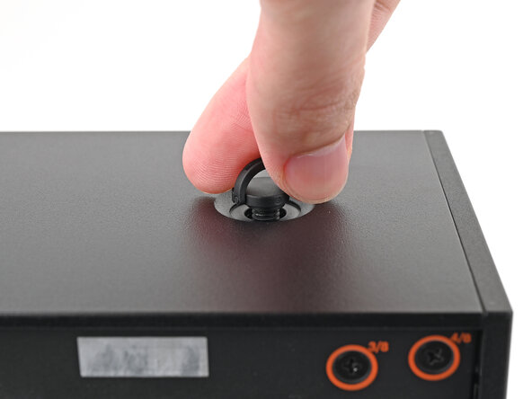

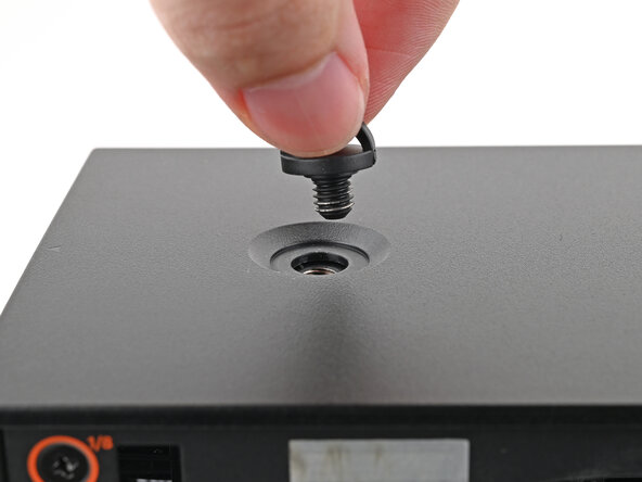

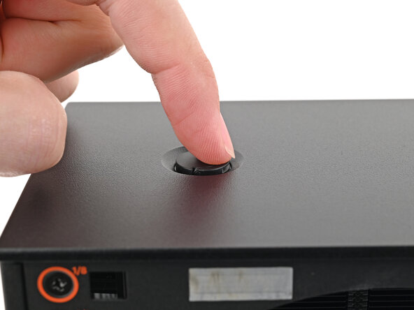

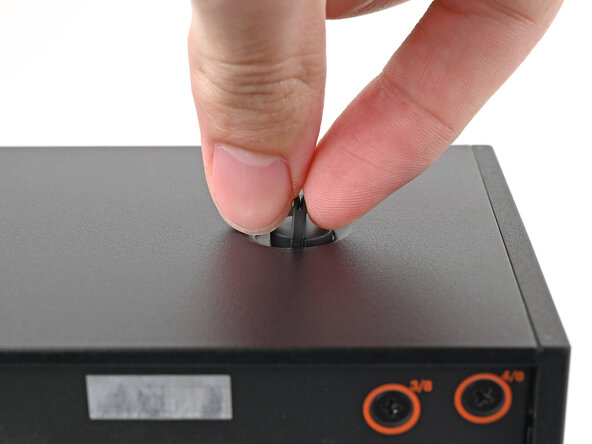

  3. Framework Desktop Case Replacement, Remove the Top Panel screws: Schritt 3, Bild 1 von 3 Framework Desktop Case Replacement, Remove the Top Panel screws: Schritt 3, Bild 2 von 3 Framework Desktop Case Replacement, Remove the Top Panel screws: Schritt 3, Bild 3 von 3
    • Use your finger to lift up the two D-rings on the Top Panel screws.
  4. Framework Desktop Case Replacement: Schritt 4, Bild 1 von 3 Framework Desktop Case Replacement: Schritt 4, Bild 2 von 3 Framework Desktop Case Replacement: Schritt 4, Bild 3 von 3
    • Use your fingers to twist the screw counter-clockwise and loosen it.
    • Remove the Top Panel screw.

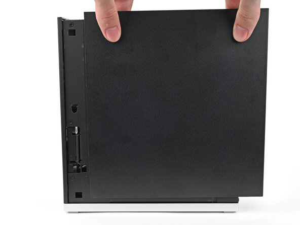

  7. Framework Desktop Case Replacement, Remove the Left Panel: Schritt 7, Bild 1 von 3 Framework Desktop Case Replacement, Remove the Left Panel: Schritt 7, Bild 2 von 3 Framework Desktop Case Replacement, Remove the Left Panel: Schritt 7, Bild 3 von 3
    • Use your fingers to grip the top of the Left Panel and slide it upward to release its clips.
    • Remove the Left Panel.

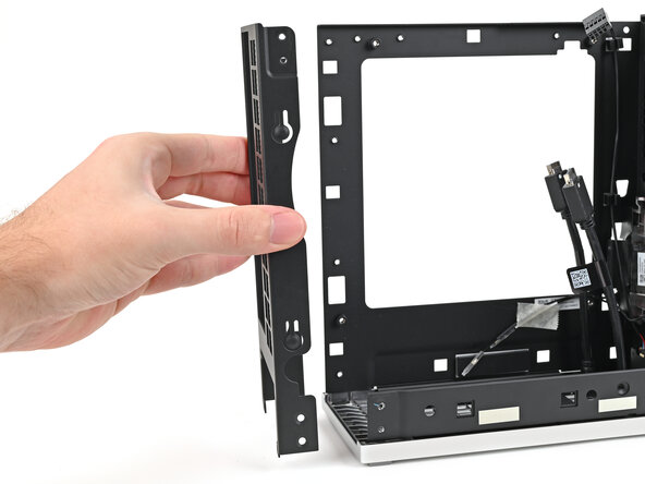

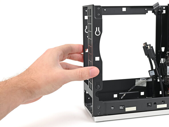

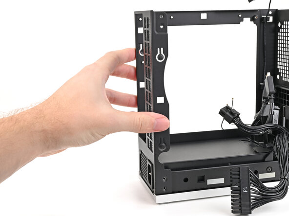

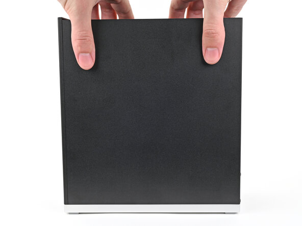

  19. Framework Desktop Case Replacement, Remove the Right Panel: Schritt 19, Bild 1 von 3 Framework Desktop Case Replacement, Remove the Right Panel: Schritt 19, Bild 2 von 3 Framework Desktop Case Replacement, Remove the Right Panel: Schritt 19, Bild 3 von 3
    • Use your fingers to grip the top of the Right Panel and slide it upward to release its clips.
    • Remove the Right Panel.

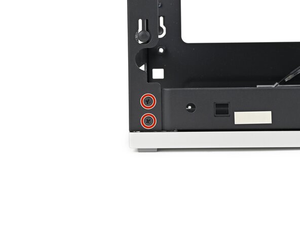

  20. Framework Desktop Case Replacement, Remove the top plate screws: Schritt 20, Bild 1 von 3 Framework Desktop Case Replacement, Remove the top plate screws: Schritt 20, Bild 2 von 3 Framework Desktop Case Replacement, Remove the top plate screws: Schritt 20, Bild 3 von 3
    • While holding the Desktop steady, use your Framework Desktop Screwdriver to remove the eight 4.0 mm‑long Phillips screws securing the top plate.

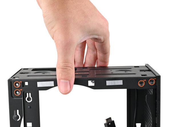

  21. Framework Desktop Case Replacement, Remove the top plate: Schritt 21, Bild 1 von 2 Framework Desktop Case Replacement, Remove the top plate: Schritt 21, Bild 2 von 2
    • Lift the top plate off the Desktop and remove it.

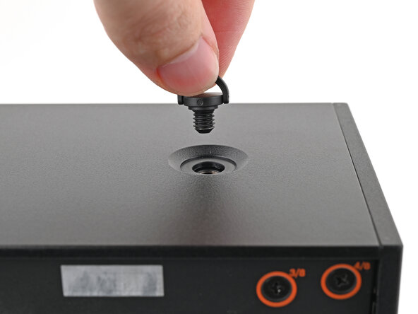

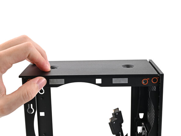

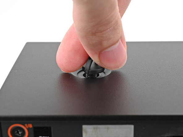

  37. Framework Desktop Case Replacement, Remove the Top Panel screws: Schritt 37, Bild 1 von 3 Framework Desktop Case Replacement, Remove the Top Panel screws: Schritt 37, Bild 2 von 3 Framework Desktop Case Replacement, Remove the Top Panel screws: Schritt 37, Bild 3 von 3
    • Your replacement case requires some disassembly before transferring the internals. The next 12 steps will show how to disassemble the case.

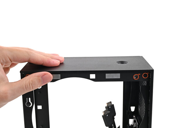

  39. Framework Desktop Case Replacement: Schritt 39, Bild 1 von 3 Framework Desktop Case Replacement: Schritt 39, Bild 2 von 3 Framework Desktop Case Replacement: Schritt 39, Bild 3 von 3
    • Repeat the same procedure for the other Top Panel screw.

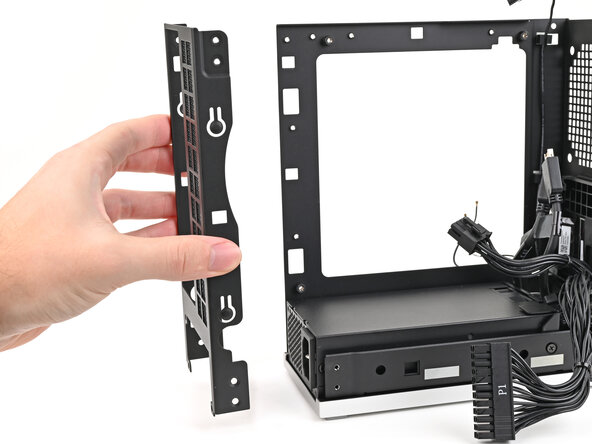

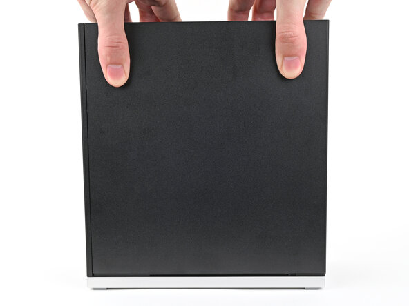

  41. Framework Desktop Case Replacement, Remove the Right Panel: Schritt 41, Bild 1 von 3 Framework Desktop Case Replacement, Remove the Right Panel: Schritt 41, Bild 2 von 3 Framework Desktop Case Replacement, Remove the Right Panel: Schritt 41, Bild 3 von 3

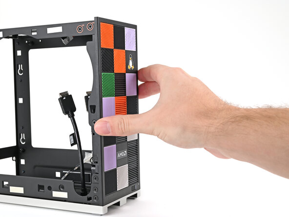

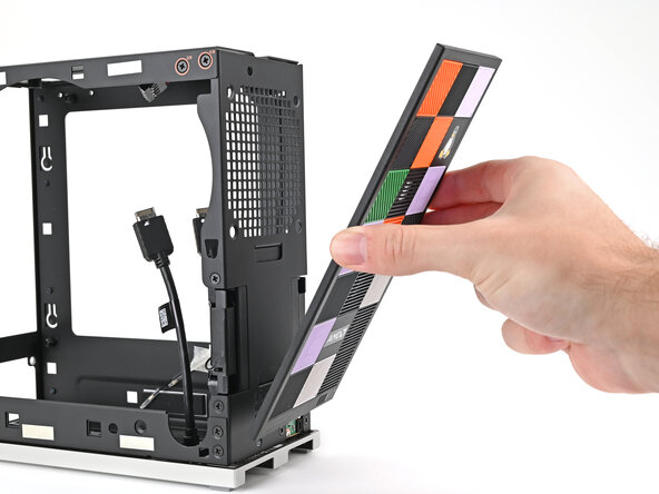

  42. Framework Desktop Case Replacement, Replace the Front Panel: Schritt 42, Bild 1 von 3 Framework Desktop Case Replacement, Replace the Front Panel: Schritt 42, Bild 2 von 3 Framework Desktop Case Replacement, Replace the Front Panel: Schritt 42, Bild 3 von 3
    • Use your fingers to pull the Front Panel off the magnets securing it to the chassis.
    • Follow this guide to transfer your Tiles to the new Front Panel or to install the old Front Panel.

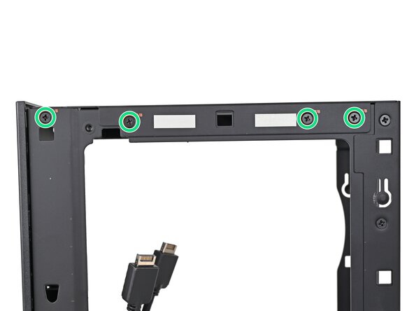

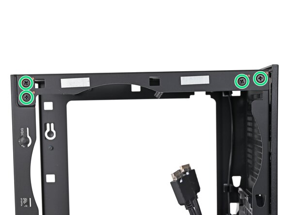

  43. Framework Desktop Case Replacement, Remove the top plate screws: Schritt 43, Bild 1 von 3 Framework Desktop Case Replacement, Remove the top plate screws: Schritt 43, Bild 2 von 3 Framework Desktop Case Replacement, Remove the top plate screws: Schritt 43, Bild 3 von 3

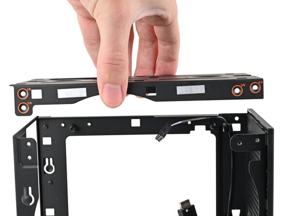

  44. Framework Desktop Case Replacement, Remove the top plate: Schritt 44, Bild 1 von 2 Framework Desktop Case Replacement, Remove the top plate: Schritt 44, Bild 2 von 2

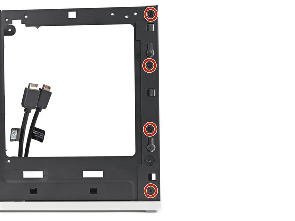

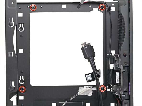

  45. Framework Desktop Case Replacement, Remove the Mainboard screws: Schritt 45, Bild 1 von 2 Framework Desktop Case Replacement, Remove the Mainboard screws: Schritt 45, Bild 2 von 2
    • Use your Framework Desktop Screwdriver to remove the four 8.2 mm‑long Phillips screws in the Mainboard screw posts.

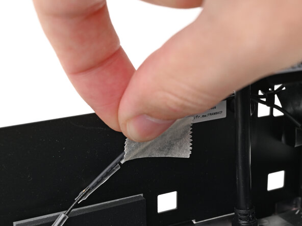

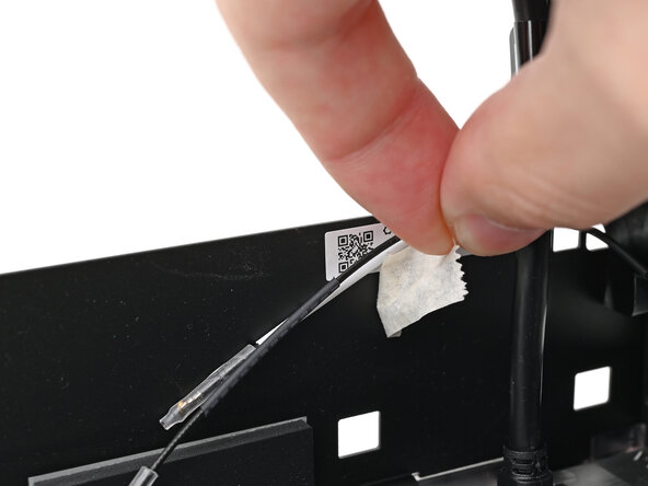

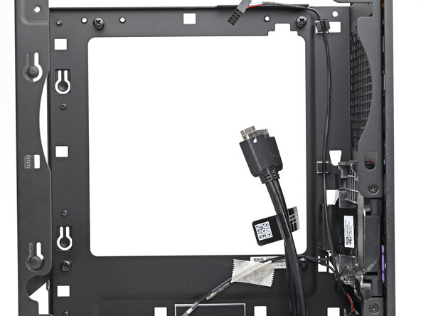

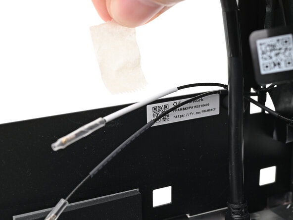

  48. Framework Desktop Case Replacement, Remove the tape: Schritt 48, Bild 1 von 3 Framework Desktop Case Replacement, Remove the tape: Schritt 48, Bild 2 von 3 Framework Desktop Case Replacement, Remove the tape: Schritt 48, Bild 3 von 3
    • Peel off the tape covering the antenna cables.

  63. Framework Desktop Case Replacement, Place the top plate: Schritt 63, Bild 1 von 2 Framework Desktop Case Replacement, Place the top plate: Schritt 63, Bild 2 von 2
    • Place the top plate on top of the Desktop, making sure it slots into the chassis so the orange circles are visible.
  64. Framework Desktop Case Replacement: Schritt 64, Bild 1 von 2 Framework Desktop Case Replacement: Schritt 64, Bild 2 von 2
    • Make sure the matching screw hole on the top plate labeled "5/8" is slotted on the inside of the Chassis so that the orange circle is visible.
  65. Framework Desktop Case Replacement, Install the top plate screws: Schritt 65, Bild 1 von 3 Framework Desktop Case Replacement, Install the top plate screws: Schritt 65, Bild 2 von 3 Framework Desktop Case Replacement, Install the top plate screws: Schritt 65, Bild 3 von 3
    • While holding the Desktop steady, use your Framework Desktop Screwdriver to install the eight 4.0 mm‑long Phillips screws securing the top plate.
  66. Framework Desktop Case Replacement, Install the Right Panel: Schritt 66, Bild 1 von 3 Framework Desktop Case Replacement, Install the Right Panel: Schritt 66, Bild 2 von 3 Framework Desktop Case Replacement, Install the Right Panel: Schritt 66, Bild 3 von 3
    • Slide the Right Panel onto the right edge of the chassis, from top to bottom, and press it flat to ensure its clips are slotted into place.
    • There should be a small gap between the bottom of the Right Panel and the silver base.
    • Push the Right Panel towards the base of the computer to engage the clips.

  78. Framework Desktop Case Replacement, Install the Left Panel: Schritt 78, Bild 1 von 3 Framework Desktop Case Replacement, Install the Left Panel: Schritt 78, Bild 2 von 3 Framework Desktop Case Replacement, Install the Left Panel: Schritt 78, Bild 3 von 3
    • Slide the Left Panel onto the left edge of the chassis and press it flat to ensure its clips are slotted into place.
    • There should be a small gap between the bottom of the Left Panel and the silver base.
    • Push the Left Panel towards the base of the computer to close the gap and engage the clips.
  79. Framework Desktop Case Replacement, Install the Top Panel: Schritt 79, Bild 1 von 3 Framework Desktop Case Replacement, Install the Top Panel: Schritt 79, Bild 2 von 3 Framework Desktop Case Replacement, Install the Top Panel: Schritt 79, Bild 3 von 3
    • Orient the Top Panel so its arrow is pointing towards the rear of the computer.
    • While holding the Top Panel at a slight downward angle, slide it across the top of the chassis (from rear to front) until you feel its clips catch.
    • There should be a small gap between the Top Panel and the front of the Desktop.
    • Lay the Top Panel flat on the chassis to align the remaining clips.
  80. Framework Desktop Case Replacement: Schritt 80, Bild 1 von 2 Framework Desktop Case Replacement: Schritt 80, Bild 2 von 2
    • While securing the computer with one hand, use the other hand to slide the Top Panel towards the front of the computer to close the gap and engage the clips.

  82. Framework Desktop Case Replacement, Install the top panel screws: Schritt 82, Bild 1 von 3 Framework Desktop Case Replacement, Install the top panel screws: Schritt 82, Bild 2 von 3 Framework Desktop Case Replacement, Install the top panel screws: Schritt 82, Bild 3 von 3
    • Insert the top panel screw into its hole and twist clockwise until it feels snug.
  83. Framework Desktop Case Replacement: Schritt 83, Bild 1 von 3 Framework Desktop Case Replacement: Schritt 83, Bild 2 von 3 Framework Desktop Case Replacement: Schritt 83, Bild 3 von 3
    • Repeat the same procedure for the other top panel screw.
  84. Framework Desktop Case Replacement: Schritt 84, Bild 1 von 3 Framework Desktop Case Replacement: Schritt 84, Bild 2 von 3 Framework Desktop Case Replacement: Schritt 84, Bild 3 von 3
    • Use your finger to close the two D-rings on the top panel screws.
