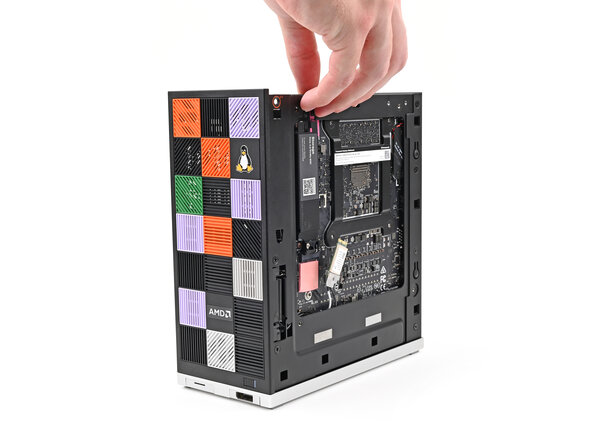

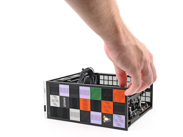

  7. Framework Desktop Mainboard Replacement, Remove the Left Panel: Schritt 7, Bild 1 von 3 Framework Desktop Mainboard Replacement, Remove the Left Panel: Schritt 7, Bild 2 von 3 Framework Desktop Mainboard Replacement, Remove the Left Panel: Schritt 7, Bild 3 von 3
    • Use your fingers to grip the top of the Left Panel and slide it upward to release its clips.
    • Remove the Left Panel.

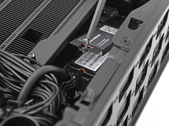

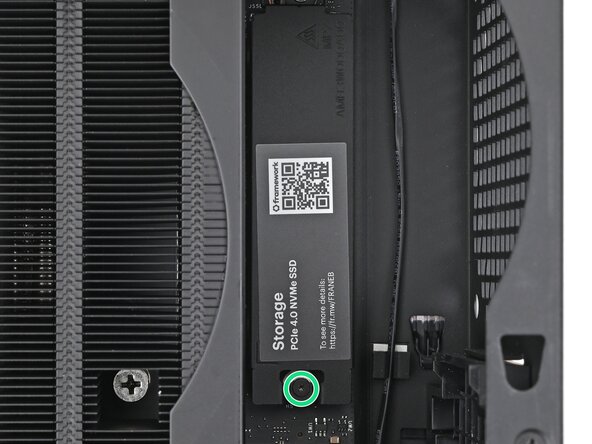

  8. Framework Desktop Mainboard Replacement, Loosen the SSD screw: Schritt 8, Bild 1 von 2 Framework Desktop Mainboard Replacement, Loosen the SSD screw: Schritt 8, Bild 2 von 2
    • Use your Framework Desktop Screwdriver to loosen the captive T5 Torx screw securing the SSD.
    • The SSD and its heat spreader will pop up to an angle when its screw is fully loosened.

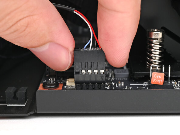

  12. Framework Desktop Mainboard Replacement, Disconnect the fan: Schritt 12, Bild 1 von 2 Framework Desktop Mainboard Replacement, Disconnect the fan: Schritt 12, Bild 2 von 2
    • Use your fingers to lift the APU fan cable connector off its four‑pronged socket on the Mainboard.

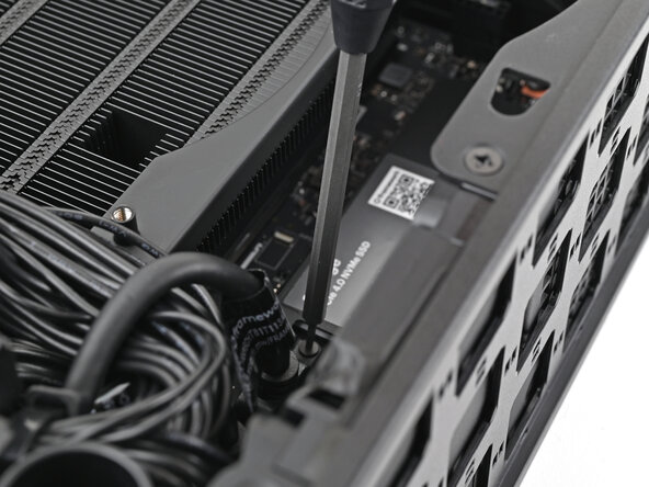

  14. Framework Desktop Mainboard Replacement, Remove the CPU fan screws: Schritt 14, Bild 1 von 2 Framework Desktop Mainboard Replacement, Remove the CPU fan screws: Schritt 14, Bild 2 von 2
    • Use your Framework Desktop Screwdriver to remove the four 27.3 mm‑long Phillips screws securing the CPU fan and fan duct.

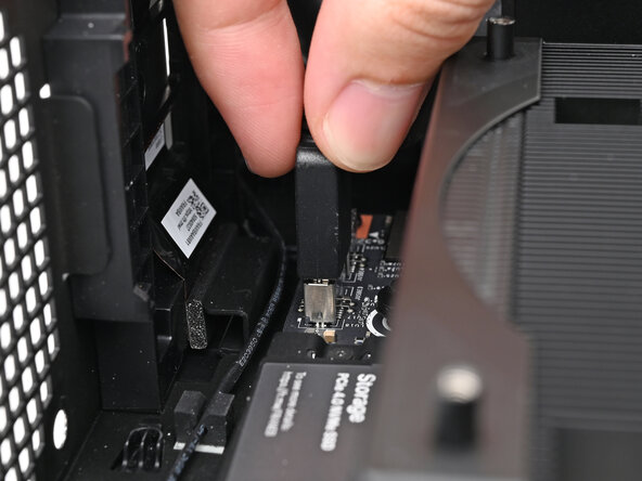

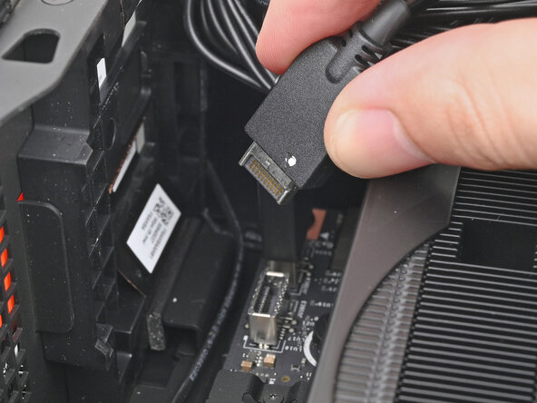

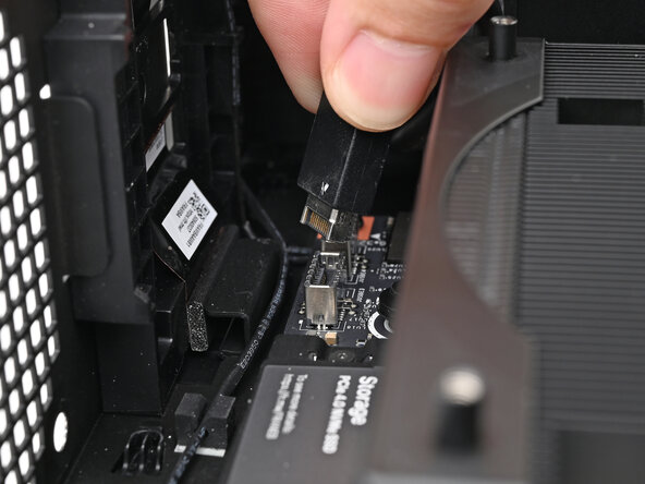

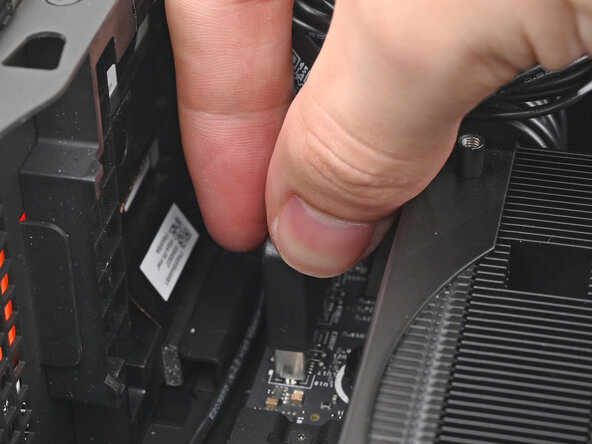

  17. Framework Desktop Mainboard Replacement, Disconnect the top Expansion Card cable: Schritt 17, Bild 1 von 2 Framework Desktop Mainboard Replacement, Disconnect the top Expansion Card cable: Schritt 17, Bild 2 von 2
    • Pull the top Expansion Card connector straight out of its socket in the Mainboard to disconnect it.

  20. Framework Desktop Mainboard Replacement, Disconnect the bottom Expansion Card cable: Schritt 20, Bild 1 von 2 Framework Desktop Mainboard Replacement, Disconnect the bottom Expansion Card cable: Schritt 20, Bild 2 von 2
    • Pull the bottom Expansion Card connector straight out of its socket in the Mainboard to disconnect it.

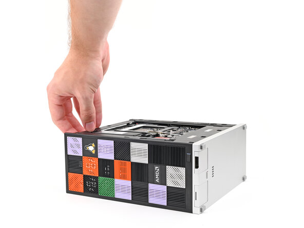

  25. Framework Desktop Mainboard Replacement, Reposition the Desktop: Schritt 25, Bild 1 von 2 Framework Desktop Mainboard Replacement, Reposition the Desktop: Schritt 25, Bild 2 von 2
    • Lay the left side of the Desktop on your work surface so the underside of the Mainboard is facing upward.

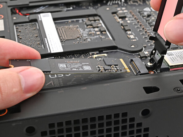

  27. Framework Desktop Mainboard Replacement, Remove the SSD: Schritt 27, Bild 1 von 2 Framework Desktop Mainboard Replacement, Remove the SSD: Schritt 27, Bild 2 von 2
    • While holding the heat spreader upright, grab the SSD by its edges and pull it out of its socket.
    • Remove the SSD.

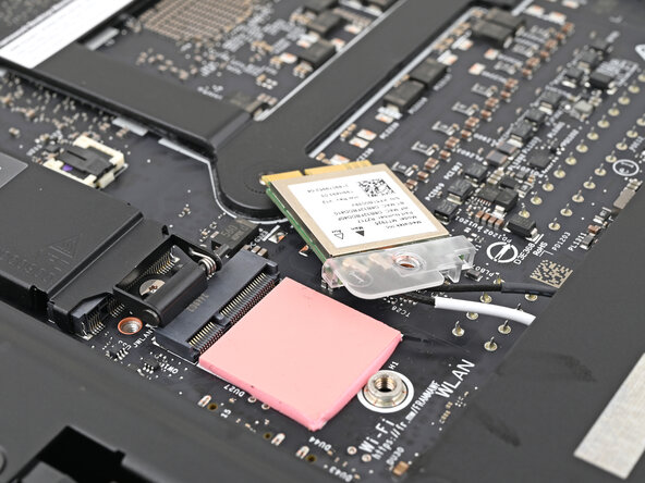

  29. Framework Desktop Mainboard Replacement, Remove the Wi-Fi Module screw: Schritt 29, Bild 1 von 2 Framework Desktop Mainboard Replacement, Remove the Wi-Fi Module screw: Schritt 29, Bild 2 von 2
    • Use your Framework Desktop Screwdriver to remove the 7.0 mm‑long Phillips screw securing the Wi-Fi module.

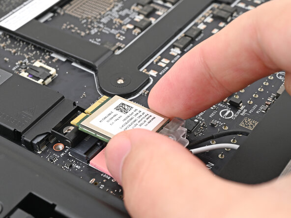

  30. Framework Desktop Mainboard Replacement, Disconnect the Wi-Fi module: Schritt 30, Bild 1 von 2 Framework Desktop Mainboard Replacement, Disconnect the Wi-Fi module: Schritt 30, Bild 2 von 2
    • Grip the Wi-Fi module by its edges and pull it straight out of its socket.
  31. Framework Desktop Mainboard Replacement, Reposition the Wi-Fi module: Schritt 31, Bild 1 von 3 Framework Desktop Mainboard Replacement, Reposition the Wi-Fi module: Schritt 31, Bild 2 von 3 Framework Desktop Mainboard Replacement, Reposition the Wi-Fi module: Schritt 31, Bild 3 von 3
    • Move the Wi-Fi module towards the center of the Mainboard to keep it out of the way.

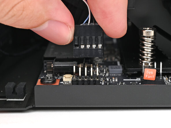

  33. Framework Desktop Mainboard Replacement, Disconnect the power button: Schritt 33, Bild 1 von 2 Framework Desktop Mainboard Replacement, Disconnect the power button: Schritt 33, Bild 2 von 2
    • Use your fingers to lift the power button cable connector off its nine‑pronged socket on the Mainboard.

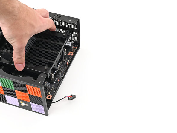

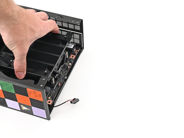

    • Grab the Mainboard by its heatsink and pull it towards the front of the Desktop to slide it out of the rear port cutout.
    • Slide the Mainboard towards the top of the Desktop to remove it from the chassis.

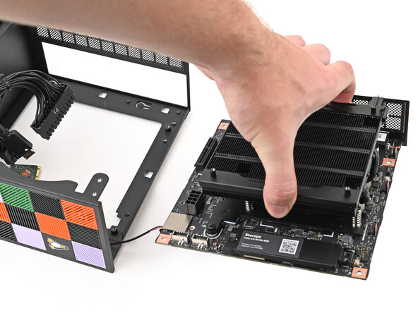

  37. Framework Desktop Mainboard Replacement, Place the Mainboard: Schritt 37, Bild 1 von 3 Framework Desktop Mainboard Replacement, Place the Mainboard: Schritt 37, Bild 2 von 3 Framework Desktop Mainboard Replacement, Place the Mainboard: Schritt 37, Bild 3 von 3
    • Grab the Mainboard by its heatsink and slide it into the chassis.
    • Align the rear ports with its cutout and the screw posts with the screw holes on the Mainboard.
    • You'll feel the Mainboard rest onto the screw posts when it's aligned properly.
    • Make sure no cables are trapped underneath the Mainboard before continuing.

  39. Framework Desktop Mainboard Replacement, Connect the power button: Schritt 39, Bild 1 von 2 Framework Desktop Mainboard Replacement, Connect the power button: Schritt 39, Bild 2 von 2
    • Slide the power button cable over the nine-pronged connector on the Mainboard.

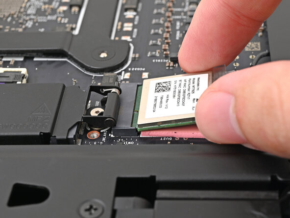

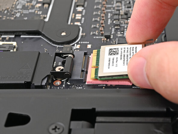

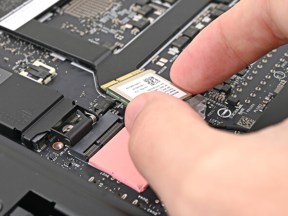

  41. Framework Desktop Mainboard Replacement, Install the Wi-Fi module: Schritt 41, Bild 1 von 2 Framework Desktop Mainboard Replacement, Install the Wi-Fi module: Schritt 41, Bild 2 von 2
    • Hold the Wi-Fi module by its edges. Don't touch the gold contacts with your fingers. If you do, wipe the contacts with a clean, lint-free cloth to remove any finger oils.
    • Align the Wi-Fi module's gold contacts and notch with the socket on the Mainboard.
    • Insert the Wi-Fi module into the socket at a shallow angle. The gold contacts should mostly be covered by the socket.
    • The Wi-Fi module fits into the socket in one orientation. If it doesn't fit, try flipping the module.
  42. Framework Desktop Mainboard Replacement, Install the Wi-Fi module screw: Schritt 42, Bild 1 von 2 Framework Desktop Mainboard Replacement, Install the Wi-Fi module screw: Schritt 42, Bild 2 von 2
    • Use your Framework Desktop Screwdriver to install the 7.0 mm‑long Phillips screw securing the Wi-Fi module.

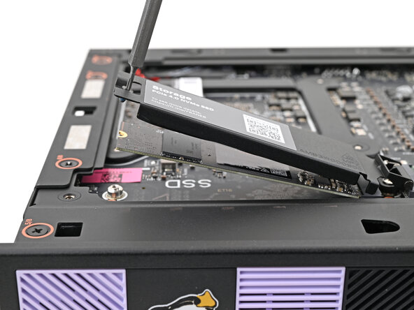

  43. Framework Desktop Mainboard Replacement, Loosen the heat spreader screw: Schritt 43, Bild 1 von 1
    • Use your Framework Desktop Screwdriver to loosen the captive T5 Torx screw securing the heat spreader.

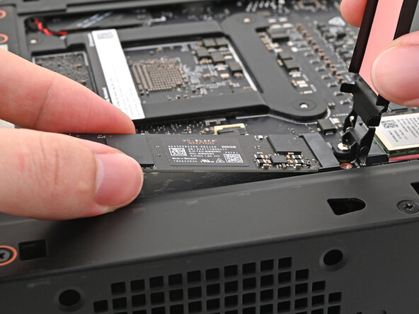

  44. Framework Desktop Mainboard Replacement, Install the SSD: Schritt 44, Bild 1 von 2 Framework Desktop Mainboard Replacement, Install the SSD: Schritt 44, Bild 2 von 2
    • If you want to install secondary storage, follow the next two steps. Otherwise, skip here.
    • Hold the SSD by its edges. Don't touch the gold contacts with your fingers. If you do, wipe the contacts with a clean, lint-free cloth to remove any finger oils.
    • While holding the SSD heat spreader upright, align the SSD's gold contacts with its socket.
    • Insert the SSD into the socket at a shallow angle. The gold contacts should mostly be covered by the socket.
    • The SSD fits into the socket in one orientation. If it doesn't feel like it fits, try flipping the module.
    • Lay the heat spreader back onto the SSD.

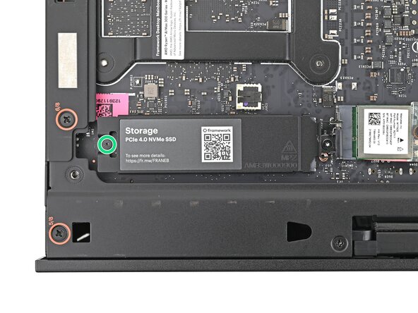

  45. Framework Desktop Mainboard Replacement, Install the SSD screw: Schritt 45, Bild 1 von 1
    • Use your Framework Desktop Screwdriver to tighten the captive T5 Torx screw securing the SSD.

  51. Framework Desktop Mainboard Replacement, Reposition the Mainboard: Schritt 51, Bild 1 von 2 Framework Desktop Mainboard Replacement, Reposition the Mainboard: Schritt 51, Bild 2 von 2
    • Lay the right side of the Desktop on your work surface so the Mainboard is facing upward.
  52. Framework Desktop Mainboard Replacement, Connect the bottom Expansion Card cable: Schritt 52, Bild 1 von 2 Framework Desktop Mainboard Replacement, Connect the bottom Expansion Card cable: Schritt 52, Bild 2 von 2
    • Slide the bottom Expansion Card cable into its socket on the Mainboard.

  55. Framework Desktop Mainboard Replacement, Connect the top Expansion Card cable: Schritt 55, Bild 1 von 2 Framework Desktop Mainboard Replacement, Connect the top Expansion Card cable: Schritt 55, Bild 2 von 2
    • Slide the top Expansion Card cable into its socket on the Mainboard.

  60. Framework Desktop Mainboard Replacement, Connect the fan: Schritt 60, Bild 1 von 2 Framework Desktop Mainboard Replacement, Connect the fan: Schritt 60, Bild 2 von 2
    • Orient the main fan cable so its two vertical lines are facing you.
    • Slide the main fan cable over the four-pronged connector labeled "APU Fan," making sure the orange label slots between the vertical lines.

  62. Framework Desktop Mainboard Replacement, Loosen the heat spreader screw: Schritt 62, Bild 1 von 1
  63. Framework Desktop Mainboard Replacement, Install the SSD: Schritt 63, Bild 1 von 2 Framework Desktop Mainboard Replacement, Install the SSD: Schritt 63, Bild 2 von 2
    • While holding the heat spreader upright, align the SSD's gold contacts with its socket.
  64. Framework Desktop Mainboard Replacement, Install the SSD screw: Schritt 64, Bild 1 von 3 Framework Desktop Mainboard Replacement, Install the SSD screw: Schritt 64, Bild 2 von 3 Framework Desktop Mainboard Replacement, Install the SSD screw: Schritt 64, Bild 3 von 3
    • Insert your Framework Desktop Screwdriver into the captive screw on the primary storage heat spreader and press it flat to the Mainboard.
    • Tighten the screw securing the SSD.
  65. Framework Desktop Mainboard Replacement, Install the Left Panel: Schritt 65, Bild 1 von 3 Framework Desktop Mainboard Replacement, Install the Left Panel: Schritt 65, Bild 2 von 3 Framework Desktop Mainboard Replacement, Install the Left Panel: Schritt 65, Bild 3 von 3
    • Slide the Left Panel onto the left edge of the chassis and press it flat to ensure its clips are slotted into place.
    • There should be a small gap between the bottom of the Left Panel and the silver base.
    • Push the Left Panel towards the base of the computer to close the gap and engage the clips.
  66. Framework Desktop Mainboard Replacement, Install the Top Panel: Schritt 66, Bild 1 von 3 Framework Desktop Mainboard Replacement, Install the Top Panel: Schritt 66, Bild 2 von 3 Framework Desktop Mainboard Replacement, Install the Top Panel: Schritt 66, Bild 3 von 3
    • Orient the Top Panel so its arrow is pointing towards the rear of the computer.
    • While holding the Top Panel at a slight downward angle, slide it across the top of the chassis (from rear to front) until you feel its clips catch.
    • There should be a small gap between the Top Panel and the front of the Desktop.
    • Lay the Top Panel flat on the chassis to align the remaining clips.
  67. Framework Desktop Mainboard Replacement: Schritt 67, Bild 1 von 2 Framework Desktop Mainboard Replacement: Schritt 67, Bild 2 von 2
    • While securing the computer with one hand, use the other hand to slide the Top Panel towards the front of the computer to close the gap and engage the clips.
