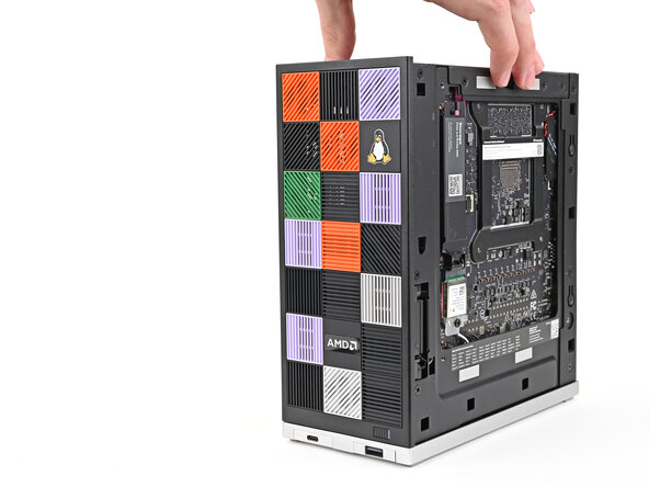

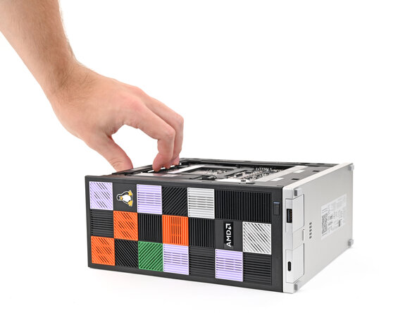

  7. Framework Desktop Wi-Fi Module Replacement, Reposition the Desktop: Schritt 7, Bild 1 von 2 Framework Desktop Wi-Fi Module Replacement, Reposition the Desktop: Schritt 7, Bild 2 von 2
    • Lay the left side of the Desktop on your work surface so the underside of the Mainboard is facing upward.

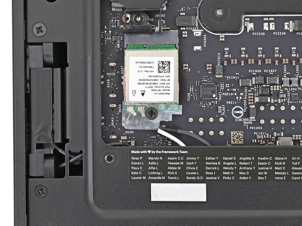

  8. Framework Desktop Wi-Fi Module Replacement, Remove the Wi-Fi Module screw: Schritt 8, Bild 1 von 2 Framework Desktop Wi-Fi Module Replacement, Remove the Wi-Fi Module screw: Schritt 8, Bild 2 von 2
    • Use your Framework Desktop Screwdriver to remove the 7.0 mm‑long Phillips screw securing the Wi-Fi module.

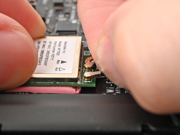

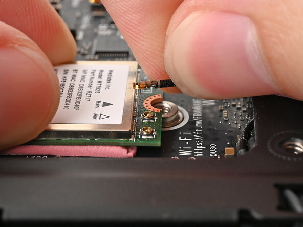

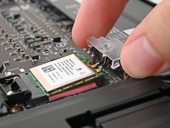

  10. Framework Desktop Wi-Fi Module Replacement, Disconnect the Wi-Fi Module: Schritt 10, Bild 1 von 3 Framework Desktop Wi-Fi Module Replacement, Disconnect the Wi-Fi Module: Schritt 10, Bild 2 von 3 Framework Desktop Wi-Fi Module Replacement, Disconnect the Wi-Fi Module: Schritt 10, Bild 3 von 3
    • The Wi-Fi module has two delicate coaxial cable connectors. Follow this step carefully to avoid damaging them.
    • Press and hold the Wi-Fi module down with your fingers.
    • Use your fingers to grip the white antenna cable, as close to the metal head as possible.
    • If you have angled tweezers, slide one arm of a pair of tweezers under the antenna connector, as close to the metal head as possible.
    • Gently lift the connector straight up to disconnect the white antenna cable.
    • Repeat the procedure with the black antenna cable.

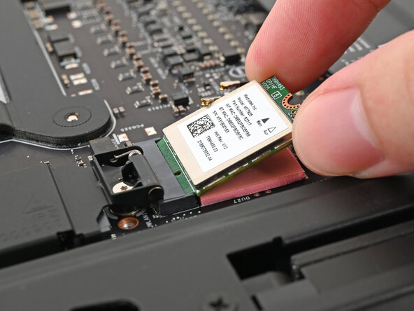

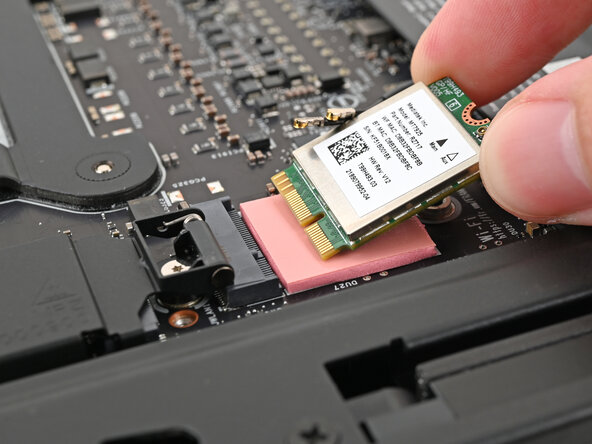

  11. Framework Desktop Wi-Fi Module Replacement, Remove the Wi-Fi module: Schritt 11, Bild 1 von 2 Framework Desktop Wi-Fi Module Replacement, Remove the Wi-Fi module: Schritt 11, Bild 2 von 2
    • Grip the Wi-Fi module by its edges and pull it straight out of its socket.
    • Remove the Wi-Fi module.

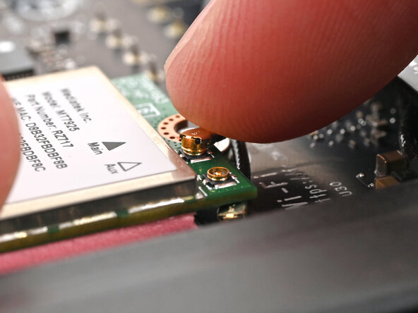

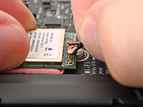

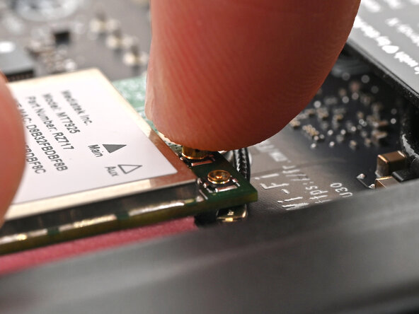

  14. Framework Desktop Wi-Fi Module Replacement, Connect the Wi-Fi Module: Schritt 14, Bild 1 von 3 Framework Desktop Wi-Fi Module Replacement, Connect the Wi-Fi Module: Schritt 14, Bild 2 von 3 Framework Desktop Wi-Fi Module Replacement, Connect the Wi-Fi Module: Schritt 14, Bild 3 von 3
    • Hold the Wi-Fi module down with your fingers.
    • Position the black antenna cable connector over the left Wi-Fi module's coaxial socket.
    • Tweezers can help position the connector.
    • Use your finger to press the connector into place. You should feel a faint click, and the cable will stay attached to the socket by itself.
    • These connectors are very delicate! If the connector doesn't feel like it's clicking in place, reposition the connector and try again.
    • Repeat the procedure with the white antenna cable.

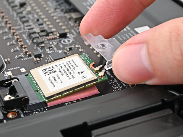

  15. Framework Desktop Wi-Fi Module Replacement: Schritt 15, Bild 1 von 3 Framework Desktop Wi-Fi Module Replacement: Schritt 15, Bild 2 von 3 Framework Desktop Wi-Fi Module Replacement: Schritt 15, Bild 3 von 3
    • Hook the Wi-Fi bracket over the corner of the Wi-Fi module opposite the antenna cables.
    • Rotate the bracket over the Wi-Fi module, making sure the screw hole isn't being obstructed by the antenna cables.

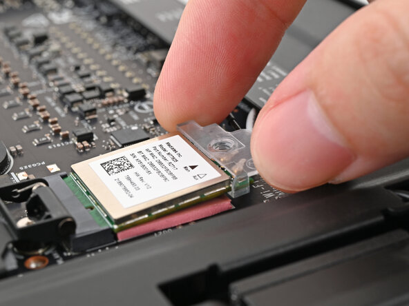

  16. Framework Desktop Wi-Fi Module Replacement, Install the Wi-Fi module screw: Schritt 16, Bild 1 von 2 Framework Desktop Wi-Fi Module Replacement, Install the Wi-Fi module screw: Schritt 16, Bild 2 von 2
    • Use your Framework Desktop Screwdriver to install the screw securing the Wi-Fi module.
