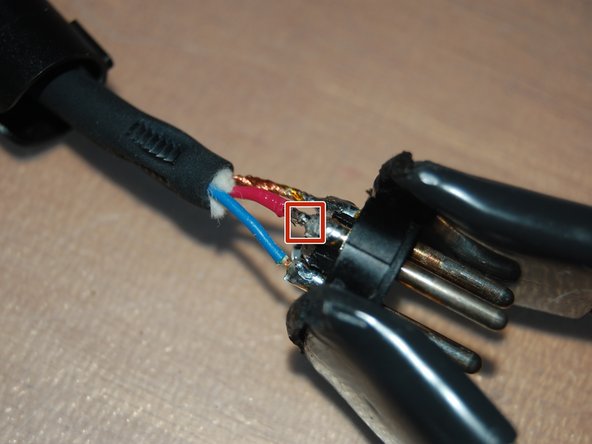

    • We need to first identify the connecting end that is causing the issue.
    • To do that, un-screw the black plastic bottom part of the base that connects to the connecting end.

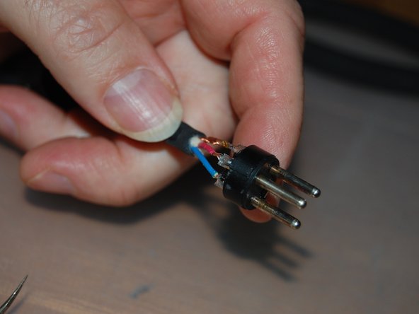

  2. How to Re-Solder a Wire in an Unresponsive XLR Cable: Schritt 2, Bild 1 von 2 How to Re-Solder a Wire in an Unresponsive XLR Cable: Schritt 2, Bild 2 von 2
    • Remove the connecting end from its base.
    • Remove the sleeve protecting the soldered connectors, exposing them.
  3. How to Re-Solder a Wire in an Unresponsive XLR Cable: Schritt 3, Bild 1 von 1
    • Identify the problem (check if the wire is severed or detached from the soldered connecting point).
    • In this case, the red wire is detached from the soldered connecting point.

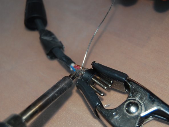

    • Pre-heat the soldering iron and leave it resting on an elevated surface (like the mount in the image).
    • Do not touch the tip of the iron. Once it pre-heats, it is extremely hot
    • Use a clamp to hold the connecting end in place since you are going to need both bands when using a soldering iron.
  6. How to Re-Solder a Wire in an Unresponsive XLR Cable: Schritt 6, Bild 1 von 3 How to Re-Solder a Wire in an Unresponsive XLR Cable: Schritt 6, Bild 2 von 3 How to Re-Solder a Wire in an Unresponsive XLR Cable: Schritt 6, Bild 3 von 3
    • Use the soldering iron to melt solder and connect the wire to the connecting ends
    • Make sure that the soldered wire is positioned directly on top of the connector while essencially being glued down with the solder (it would be the most secure when thats the case).
