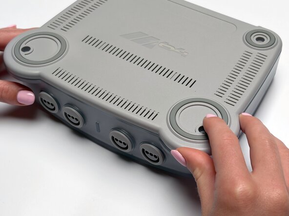

    3. ModRetro M64 Disassembly, Bottom Screws: Schritt 3, Bild 1 von 3 ModRetro M64 Disassembly, Bottom Screws: Schritt 3, Bild 2 von 3 ModRetro M64 Disassembly, Bottom Screws: Schritt 3, Bild 3 von 3
      • Place the device on a soft, flat surface to avoid scratching the top shell.
      • Flip the M64 upside down to access the screws on the bottom.
      • Remove four gamebit 4.5mm screws using the Gamebit 4.5mm Screwdriver.

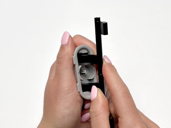

    9. ModRetro M64 Disassembly, Cart Eject (Linkage): Schritt 9, Bild 1 von 3 ModRetro M64 Disassembly, Cart Eject (Linkage): Schritt 9, Bild 2 von 3 ModRetro M64 Disassembly, Cart Eject (Linkage): Schritt 9, Bild 3 von 3
      • Twist the linkage clockwise or counterclockwise and pull one end out of the button housing, then set both parts aside.
      • Insert one side of the linkage alignment tab into the button pocket at an angle, then press the opposite side into place.
      • Double-check that the linkage is seated in the cartridge carrier (tub) with its flap facing inward.

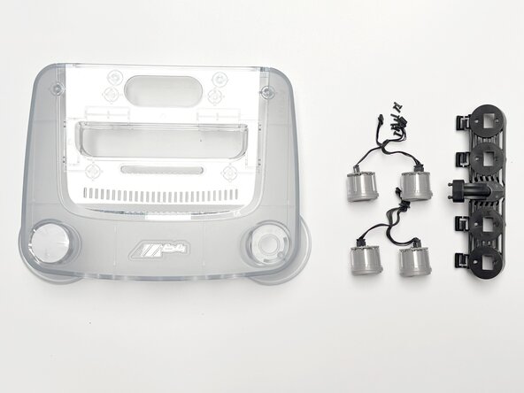

    10. ModRetro M64 Disassembly, LED Bar: Schritt 10, Bild 1 von 2 ModRetro M64 Disassembly, LED Bar: Schritt 10, Bild 2 von 2
      • Pinch the LED bar and pull it straight up to remove it, then set it aside.
      • The LED bar is press-fit, so you will feel some resistance when pulling.
