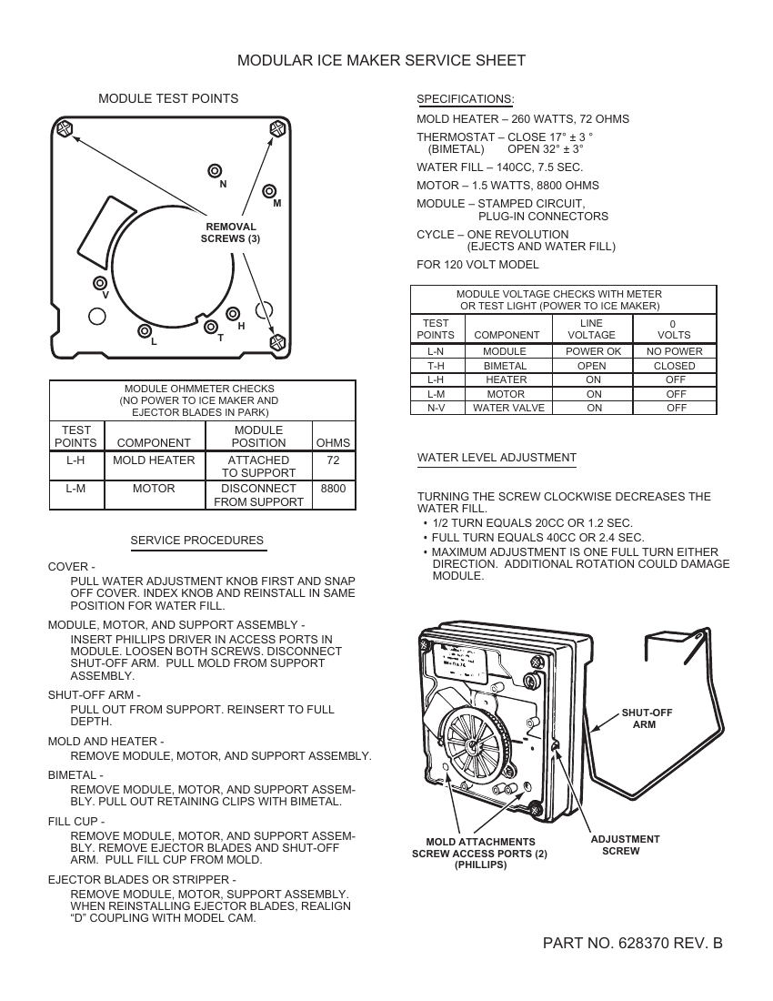

MODULAR ICE MAKER SERVICE SHEET
MODULE TEST POINTS
MODULE OHMMETER CHECKS (NO POWER TO ICE MAKER AND EJECTOR BLADES IN PARK)
POINTS TESTCOMPONENTPOSITION MODULEOHMS
L-HMOLD HEATERATTACHED TO SUPPORT72
L-MMOTORDISCONNECT FROM SUPPORT8800

SERVICE PROCEDURES
COVER -
PULL WATER ADJUSTMENT KNOB FIRST AND SNAP OFF COVER. INDEX KNOB AND REINSTALL IN SAME POSITION FOR WATER FILL.
MODULE, MOTOR, AND SUPPORT ASSEMBLY -
INSERT PHILLIPS DRIVER IN ACCESS PORTS IN MODULE. LOOSEN BOTH SCREWS. DISCONNECT SHUT-OFF ARM. PULL MOLD FROM SUPPORT ASSEMBLY.
SHUT-OFF ARM -
PULL OUT FROM SUPPORT. REINSERT TO FULL DEPTH.
MOLD AND HEATER -
REMOVE MODULE, MOTOR, AND SUPPORT ASSEMBLY.
BIMETAL -
REMOVE MODULE, MOTOR, AND SUPPORT ASSEMBLY. PULL OUT RETAINING CLIPS WITH BIMETAL.
FILL CUP -
REMOVE MODULE, MOTOR, AND SUPPORT ASSEMBLY. REMOVE EJECTOR BLADES AND SHUT-OFF ARM. PULL FILL CUP FROM MOLD.
EJECTOR BLADES OR STRIPPER -
REMOVE MODULE, MOTOR, SUPPORT ASSEMBLY. WHEN REINSTALLING EJECTOR BLADES, REALIGN 'D' COUPLING WITH MODEL CAM.
SPECIFICATIONS:
MOLD HEATER - 260 WATTS, 72 OHMS
THERMOSTAT - CLOSE 17° ± 3 ° (BIMETAL) OPEN 32° ± 3°
WATER FILL - 140CC, 7.5 SEC.
MOTOR - 1.5 WATTS, 8800 OHMS
MODULE - STAMPED CIRCUIT, PLUG-IN CONNECTORS
CYCLE - ONE REVOLUTION (EJECTS AND WATER FILL)
FOR 120 VOLT MODEL
MODULE VOLTAGE CHECKS WITH METER OR TEST LIGHT (POWER TO ICE MAKER)
POINTS TESTCOMPONENTVOLTAGE LINEVOLTS 0
L-NMODULEPOWER OKNO POWER
T-HBIMETALOPENCLOSED
L-HHEATERONOFF
L-MMOTORONOFF
N-VWATER VALVEONOFF
Table Caption: This table outlines voltage checks for an ice maker module, specifying test points, components, expected voltage readings, and the condition indicated by zero volts. It details how to test the power supply and key components like the bimetal, heater, motor, and water valve.
WATER LEVEL ADJUSTMENT
TURNING THE SCREW CLOCKWISE DECREASES THE WATER FILL.
  • 1/2 TURN EQUALS 20CC OR 1.2 SEC.
  • FULL TURN EQUALS 40CC OR 2.4 SEC.
  • MAXIMUM ADJUSTMENT IS ONE FULL TURN EITHER DIRECTION. ADDITIONAL ROTATION COULD DAMAGE MODULE.
