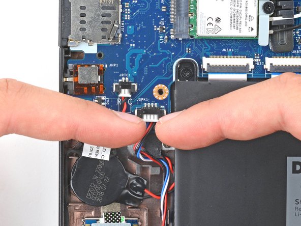

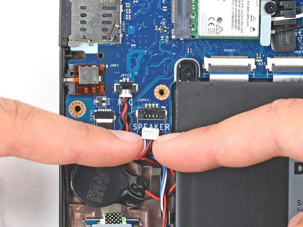

  9. Dell Latitude 7490 Speakers Replacement, Disconnect the speakers: Schritt 9, Bild 1 von 3 Dell Latitude 7490 Speakers Replacement, Disconnect the speakers: Schritt 9, Bild 2 von 3 Dell Latitude 7490 Speakers Replacement, Disconnect the speakers: Schritt 9, Bild 3 von 3
    • Use clean fingernails to pull the speaker connector out of its socket on motherboard's bottom left corner.
    • If your fingernails aren't long enough, use a spudger to push on alternating sides of the connector and "walk" it out of its socket.

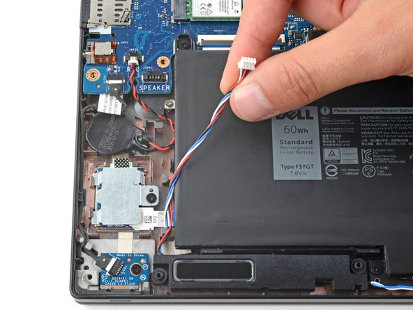

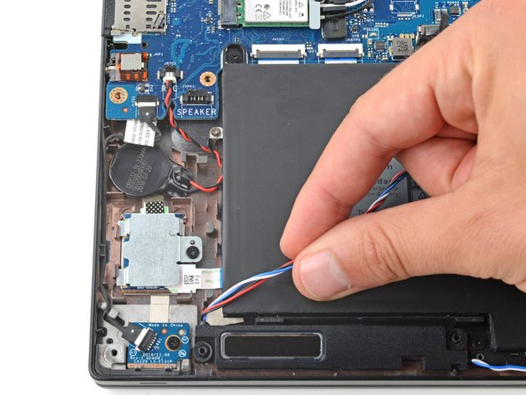

  10. Dell Latitude 7490 Speakers Replacement, Reposition the speaker wire: Schritt 10, Bild 1 von 3 Dell Latitude 7490 Speakers Replacement, Reposition the speaker wire: Schritt 10, Bild 2 von 3 Dell Latitude 7490 Speakers Replacement, Reposition the speaker wire: Schritt 10, Bild 3 von 3
    • Use your fingers to guide the speaker wire out of its clips near the left edge of the battery.

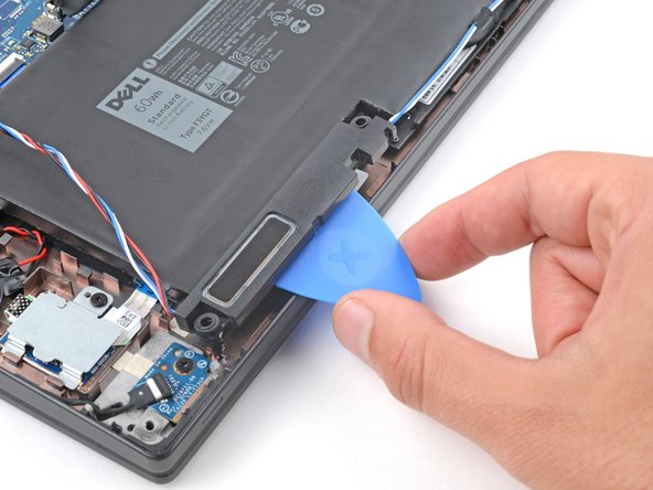

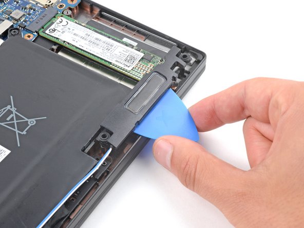

  11. Dell Latitude 7490 Speakers Replacement, Pry up the speakers: Schritt 11, Bild 1 von 3 Dell Latitude 7490 Speakers Replacement, Pry up the speakers: Schritt 11, Bild 2 von 3 Dell Latitude 7490 Speakers Replacement, Pry up the speakers: Schritt 11, Bild 3 von 3
    • The speakers are secured to the frame with rubber grommets.
    • Insert the flat side of an opening pick between the bottom edge of the left speaker and frame.
    • Pry the speaker up to free it from the frame.
    • Use the same process to free the right speaker.

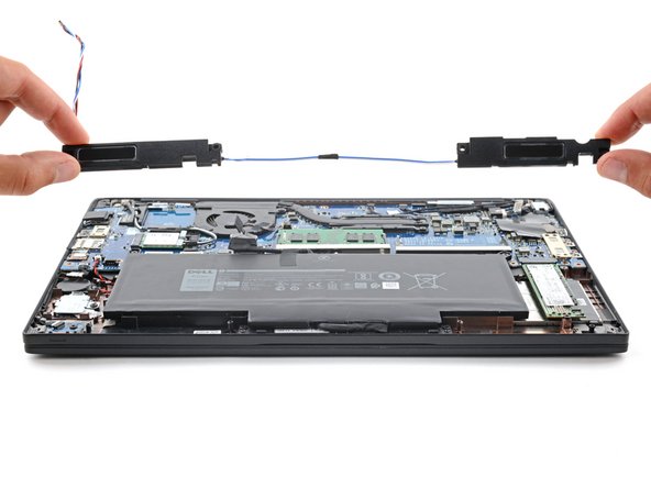

  12. Dell Latitude 7490 Speakers Replacement, Remove the speakers: Schritt 12, Bild 1 von 2 Dell Latitude 7490 Speakers Replacement, Remove the speakers: Schritt 12, Bild 2 von 2
    • Remove the speakers.
    • To reinstall a speaker, line the grommets up with their posts in the frame and push the speakers down to secure them.
