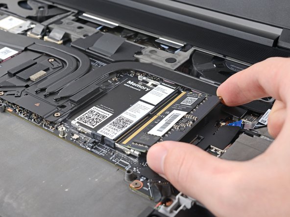

  14. Framework Laptop 16" RAM Replacement, Remove the RAM: Schritt 14, Bild 1 von 3 Framework Laptop 16" RAM Replacement, Remove the RAM: Schritt 14, Bild 2 von 3 Framework Laptop 16" RAM Replacement, Remove the RAM: Schritt 14, Bild 3 von 3
    • Push the two metal arms on each side of the RAM stick outward until they disengage and the stick pops up at a shallow angle.
    • Repeat for the other RAM stick.
  15. Framework Laptop 16" RAM Replacement: Schritt 15, Bild 1 von 3 Framework Laptop 16" RAM Replacement: Schritt 15, Bild 2 von 3 Framework Laptop 16" RAM Replacement: Schritt 15, Bild 3 von 3
    • Slide the RAM stick out of its socket and remove it.
    • During reassembly, insert the RAM sticks into their sockets at a slight downward angle, then push down firmly until both metal arms lock the sticks in place.
