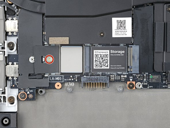

  14. Framework Laptop 16" SSD Replacement, Remove the SSD screw: Schritt 14, Bild 1 von 2 Framework Laptop 16" SSD Replacement, Remove the SSD screw: Schritt 14, Bild 2 von 2
    • Use a T5 Torx screwdriver to remove the 2 mm‑long screw securing the SSD.
    • The SSD might pop up at a shallow angle when you remove the screw.
  15. Framework Laptop 16" SSD Replacement, Remove the SSD: Schritt 15, Bild 1 von 3 Framework Laptop 16" SSD Replacement, Remove the SSD: Schritt 15, Bild 2 von 3 Framework Laptop 16" SSD Replacement, Remove the SSD: Schritt 15, Bild 3 von 3
    • Grip the end of the SSD with the screw hole and slide it out of its socket.
    • Remove the SSD.
    • If you're installing a secondary M.2 2230 SSD, remove the 2 mm‑long screw next to the gray thermal pad and follow the same removal procedure.
    • During reassembly, insert the SSD at a shallow angle into its socket, and hold it flat to the laptop while you reinsert its screw.
