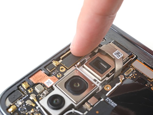

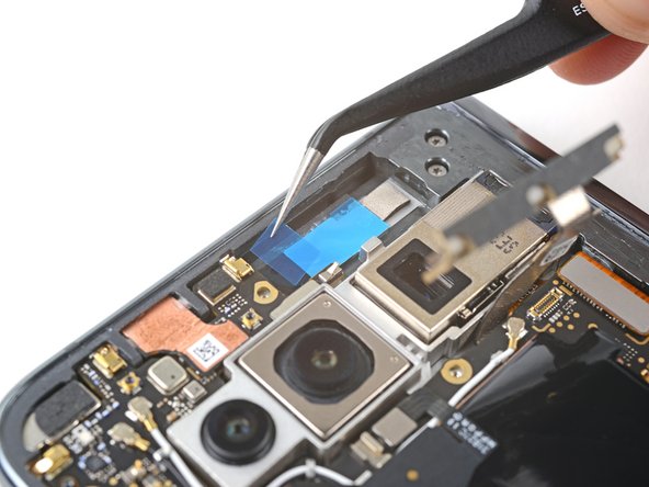

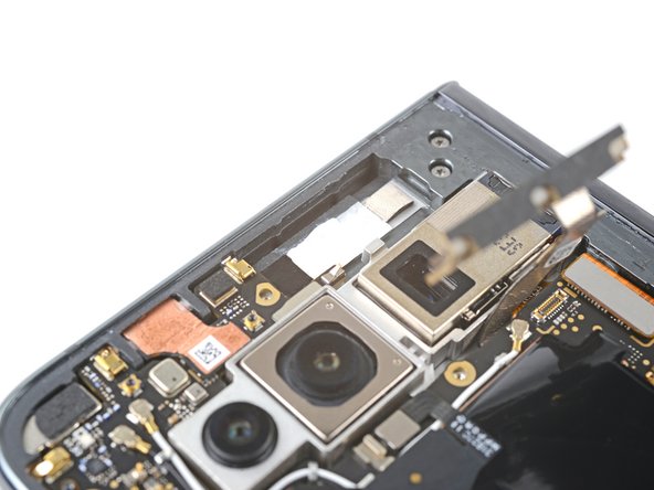

    • Look at the 5G mmWave antenna recess and note where the adhesive is located.
    • Your new adhesive doesn't have to align perfectly, but it should be close to the original locations.
    • Use a spudger and tweezers to remove any old adhesive.
