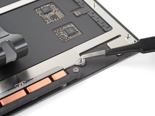

  22. MacBook Pro 16" Late 2023 Trackpad Replacement, Remove the trackpad: Schritt 22, Bild 1 von 3 MacBook Pro 16" Late 2023 Trackpad Replacement, Remove the trackpad: Schritt 22, Bild 2 von 3 MacBook Pro 16" Late 2023 Trackpad Replacement, Remove the trackpad: Schritt 22, Bild 3 von 3
    • Swing the display open slightly, but keep the MacBook upside-down. The trackpad assembly should separate and lay flat on the display.
    • As you remove the trackpad assembly, be very careful not to lose the nine small metal washers resting on the screw posts. (They will fly off and get lost with very little provocation.)
    • Carefully feed the trackpad's ribbon cable through its slot in the frame.
  23. MacBook Pro 16" Late 2023 Trackpad Replacement: Schritt 23, Bild 1 von 3 MacBook Pro 16" Late 2023 Trackpad Replacement: Schritt 23, Bild 2 von 3 MacBook Pro 16" Late 2023 Trackpad Replacement: Schritt 23, Bild 3 von 3
    • Remove the trackpad.
    • Make sure your new trackpad has a ribbon cable installed before reassembly. If necessary, transfer the old cable, or install the one your new trackpad came with.
    • Before installing your trackpad, make sure all nine washers are in place:
    • Four rectangular washers
    • Five circular washers
