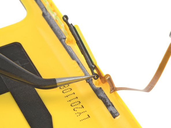

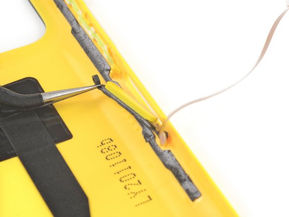

  15. Xiaomi Poco M3 Fingerprint Sensor Replacement, Remove the fingerprint sensor: Schritt 15, Bild 1 von 3 Xiaomi Poco M3 Fingerprint Sensor Replacement, Remove the fingerprint sensor: Schritt 15, Bild 2 von 3 Xiaomi Poco M3 Fingerprint Sensor Replacement, Remove the fingerprint sensor: Schritt 15, Bild 3 von 3
    • Use tweezers to lift the fingerprint sensor rubber gasket off of the bottom plastic pin.
    • Remove the fingerprint sensor.
